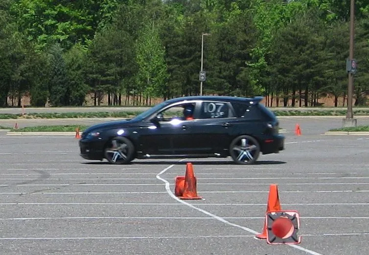

I think a few other MS3 owners on here currently or previously have done some AutoX racing, and so I was wondering what kind of suspension mods have been done and what type of results some AutoX drivers have seen.
Just completed my 2nd AutoX today, which happened to be on a pretty bumpy parking lot (1st race was on a smooth asphalt lake), and had some issues with the rear end bottoming out on my tires (currently running 245/40R18 R1's on 8x18 wheels) and cutting some grooves on the outside edge. I had a small issue with this problem at the last autocross, but nothing like this with the bumps in the lot. Already rolled the fenders some, but the stock springs in the rear are so soft it looks like more of a suspension issue anyways (already run DSP, so most mods are fair game).

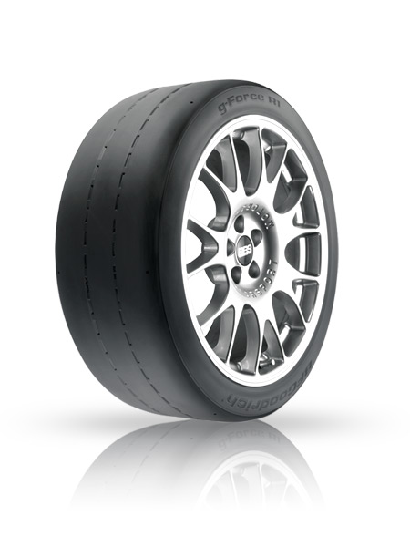

Wait a sec...you are running this tire?
If you had trouble with tire clearence at Knights Stadium you are going to hate Carowinds. I'm not sure springs are going to solve the issue. Even though aftermarket springs are usually stiffer, they will also lower you car which will cause more interference. A stiffer rear swaybar is probably a good place to start. Even if it doesn't solve the rubbing issue it will help the handling. With the size tire/rim setup you are running it's going to take a pretty big investment in either suspension or body work (or both) to get it to work properly.
Yeah I'm running on BFG R1's...long story short I work for Michelin and instead of blowing $1100 on a new set (and blowing all my incentive money for 5 years) I bought some used tires (~60% tread left) from a friend for $250 (+$400 for some cheap 8 x 18 rims). Only issue is they were 245/40R18 instead of the 225/40R18 size that I would probably buy. Thought I could make them fit...but I'm starting to find out otherwise.
