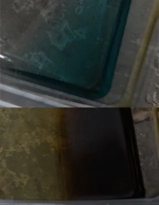

pulled the dipstick at 36,000 miles and the fluid on it looked good. But when I pumped out a couple quarts it looked worse:
attachment.php
New blue fluid vs old dark fluid.
It had been shifting down a bit hard when I'd step on the gas so we'll see if fresh fluid helps.
-update: drove about 90 miles today and it is back to where I really don't notice it shifting.
Another 50 miles today and it is still shifting much better than before the drain and fill.
So regardless of the 'lifetime fill' I'm going to be doing a drain and fill every 20,000 miles now as it is just too cheap of insurance against a major transmission problem. In cooler climates the fluid may last longer.

ATF color hardly means anything. If we had to change fluids based on their color that would be a real mess.
Agreed, not touching it. Changing fluids based on color, sniffing, tasting is very outdated.

The dark color reflects that the oil has reached temperature not that it is dirty. I bet if you pulled some more out now, you would see it is dark again.
I didn't mean to imply that it was dirty. ATF doesn't really get dirty like engine oil since it doesn't encounter blow-by or clean the sides of the cylinders. It gets wear metal in it but not contaminated like engine oil.
It more than reached operating temperature it was a bit cooked, which was obvious because the car shifted completely differently before and after the change. I didn't change the fluid for the fun of it I changed it due to problems with the shifting.

Sorry if I confused people by including a picture, that was just for fun. As I mentioned when I pulled the dipstick the fluid looked great. I went ahead and pumped it out, even though it looked fine, hoping new fluid would help with the shifts since they had degraded so much.
The changing of the fluid was in response to downshifts that would rattle the car, not in response to the color. Prior to the fluid change all of the shifts were more noticeable and when I'd go to pass someone on the freeway it would slam into the lower gear. Over 500 miles of freeway driving and plenty of full throttle passes and not a single slam since.

Color can be some-what of an indicator.
Transmission fluid/hydraulic fluid and gear oils tend to denigrate after becoming very heated, and after many thermal cycles.
Like already stated, the darker hue indicates it has been heated.
However, the fluid in the photo doesn't look terrible...
I'd still wager the factory fill would be sufficient until at least the century mark.
