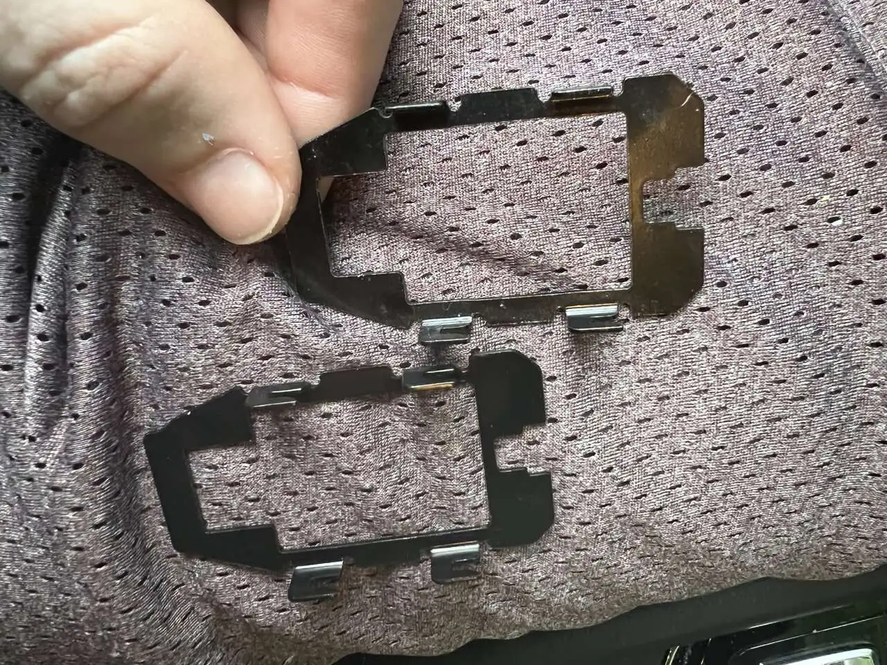

Turns out a bracket was present in the sensor. I’m guessing it was aftermarket along with the windshield and likely arrived adhered to the glass with three small hard epoxy pads. They were a pain to remove from the glass with a razor blade, but I was able to get them off without damaging the black material on the glass. The AliExpress bracket arrived today and when I went to check the fit, that’s when I found I overlooked the bracket in the sensor.

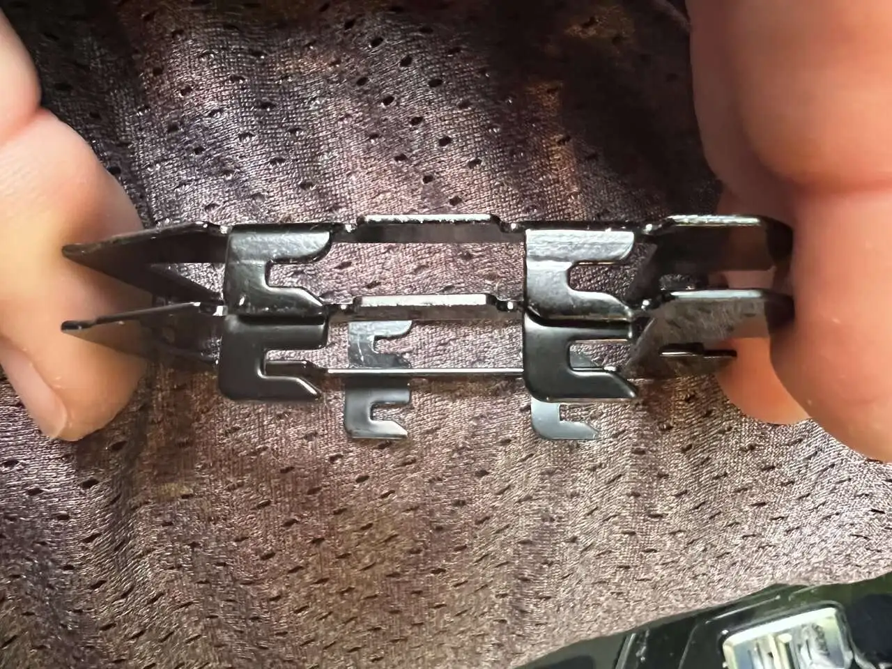

See pics of the AliExpress part vs the bracket I found in the sensor. The AliExpress bracket fit; however, it didn’t slide right in like the one I found in the sensor. I think it’s due to slight casting differences in the hooks. You’ll notice a slight bump on the AliExpress bracket hooks vs the one found in the sensor. It took a little persuasion to get it seated well before engaging the lock. I held onto the Ali part for a rainy day and proceeded with the old bracket.

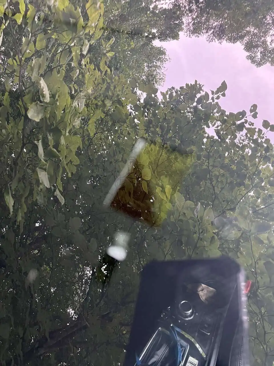

I glued the bracket on the windshield using VersaChems Rear Mirror kit. It stuck well following the directions to the letter, had to hold it in place for a minute before it took good hold. I lightly sanded the bracket beforehand to roughen the mating surface. I cleaned the glass well with alcohol and a glass wipe, had to clean the sensor with a lens wipe too. I replaced the gel pad with an OEM gel sheet and installed the sensor. Alas, it doesn’t appear that the bracket is applying even pressure across the entire sensor. Only the bottom half of the gel pad is in contact with the glass. I can press the sensor against the glass, and the gel pad slowly comes off from top to halfway down the sensor surface. Big ol air gap.
The consequence? The light sensor works, the rain sensor does not. The wipers will sit put with the sensor pressed against the windshield, but they start up and start wiping faster and faster as the sensor gel comes more and more out of contact with the glass. Tried my darndest to get a good pic but the camera is focusing on the reflection.
