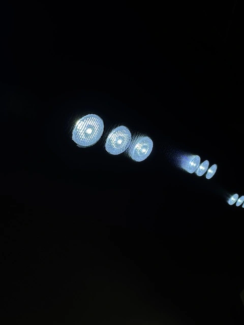

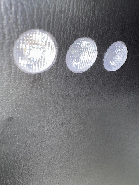

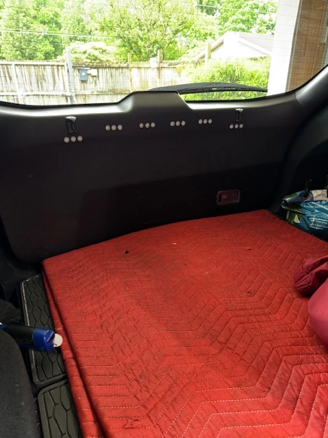

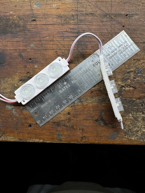

First, I think the ridiculously tiny light built into the inside of the rear hatch is pathetic. Shame on Mazda. Next, an optional easy to install kit would be great but if you cannot find one or choose not to go that route it is fairly easy to make your own rear lighting. Obtain LED lights of your choice (mine from Amazon) remove the rear plastic panels and drill holes as necessary and connect the supply wires to the 'switched' side of the original switch. Now all the wonderful light you can use that operates just like the factory single. Pics attached, will add on and off pics tonight to show the dif.

Eggsalad: If you are set on adding your lights to the side panels, you then have to decide how you want them to operate or when to come on and off. If you don't use the factory light switch you will obviously need to add a manual switch somewhere. I'm sure you already had planned for that. The factory wires to the little factory light run inside the headliner up top. This panel is easy to remove. Find the wires to the factory light with a diagram or a probe, then tie into those and fish them to your desired location. Hope this helps a little bit. For me, I wanted my additional lights to come on and off automatically when the deck lid was opened and could also be turned off as desired. Wiring into the factory light switch made this happen. If you want this sort of automation I suggest you wire into the factory light and run your wires up the inside of the hatch and fish them through the factory rubber gator flexible thing between the hatch and body and then to where ever you choose. Good luck and have fun.
