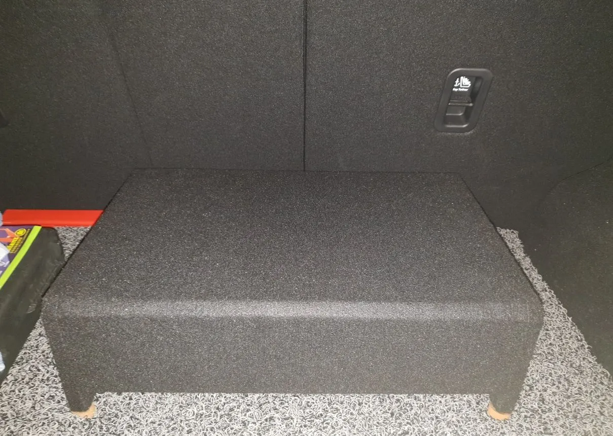

At this stage the audio was clearly better but lacked bass, so I bought a Kenwood KSC-SW11 under-seat subwoofer. I wired this to the speaker wires in the A-pillars, just before the high pass filter, and the power came direct from the fuse box (just 10A so no need to go to the battery).
This made an incredible difference and I was very happy with the results but noticed that there was still a massive peak in volume at around 150Hz and almost nothing at the frequencies just above and below that. Certain songs I was hearing often would have one very loud bass note in a melody, with other bass notes in the same melody almost inaudible. That really bugged me.

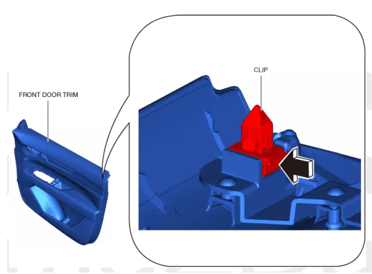

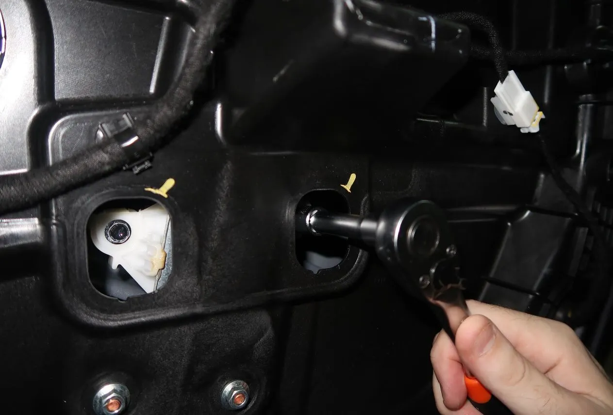

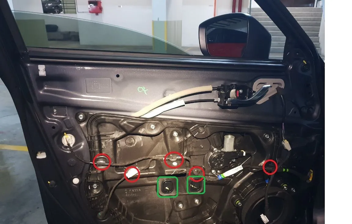

Having already removed the door panels, I was aware that there was another panel (the Front Door Module Panel) underneath. It made no sense to put sound damping on the plastic panel (even though I*ve seen some examples of that) so I needed to get that off.
Removing this inner panel is not easy and there are a lot of very awkward clips that need to be removed to free it from the cables. This took me forever on the first door, but when I did the second door, I unscrewed the panel before removing the wires attached to it. This allowed me to push out the clips from the back and was actually very easy.
attachment.php

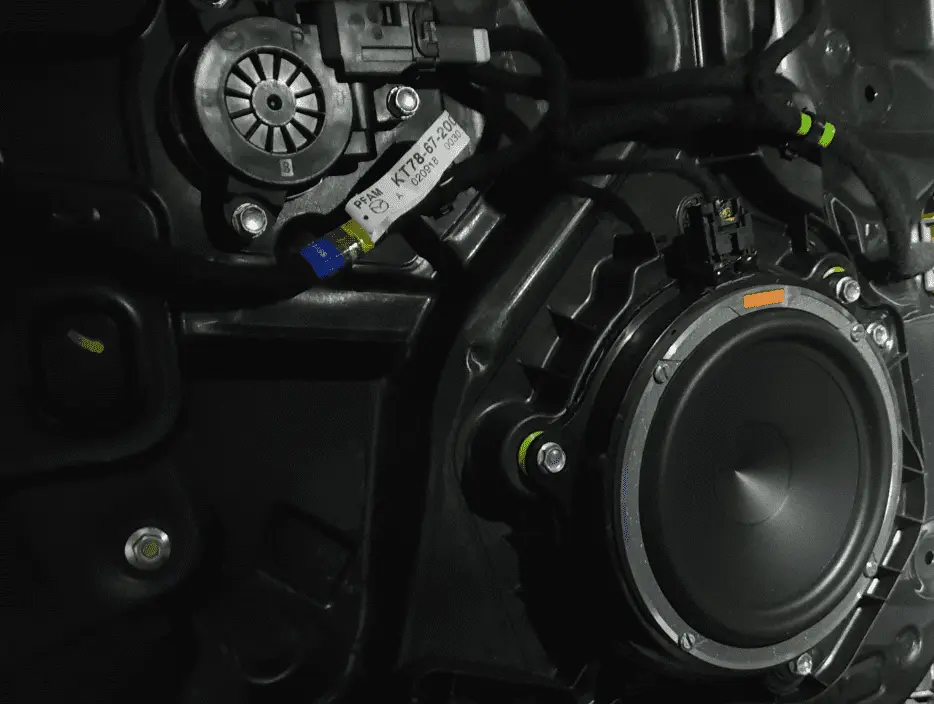

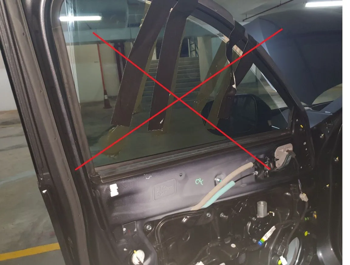

I was nervous about removing my window but had seen a video of a similar Mazda (possibly a Miata) and the window was taped in place (once unbolted) so that the inner panel could be removed. This didn't work for me, and I ended up having to remove the windows completely.
attachment.php
attachment.php

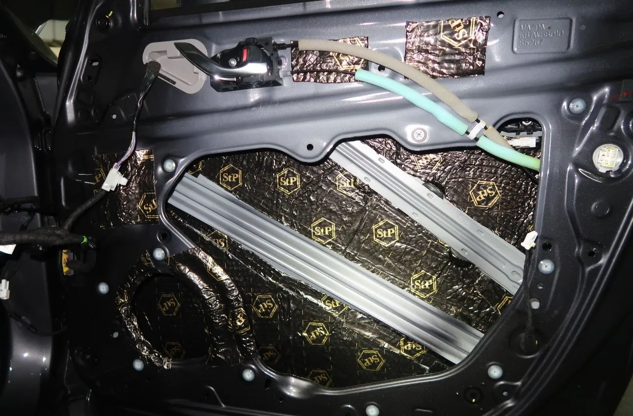

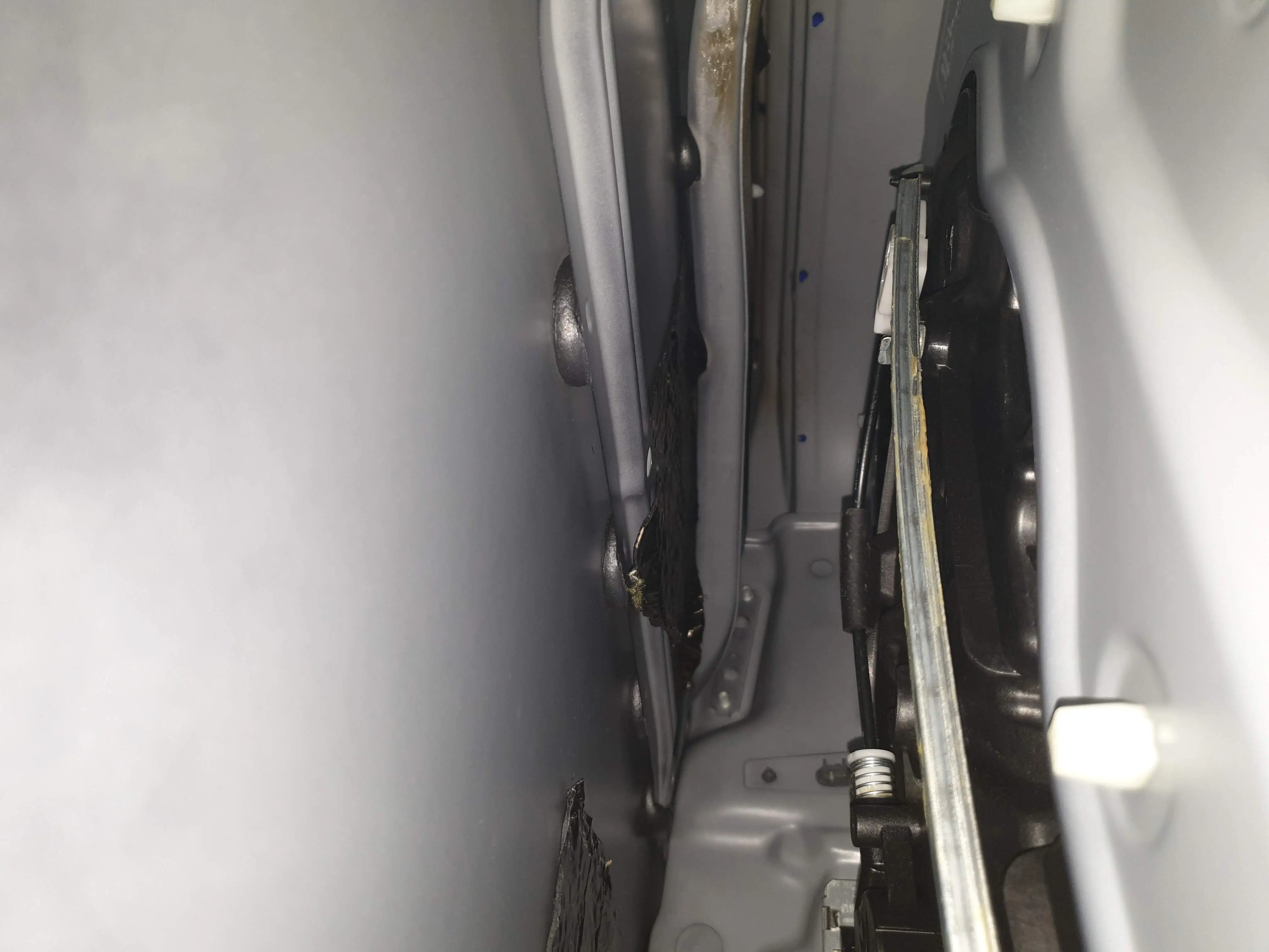

With the inner panel and window removed, it was easy to add damping to the outer door shell (and some on the inner shell). I managed the first door without cutting up my hands but had less luck on the second and wish I*d have worn gloves.
attachment.php
Putting the windows back proved tricky and although I thought I*d done it correctly, I later found out that my passenger side window was not properly slotted into the window guide and a couple of months later the window got partly stuck half way up. I believe part of the guide (on the rear-side of the window) was on the inside of the window and part of it on the outside. Through time, the point where the rubber crossed from one side to the other had moved and this had caused problems with the window. I had to remove the window again to get it to fit back nicely but there is now some minor cosmetic damage to the window guide/seal rubber.
The sound damping solved the issue with the peaking and made a big improvement to the sound in general so was well worth it though.

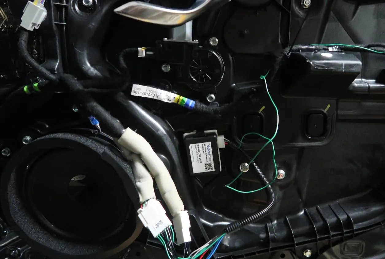

As an aside, while I had the driver's side door panel open, I also installed a module that opens and closes the door mirrors automatically (close on lock and open on ignition).
attachment.php
Not sure which versions (if any) have this as stock, but not having that functionality was very annoying for me, living in the city.
Did you have to replace the mirrors too?
No, the mirrors were motorised already but I had to use a switch on the door to open/close them. My previous car did it automatically so I could never get in the habit of closing/opening them manually. And the mirrors are so big I kept bumping into them myself when leaving parking spaces. This is great and works well with the auto-lock

Yeah, I was hesitant about using up trunk space and looked hard into fitting something into the spare tire well, but gave up in the end. The SW11 was great and made a bit difference but it would be hard to go back now.

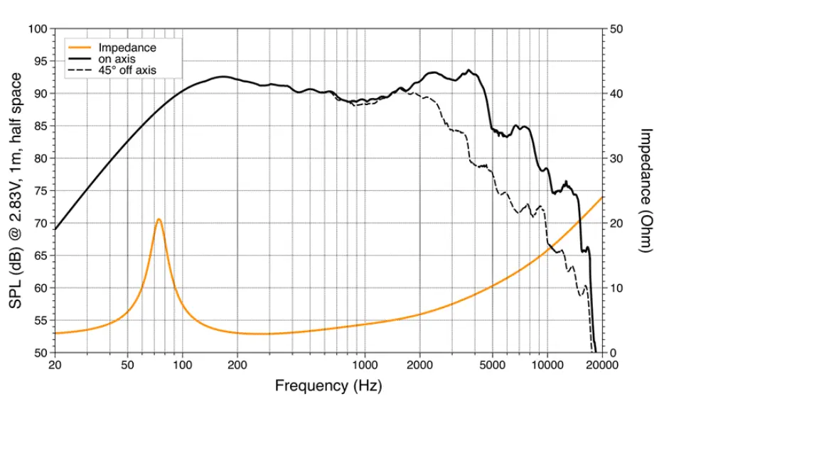

I did notice though that the volume with these 94db speakers is no higher than my old DSK 165.3 speakers that were rated at 92 db. Curious about that I looked more carefully at the frequency response curve and noticed that Hertz have quoted the peak sensitivity and not the average. It looks to me like the only frequency it hits 94db at is 3.5kHz, which also happens to be the crossover frequency. At 1kHz it is closer to 89db.

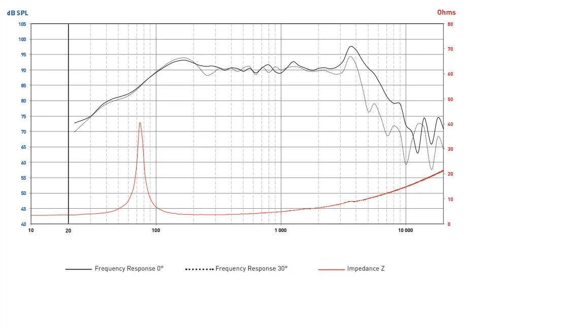

That surprised me so I had a look at the Focal*s you mentioned and they claim a sensitivity of 91.3db. From the frequency response chart they also peak at about 3.5kHz (but all the way up to 97db!). The claimed sensitivity here appears to be the average, which makes much more sense. Overall the response if flatter too, though this is hard to compare as the Hertz diagram shows 45 degrees off axis and the Focal one shows 30 degrees.
The Focals appears to drop down close to 3 ohms and also stays low for more of the range, so that also support the theory that there is no problem with the impedance.
Hertz Mille Pro MP165P.3:
Focal PS 165 FX:
As well as the sensitivity, Hertz also claim these speakers have a range starting at 45Hz, whereas the Focals state a range from 55Hz. I*m guessing that Focal calculate this as 9db below the sensitivity, but for the Hertz, 45Hz is a full 12db below the claimed sensitivity. In fact at 40-45Hz both speakers have the same sensitivity but for the Focals this is much closer to the claimed sensitivity.
I*m happy with the speakers but suddenly unhappy with the Hertz*s misrepresentation of the specifications and they lose a lot of respect for that.

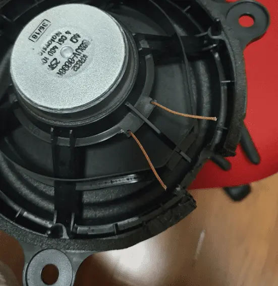

This time I took the plug from the original speakers. Dremeled it off and glued it to the bracket. In theory I should be able to glue it back when I sell the car.
Just one annoying hiccup. I had already partly broken one of the fastening clips and it fully broke this time. Gluing proved impossible so I have taped it on for now and everything seems secure. I want to find a replacement but this part seems impossible to find and doesn*t appear to have been used on the previous CX-5. Any suggestions on where I can find the part number?

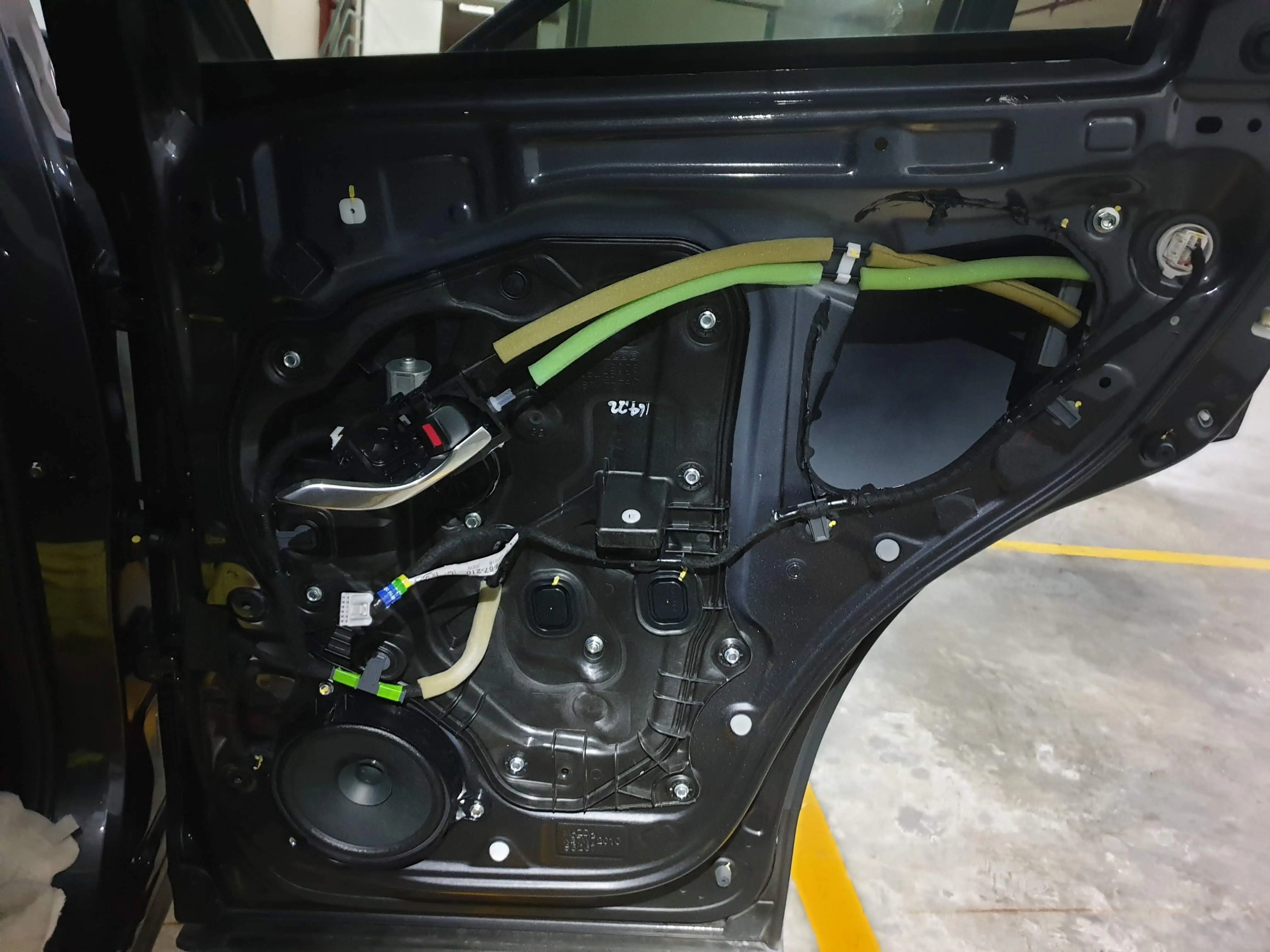

I have now replaced the rear speakers too and dampened the rear doors.
The rear doors are actually much easier to work with and there is a plastic access panel that can be removed, giving easy access to most of the outer skin. The only bits you can't reach from there, you can reach from the speaker opening.
I used smaller pieces and it is less tidy than it would have been if the door panel was removed, but it was nice not having to remove the windows and I was able to cover the entire outer skin without any problems.
I didn't take any nice photos as I was against the clock, but overall I was happy with the results. The doors sound much less cheap now, though they still don't close without a bit of extra force. I think they need a considerable amount of extra weight adding to make them close properly - more than can be added with dampening materials. It's a bit of an annoyance as our other car is much higher quality and I often end up embarrassed after loudly slamming the doors on that car.
Sound-wise there is definitely an improvement and I've been trying various settings to get the right fill without disturbing the stage too much. There are no filters on these speakers but they seem to naturally roll off at a lower frequency than the original speakers (the passive crossover that comes with these Hertz components is actually only a high pass filter for the tweeter and it passes a full signal to the woofers).
