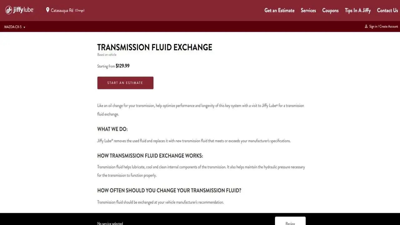

Funny, I went to the local Jiffy lube to see what a transmission "flush" costs, starts at $129. Wonder how they can do that? I put in my Mazda information.
