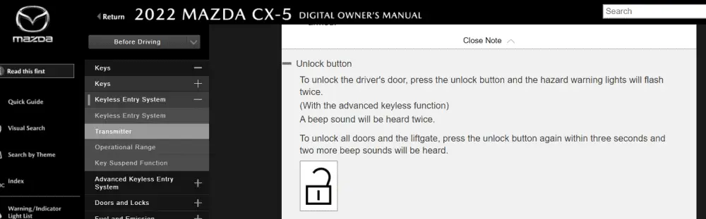

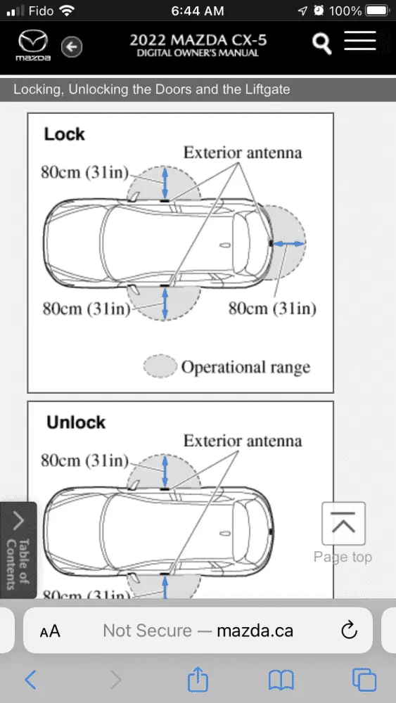

I have no idea what you're talking about, you STILL have to press the unlock button to unlock the car, even on 2022's!!!!
Here's the part of the Owner's Manual that tells you that!

Dude you're not getting it. The fob being near the door allows it to be opened by pressing the button on the car's entry handle, not on the fob itself. So by tricking the car into thinking the fob is directly in front of the door that will allow entry into the car, and also allow the keyless ignition to start the car. The buttons on the fob itself are just a backup way to unlock the car.
With a Mazda that has a "touchless" fob you press the button at the door handle to lock or unlock., not buttons on the fob. That's what you appear to be quoting. The idea is that don't have to fish the fob out of your pocket or purse to lock or unlock, a minor convenience feature.
I can understand the confusion if you've not driven a car with this type of system which predominates in new cars with some variations and is on the way to becoming universal. Again, work through the illustration in post #25 keeping in mind that fob car is issuing a constant signal to the car, waiting for it to be in range to allow the door to be unlocked, with thieves pirating the "call and response" signals.
Now, there's lock and unlock buttons on the side of the Mazda "touchless" fob where you can use it like the older style fob systems like the one you pictured. But that's neither here nor there--it defeats the convenience factor and it has nothing to do with the thievery techniques that are the subject of this thread.
