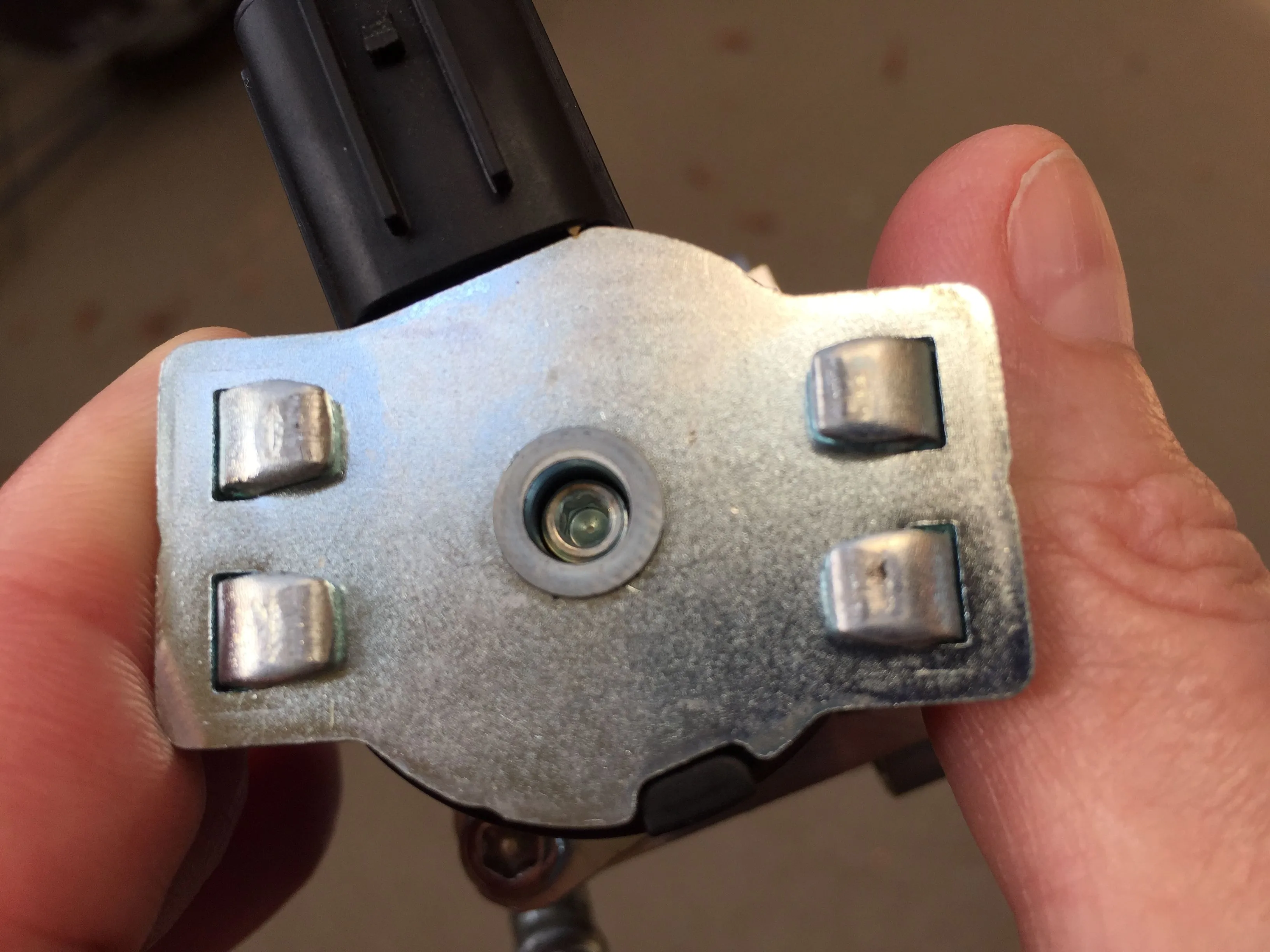

Got mechanic to fit all and asked him to clean throttle body during swap. Huge difference as idle stable and shaking/juddering gone. However on cold start it idles at just over 2000 rpm before gradually dropping to 700 in a few minutes. Mechanic suggested part faulty but he thought maybe could try adjusting it but I don't believe that part is adjustable? Can anyone confirm this (see photo for where he thinks is adjustable)? Company I bought part from says is not and agree to replace new one if I am sure it's faulty. Very reasonable of them.

That's normal, it's programmed to do that in order to heat up the 02 sensors, catalyst, etc. in less time.
It may take some getting used to, but it's nothing to worry about. And no, it isn't adjustable.

Thank you! So I ask myself why did technician 1) Not know that was normal & 2) suggest it was adjustable. He was just recommended to me & now I'm not so sure.

He probably wants to adjust the idle screw on the throttle body which SHOULD NOT BE ADJUSTED. You could have a dirty EGR causing the idle issues or the car could need new spark plugs, coils and wires.
