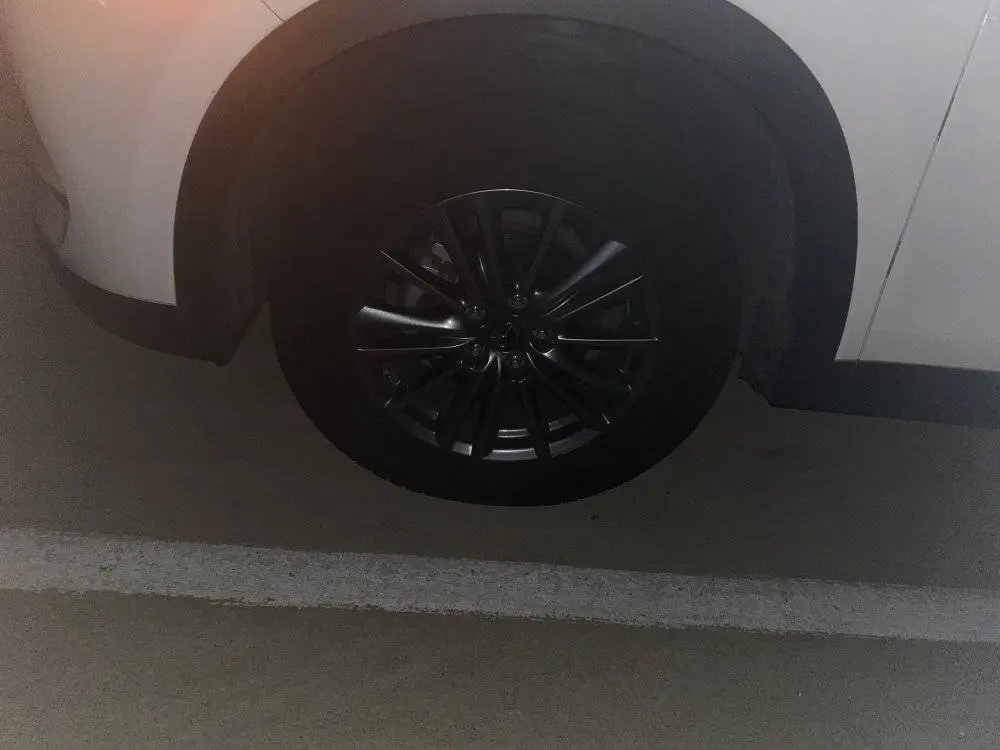

Anyone take the finish off Factory Wheels?
I would like to get them chromed or just take the finish off. Thoughts please, thanks.
The finish is just paint I believe. You can have the wheels sandblasted and refinished in a different colour, or further prepped to be chrome-dipped after being sandblasted. But if you're going to go through all that trouble, it may be cheaper/easier to just buy a new set of wheels.

If you really want to do this, Aircraft Remover will take the paint right off, no problem. Then you can polish them, make them shine.
Thanks sounds like the best option as someone stated chrome would add weight and added weight means reduced gas mileage 👍🏾

Thanks I watched a couple of YouTube vids using the aircraft remover pretty simple. I have looked at custom rims and the one place had I believe only 18’s and 19’s.
Got a quote of 900 to get my wheels chromed. I want to stick with my factory 17’s as it’s better for mileage also it would be quite unique being one of the few Mazda’s with tricked out factory wheels.

I’m going to see how the Airplane remover works if the wheel look good without anything else being done hey it’s LA we trick our cars out a little 👍🏾
After you strip the paint, get a Dremel with some polishing wheels and some rouge. After some work, they'll shine like you can't believe.
