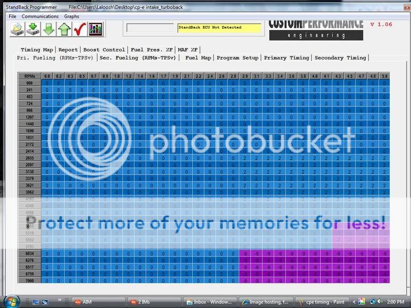

So ok its 26 degrees outside, my car only stutters when its cold. i went to datalog some runs. Sure enough 4k rpm begins to stutter and doesnt slow down till 6k. ok i got that on file. next i go to the extreme and add 8 percent of fuel after 3k rpm till redline. i get on it, 4k rpm BOOOOOM it felt like some1 slammed the brakes hard. my friend was following me and called me instantly saying that i might have lost my bumper in the fireball i shot out. So i try it again, same exact result. VIOLENT boost/fuel cut. So im like ok this makes ZERO sense, so i lean the car out -2 after 4k rpm. i have NEVER felt this car pull harder in my life. now im going to list all the things that make ZERO SENSE.

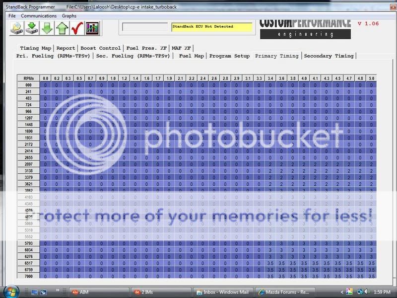

did u messs with any timing?
1.9 and right 2655-3621 i added 3 percent.
1.9 and right 3862-redline i subtracted 2

no timing changes.
Cpe sent me a map for I/tbe and he was taking away as much at 9 percent of fuel up top and adding a lil where i added. He was also increasing timing by 3 degrees up top. Seemed dangerous to me so i didnt even use it.

is there anyway u can post the map that sent cp-e, just so i can do some comparing
