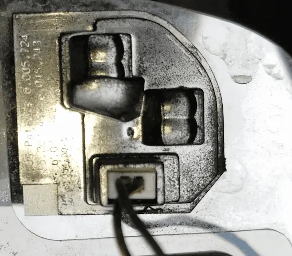

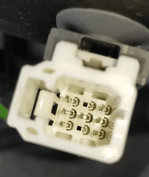

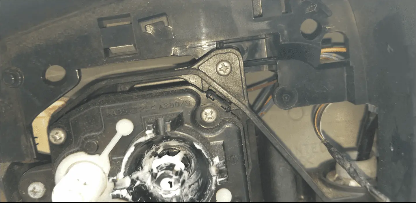

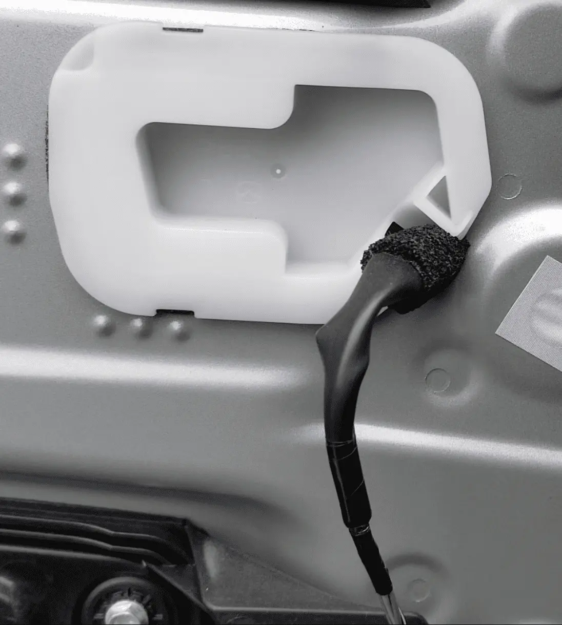

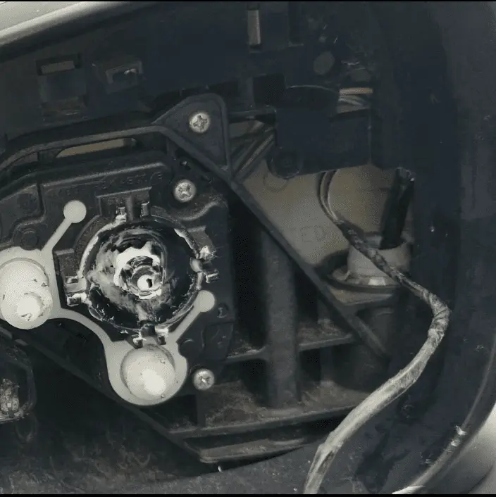

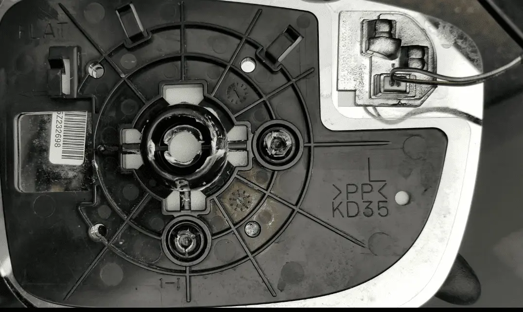

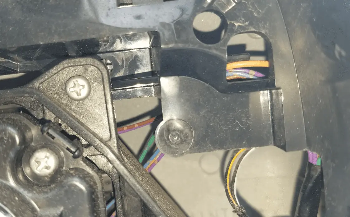

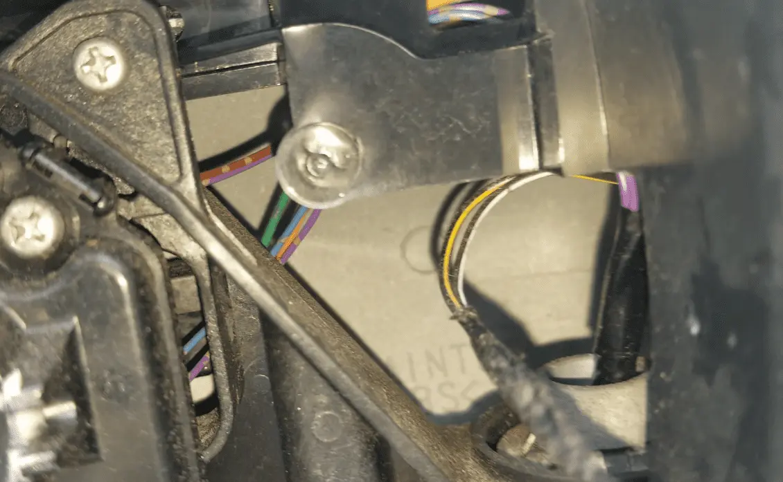

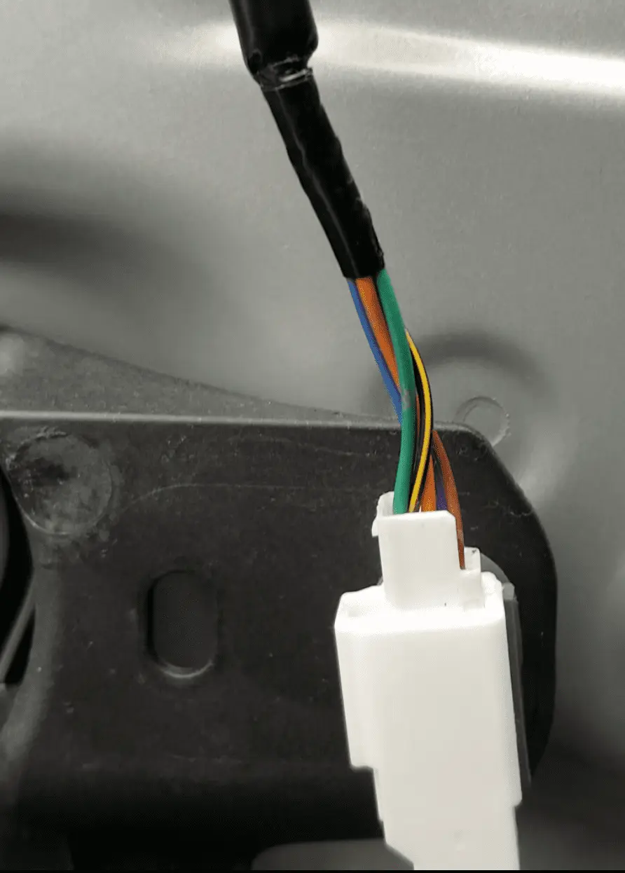

Okay, so I decided to take apart my CX-5 today, especially the front door trims and also the the mirror glass. Based on what I found, I don't think that the door is pre-wired for heated mirrors and it looks like the wiring harness that leads from the engine area to the door is something that would need to be replaced completely in order for heated mirrors to even take place. Take a look at the pics and let me know what you guys think:
Mirror housing wiring:
Wiring
Pins:
Back of mirror (Blindspot monitoring with no heat):
Two pin connector:
Inside the mirror housing assembly:
Wiring
Pins:
Two pin connector:

I actually ended up not doing anything with it since it seems more complex than I had originally anticipated. There doesn't appear to be any wiring for the heated mirrors that leads into the door itself.

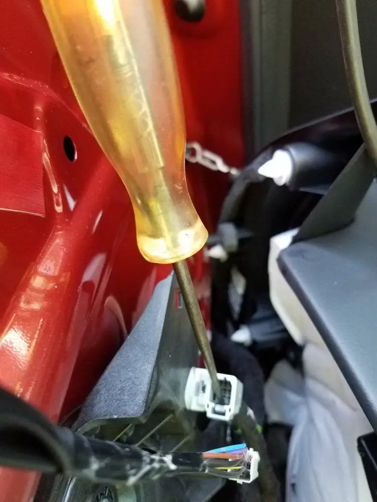

Ok, I have confirmed that the wires are indeed there on my 2018 Touring.
This shows my test light detecting that the rear defrost button was turned on.

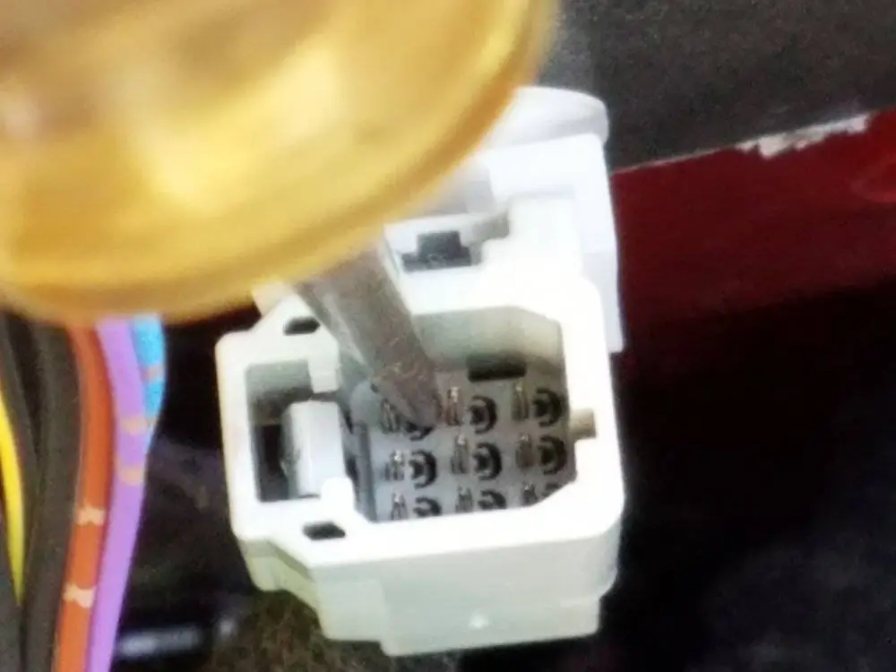

This image shows the exact pin I am testing on the 2018. I did not strip the wires underneath yet to determine the wire color, but you should be able to figure it out from this image.
Awesome, thanks! So now the question is do all the mirrors have the same wiring plug? Thoughts on ordering heated mirrors to plug and play? I'll also pull the door panel and check my plug with a test light to see if it goes hot with rear defrost. All good info! Thanks for doing this.
The image of the plug in my old 2014 in my 'how to' thread looks the same, but honestly it is a really bad image.

I confirmed my blue/red wire at that same pin location is hot with the rear defrost circuit. Going to order heated mirrors and give it a try. I'll keep you posted!
