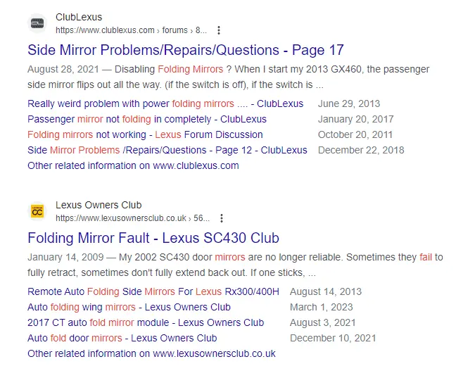

You can show us a single TSB on power-folding mirrors issued by Lexus to convince us since you claimed many Lexus owners having problems with their auto-folding mirrors also.
yrwei,
TSBs are not real scientific data. Maybe Mazda issues TSBs more frequently to their dealers.
A simple google search below.
I don't have solid data either.
