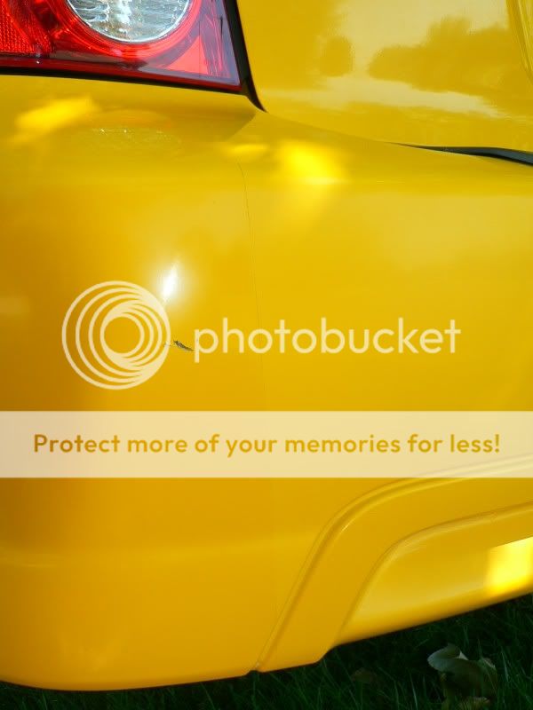

I should also mention that I'm way green at using polishing compound and really detailing all together. A dime size mark on the rear bumper showed me what too much buffer wheel can do to plastic if left on too long.

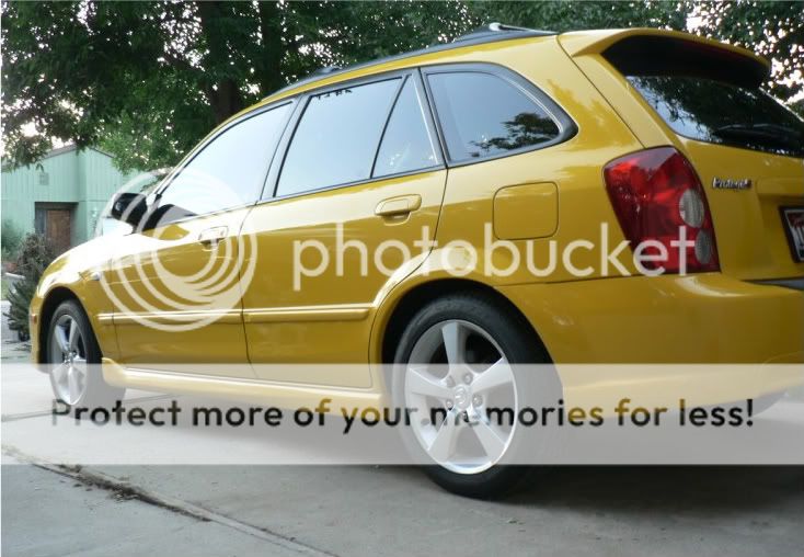

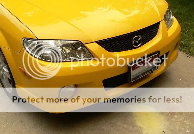

notice the yellow stain on the driveway... and the front bumper still isn't shiny but at least its not pastel.

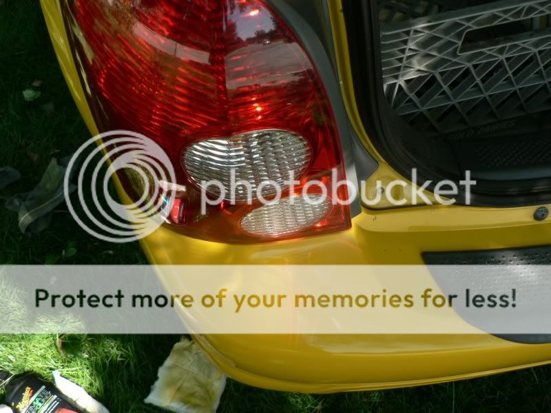

A little update. My car looked like poo again since last fall when I polished it. Looks like its just going to take good discipline to keep this car shiny. However, I did find an excellent product for restoring the shine better and faster. Its mequiars Ultimate Compound, works waaaay better than polishing compound. I took some pictures that I'll post when I get them uploaded.
Ok, so.... Whatever technique was used, it's crazy delicate. Both of my bumpers are dull and so are a few other spots on the car. I'm the third owner, so who knows how well it was cared for. I was planning on claybaring it, but now I'm wondering if it's gonna make it worse. I'm interested to see how the mequires compound works.

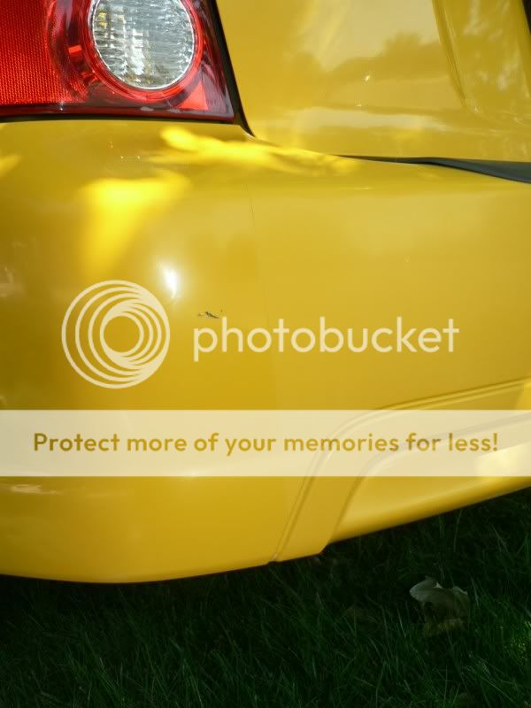

Finally uploaded the pics. See the captions above each one.

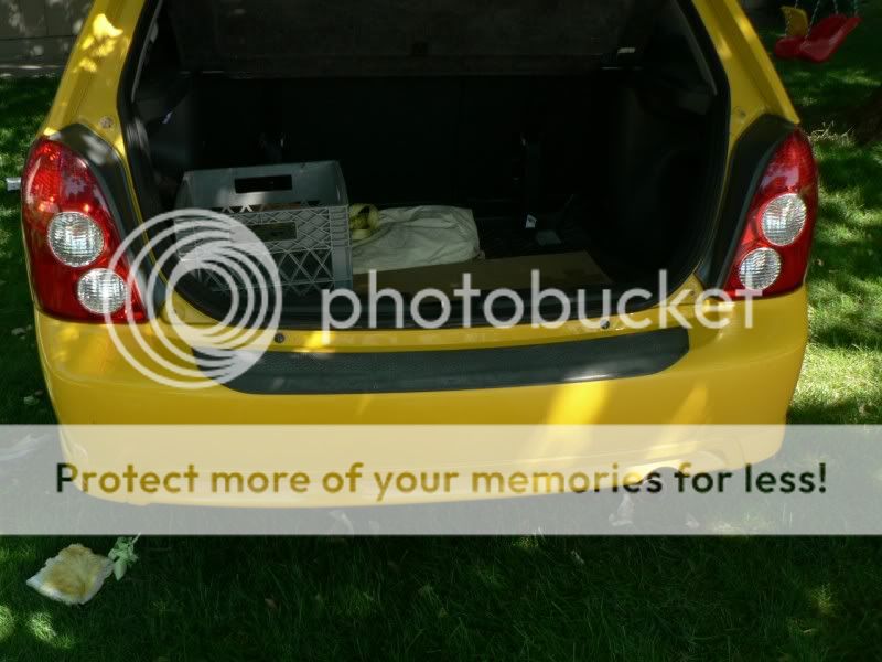

First pic, There is a tape line, if you look at it from different angles you can see it.
less color makes it easier to see the line. The shiny side was just one application of the ultimate compound.
A wider view of the same above picture, left side polished, right not.

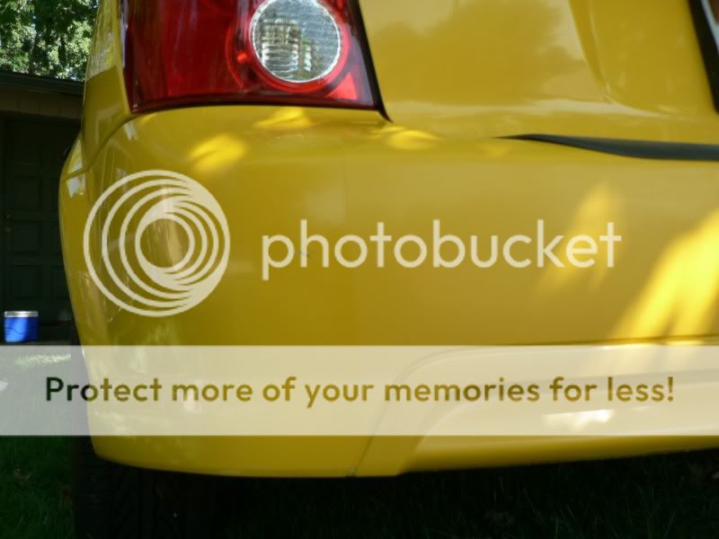

Look at the difference between the right and left side. Picture doesn't show it as well as it looked, HUGE difference.

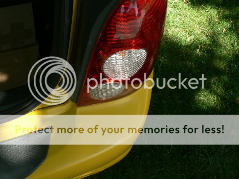

The next two are the left and right side below the tail lights, notice the difference in reflection of the tail lense.

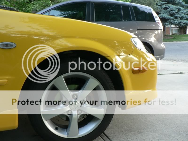

Last pics of the waxed finished product. I've put another coat on since and it looks so shiny and new its amazing. I've become a real fan of single stage paints since they just keep getting better the more work you do.
