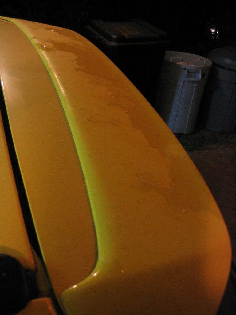

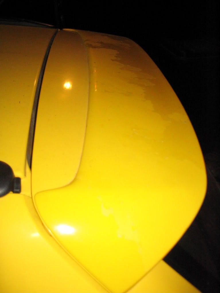

Do you have an issues with peeling? The only paint that is peeling on my car is the rear spoiler. Ive been meaning to remove it and get it painted. A local shop wants $100 to paint it. I am thinking about doing it myself, maybe black. What would be a good type of paint to use?
I don't have anything peeling, mostly paint bubbling in places. Do you have pics of your paint peeling? You sure your rear spoiler wasn't repainted at some point in time? Does the paint look the same, texture-wise as your roof?
If you were to repaint the rear spoiler, I'd go with the same single-stage paint that's on the car.
Here is a picture of when it started back in Feb 2007. Its about 10x worse now. I will take a picture of it when my wife gets home. Will post it later. Ive had the car since Dec 2001, so that is the original paint and spoiler.

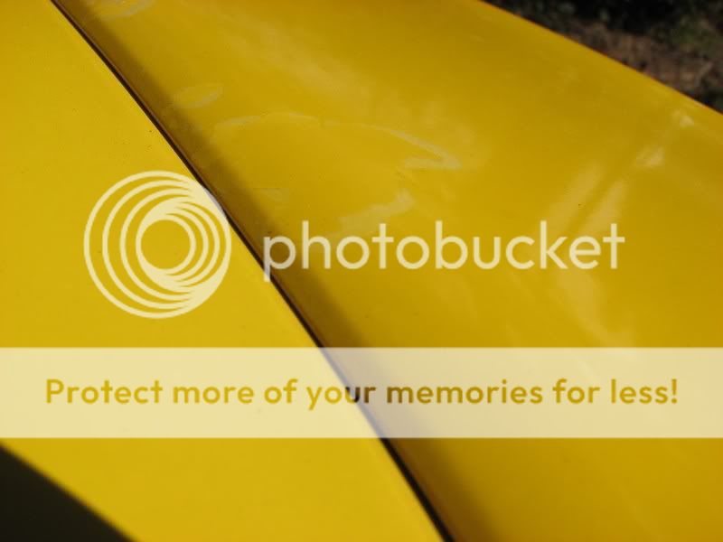

I know that none of them help your peeling paint! But if people are bummed about the faded paint bumpers, a lot of the time it's merely oxidation (a dead layer of the paint on top). This can often be buffed out and not necessitate any repaints.
If one is considering dropping the dough for a repaint, one should consider trying some oxidation removal with a machine polisher first.
In short, before/after:
Left side "after", right side "before" (look around the keyhole):
Now all is "after" (compare around the same keyhole):
See my thread for more pics and info.
