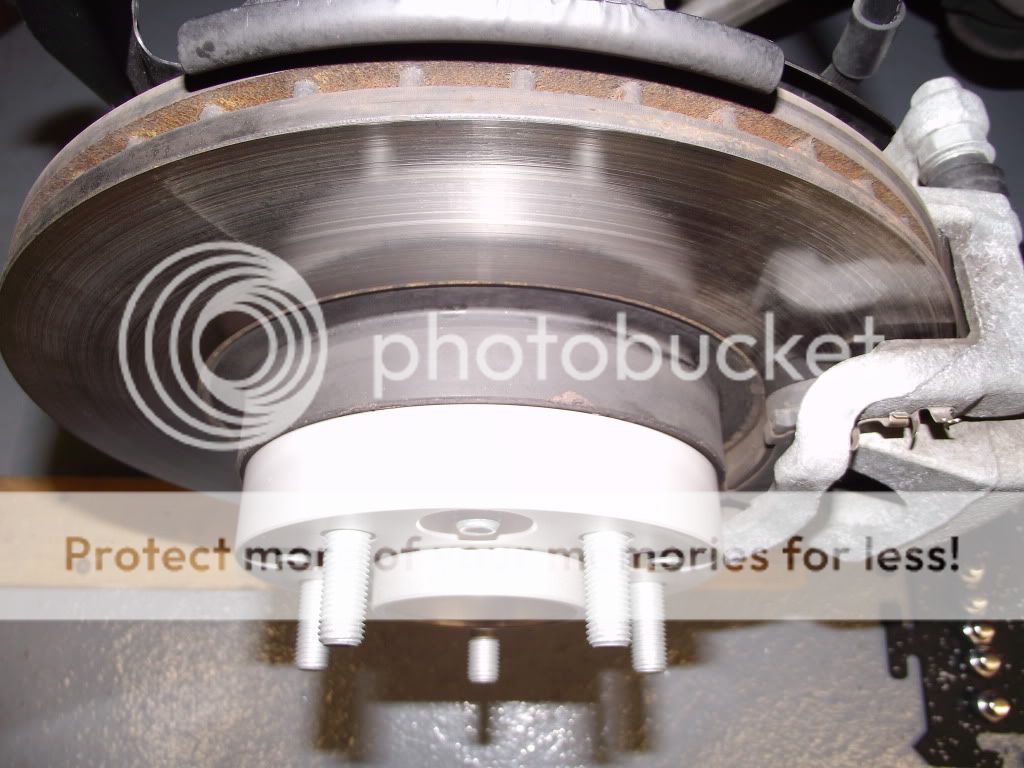

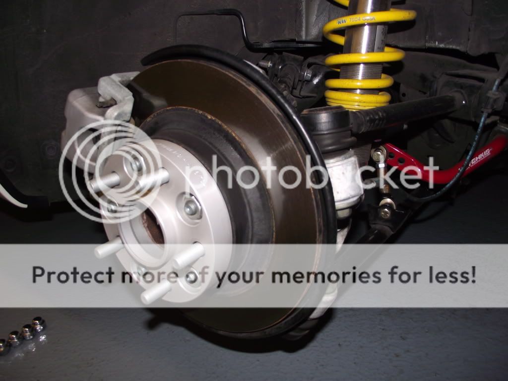

Does anyone have a picture of a 25mm spacer on their pro5? If so, please post. I tried to google it but nothing came up. I want to see the clearance and how much the stock stud sticks out. Thank you so much
Here is a post where he ran 25mm spacers on STI wheels.
http://www.mazdas247.com/forum/show...hread-CLOSED&p=5271535&viewfull=1#post5271535
Should be very close to this if not the same. Bellow is a Miata though but you see that 25mm is a lot of spacer. Yours should stick out just the same so running the STI wheels should be ok.
I
Haven't see the back of the sti wheels. But make sure they have the little dimples in the back bacause the stock studs stick out about a millimeter or two. If the back is flat then the rim will not sit flush. Easy fix though. For mazda3 rims I just drilled small indents so the stock bolts fit into the back of the rim.
