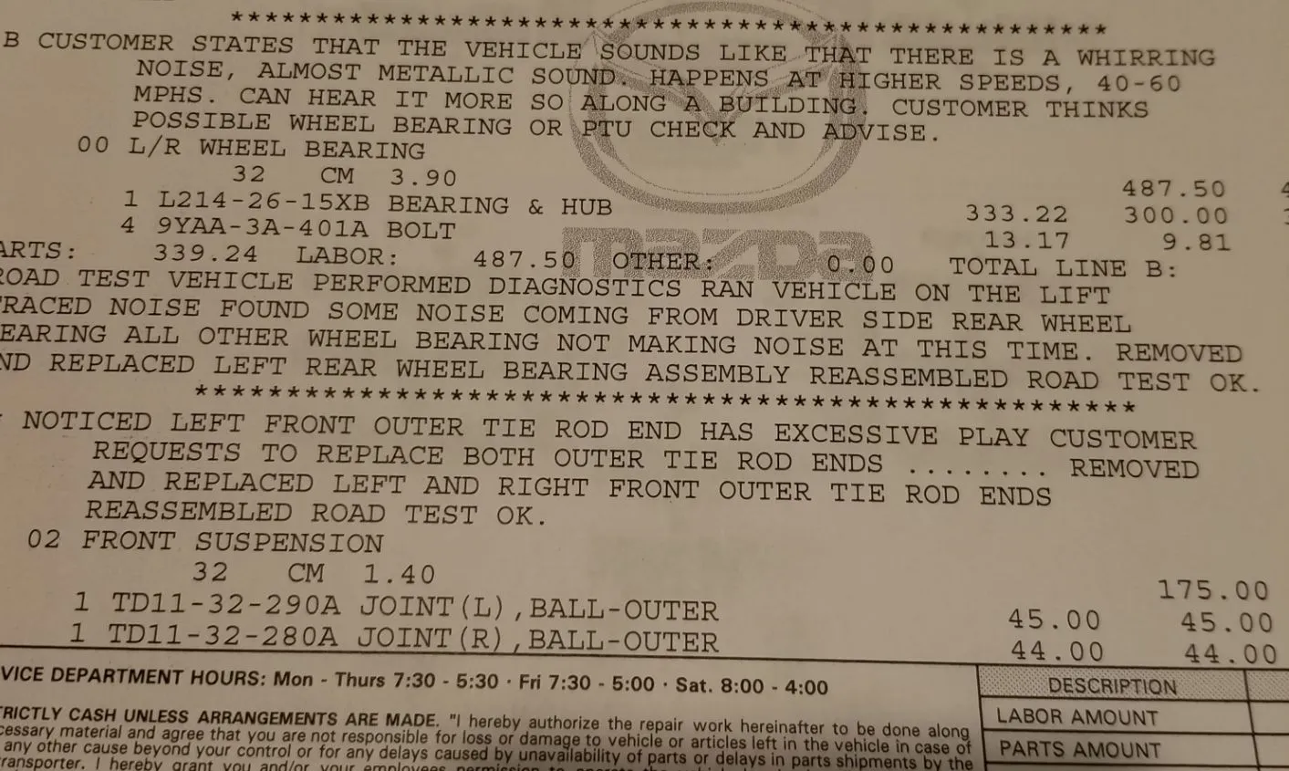

The OEM part wheel hub lists for about $300. That dealer is really overcharging you, even at dealer part and labor rates.

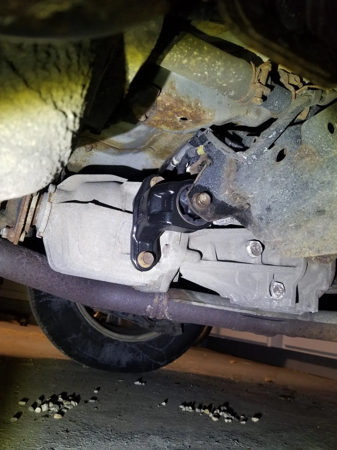

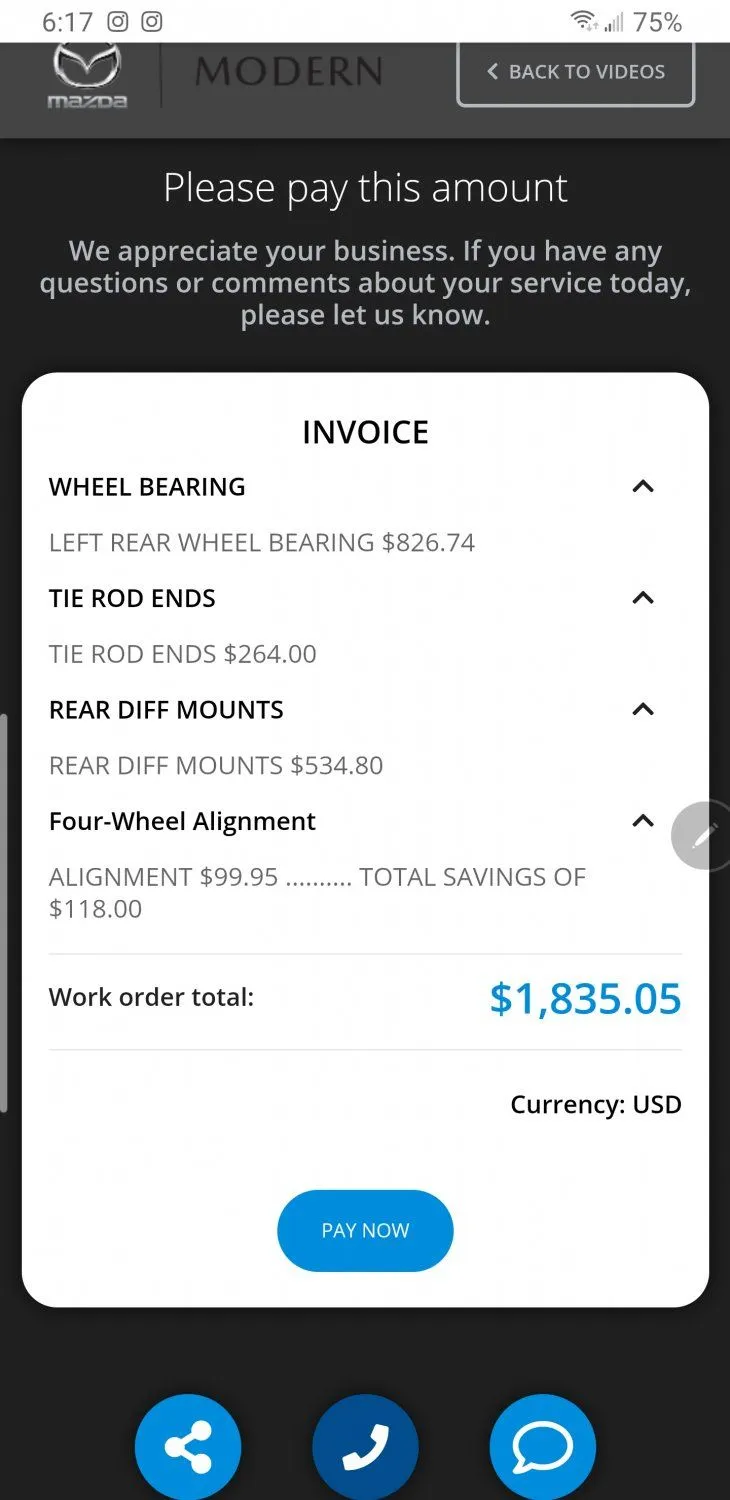

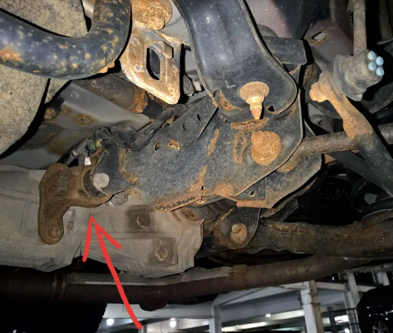

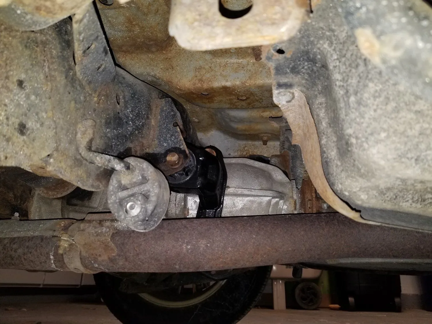

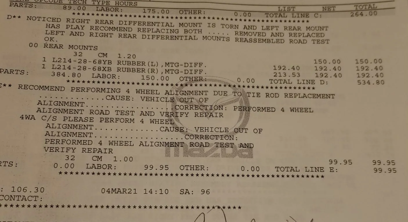

Just picked it up, feels more solid with a bit less clunking from the driveline, and decided to do both L and R outer tie rods as well. They recommended left side only.
You're right, they did charge the oem dealer rate of $300 and the labor rate is $125/hr. = about 4 hours! an expensive repair for sure.
