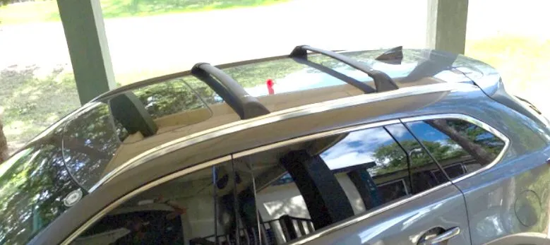

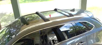

Mine are the fixed ones, no rails unfortunately. So options are to remove them altogether, leave them as they are, or relocate them to another hole, if another exists under the plastic strip. But they are the genuine Mazda part and I've read the installation instructions and it reads like they've done it right, but there are no decent pictures to confirm. The photos above (jgriffter and pholway), whilst on rails look like the positioning I would expect, another foot or so aft of where mine are.

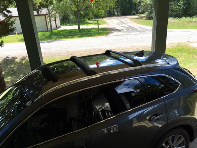

I posted the pictures of mine. I have the Signature and the rails were already installed. I just had to order the cross bars.
There was only one spot to install the cross bars (as pictured). I didn't notice whether they are adjustable in the roof rails - sliding fore or aft. I assumed they were fixed position.
I have not noticed any whistling with the cross bars even at highway speeds. The cross bars are aerodynamically shaped so perhaps that helps.
