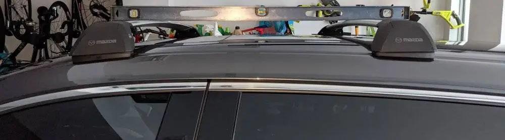

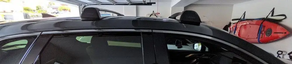

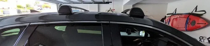

Hijacking thread with a related question. I just had the oem bars installed however they seem installed too far forward and the bars aren't level.
Would someone else with them installed mind posting a pic just to show their positioning on the roof?
Dealer is hopeless and don't want to rely on them saying it's expected.
Thanks a lot wabbit! Indeed RH market. The OEM bars are rebranded whispbar/yakima but your video shows the mount points are the same position. Bizarre why Mazda has them so far to the front of the car.
