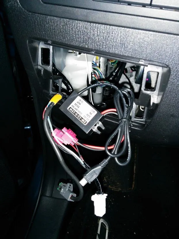

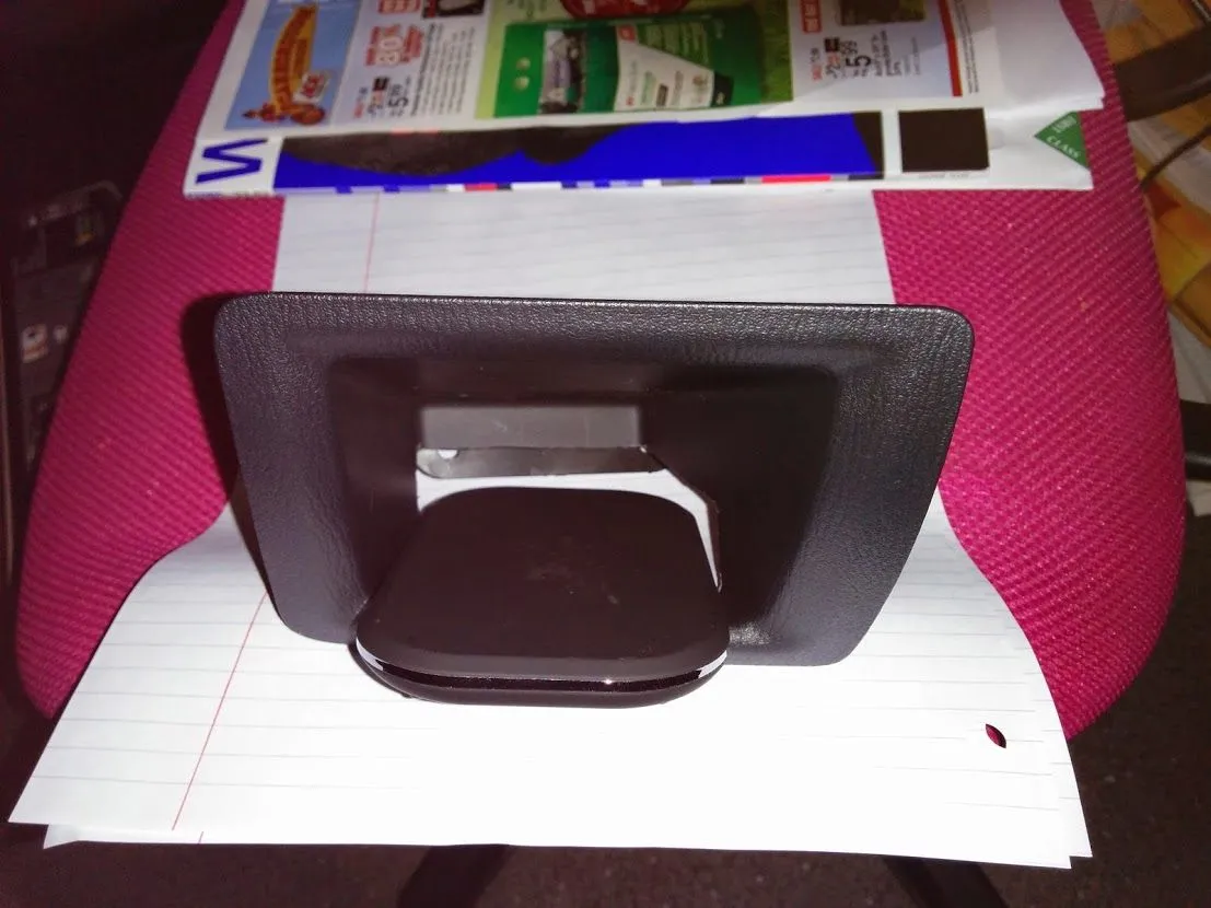

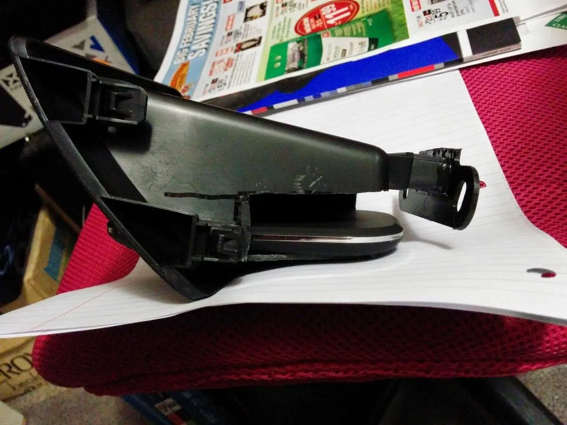

I built a Qi charger into the small pocket to the left of the steering column. I don't have navigation so I have a fairly useless pocket instead. I thought it would make a handy Qi charger. Looking at the wiring diagram there was switched 12V available on the connector that would normally go to the nav unit so it was easy to splice in a 12V micro USB adapter to power the Qi unit. The pocket is easily removed by pushing from the back and pulling from the front at the same time. Then I cut out a slot so the Qi charger and phone would fit. There is a metal frame piece to the rear left of the pocket that will limit the depth of the Qi charger. I attached a small piece of plastic to keep the phone from going too deep into the pocket. Works great and keeps the phone near the window for better reception. The screen is mostly not visible but I don't need to look at it in the car. The pocket is sloped slightly which helps keep the phone in place. No issues with the phone falling out.
