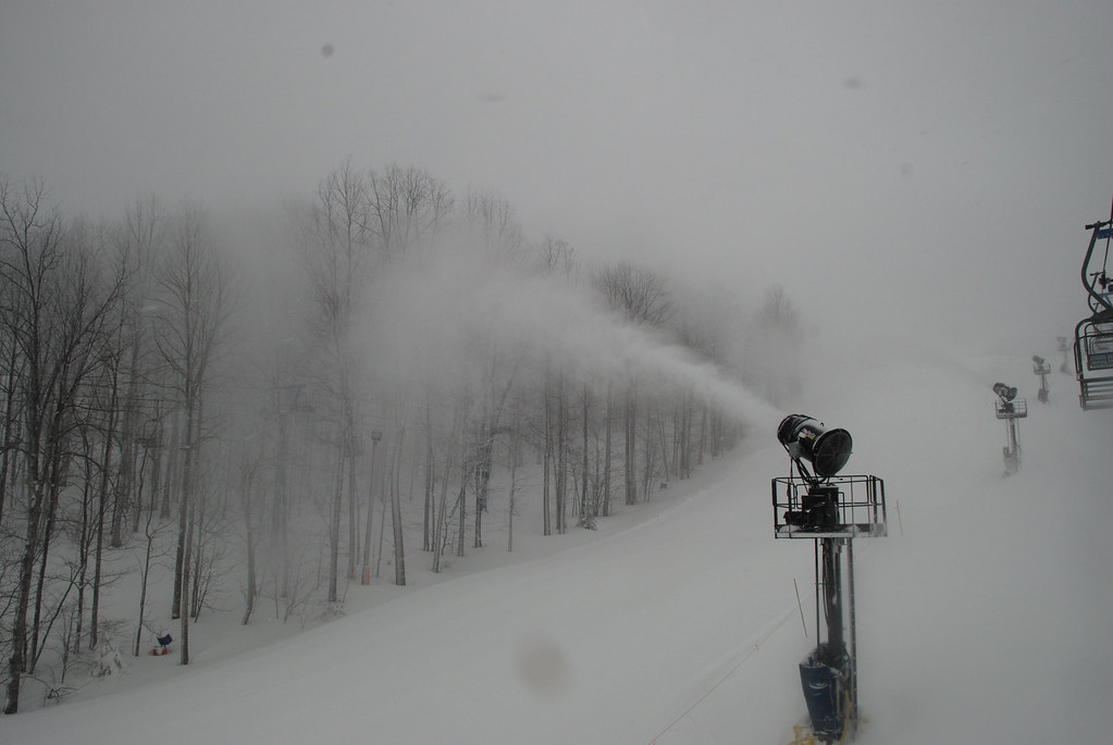

Its either dust on the sensor or its dust inside the actual lens.
I actually have dust in my lens so its pretty much impossible to get away from that.
Some camera shops offer a image sensor cleaning service. I got mine done for $35 and it took 4 days. I highly discourage you from trying to do it yourself!!
it's dust on the sensor. It would take a pretty large object on the lens to show up on the image. You can crack the outer lens element and not have the crack show up in the image, so literally the dust spot would have to be about the size of a rabbit turd to show up.
Well I got my sensor cleaned and the spots were still there, so I guess the dust is in the rear elements of the lens. They are only noticeable in very bright conditions or long day exposures.
Obviously I need to get it done again.
What about your focusing screen right under the viewfinder?
The dust probably just got pushed around (poor cleaning job).
The way to test if it's on the sensor is to take a photo at f4.0, then 8.0, then 11, then 18, etc. If the spot doesn't show at larger apertures, then it's on the sensor.
When I clean my sensor it can take 3-4 times before it's completely clean. My first pass is with a brush, then I use a liquid solution with a pec pad 2-3 more times. Usually what happens is the last few specs get pushed around but they eventually get removed.
yeah I rarely get it on the first time as well
I usually just take the lens off and shoot at f22 into the sky then pixel peep on the screen and you can if its clean or not quickly
