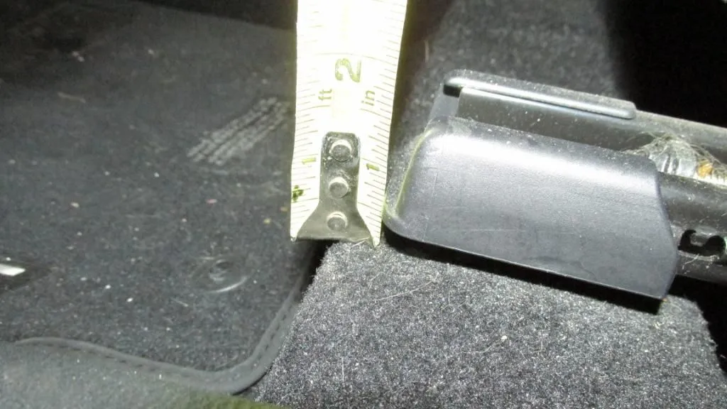

It's amazing how the same subjects keep coming up on this forum. This topic was covered years ago when the CX-5 first came out. A lot of people (including myself!) were caught off guard as to just how important those "extra 2" seat adjustments actually are going from the Touring to the Grand Touring. Anyway, my solution was to shim up the front of the driver's seat track about 3/4" (as best I can recall) and install a longer bolt to accommodate the extra height created by the washers I used. It helped; didn't solve it completely.

I looked under my seat and it looks like each side of the front of the seat is bolted into the track with 2 funny looking bolts that look totally flat to me. I guess those are the torx head bolts? I should probably take a picture and upload it.
I googled around on your idea and found a thread where someone did something similar with a Nissan and used nylon spaces (they look like fat plastic washers). I may give this a go. If I do I may PM you if you don't mind.

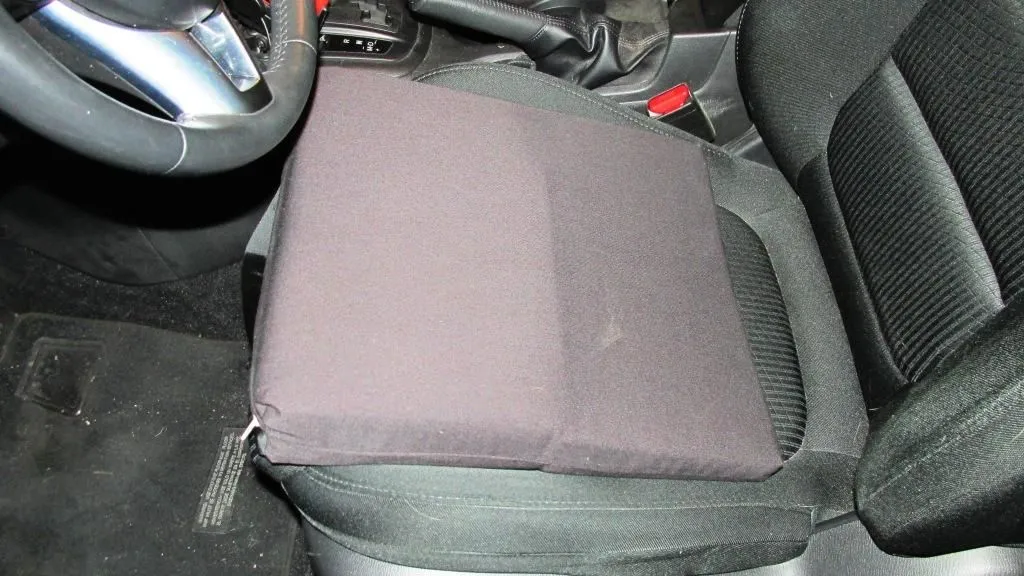

I'm also thinking of just custom cutting a foam wedge and then putting a seat cover on it. I think I need a seat cover anyways as I can really trash a drivers seat.
So as you can see in the first pic, it looks like I got about 5/8" lift at the front of the seat track with the washers and longer bolt. I gave up trying to find another torx head bolt and just used the highest spec hex head I could find.

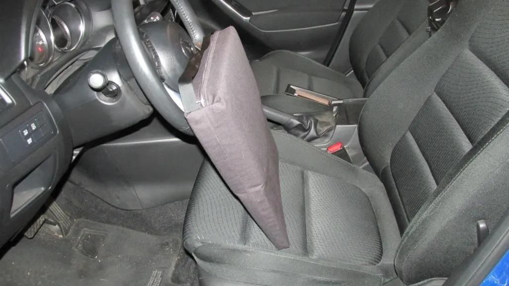

The other two pix are of a wedge cushion I use occasionally when my sciatica flares up. I use it with the thick part at the rear, but you could reverse it as I have done in one photo to give you a little more thigh boost. It's a bit lumpy looking because I modified the foam inside to better suit my needs, but they from a local foam shop (see upper left of linked page) as one nicely cut wedge and they sell the nice black cover too. The shape fits well within the bolsters of the CX-5's seat. http://www.foam-futon.com/comfort.html
