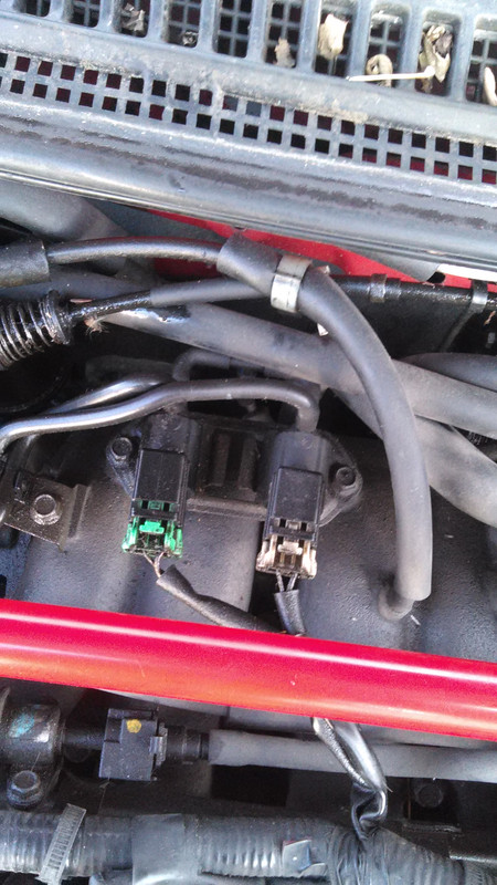

These are the VICS and VTCS solenoid valves.
I'd start with the VTCS solenoid valve,.. they have been known to fail.
If the VTCS valve is malfunctioning, it could lead to stumbling of the engine and most of the symptoms you've described.

I'm not 100% sure but I think it refers to the VICS, the green plug, which looks like it's working okay but I guess it's what's on the inside that counts. I tried a "quick fix" I'd heard about where I manually wiggle the rod on the actuator to clear out any gunk that might be gumming up the butterfly valve. I thought it had worked because I felt like it was running smooth and the CEL stayed off until a day or two later when it came back in full force, stutters and all.

Finally found the time to look things over. The vacuum gauge I rented from AutoZone didn't come with any connectors, go figure. So for now I switched the VICS and VTCS solenoids. I'm hoping to see a VICS CEL pop up as opposed to the VTCS one I've been getting, if this is just a faulty solenoid switch I'll be ecstatic. I let it idle for a couple minutes warmed up and no codes yet. It was probably in my head but I wasn't getting any of the hiccups I'd been feeling at idle before. Guess I'll just have to wait and see.

Alright, CEL came back on with no change. So I think that rules out the solenoid being bad. It also had a random misfire code with it this time :( I hate surprises. I guess it's time to look at the PRC valve. If it's going out then I'm probably running lean which would definitely explain the misfires. I have no idea where to start for the PRC so it looks like I have some reading to do

Having both solenoids go bad at the same time is unlikely, but possible. Have you checked the vacuum line that feeds both of the solenoids? If it has a hole or rotted or not pulling correct vacuum, it's possible the computer is seeing the "failure" of the solenoids because neither one has vacuum supplied to it.
Shoot, that's a good idea. Is there one line that feeds both solenoids though?
Also, if there was a leak in the supply I think I'd be having problems from all 3 solenoids, because the VTCS and VICS are definitely on the same line, I can't tell on the PRC.
The last time my CEL came on I checked it just for fun and it was only giving me the code for the PRC fault. That was the first time that's happened since the problem started, they've always always come and gone as a pair. I switched the VICS and VTCS solenoids a while ago but it still threw a code, I never switched them back because I figured it didn't matter if that wasn't the problem and they were both working then why bother lol. The only other thing I've done since then was replace the leaky tube coupler on my CAI.
