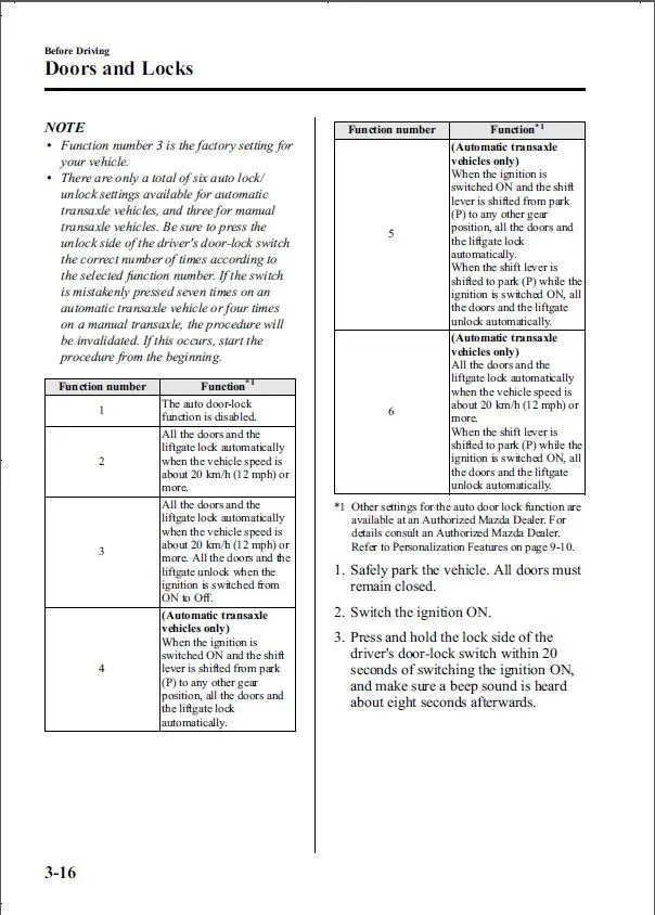

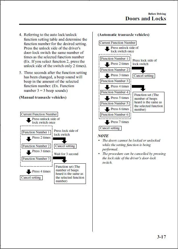

My '16 is programmed to lock automatically when it hits 12 mph (20 km/h). The attached pics are from the manual, hope they help. You have different options as to how to program your locks.

This might be better answered by one of our European friends since things like this (for e.g., auto-fold mirrors) are much different in Europe than in NA. And my guess is that the Euro-spec vehicles are what is sent to RSA.
I think that we can not program automatic door locking on in European CX5 (12-15) models. That I dont like in my CX5.

What does your owner's manual say? You should not have to guess about this or ask people on the internet.
Australian here - can confirm that 2015 CX-5 GT doesn't have a driver's side door-lock button. Only central locking mechanism is to lock the driver's door. :\
Disappointed - I was hoping there'd be another way to activate this feature.
