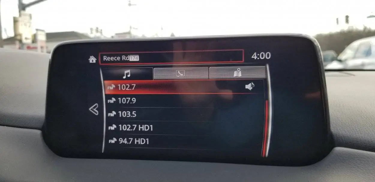

The anti glare coating is coming off my infotainment screen on my 2017 Mazda CX5. It is still under my certified used warranty. I took it in to a Mazda dealer and they took picture of it and sent it to Mazda. Mazda said they will not warranty it because they think something got on the screen to cause the damage. And because it is on the outside of the screen. I have seen post on this forum for the same thing and Mazda has warranted it. I emailed the Mazda customer experience center but they will not help. That should I do next to get this resolved. Is there a email or phone number to talk to someone at Mazda warranty department. Thanks.

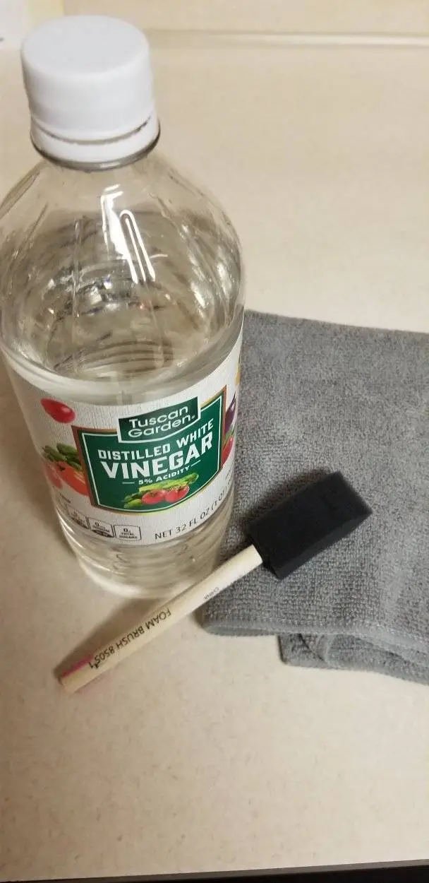

So here's my update! I watched a couple of Youtube videos where they described this issue on screens. It was called a 'stained' screen and apparently it happened on some Mac laptop screens as well. The solution to the problem they offered was to use and agent to clean of the 'stained' screen entirely. One guy used Listerene and another guy used vinegar. I got my supplies together (White vinegar, latex gloves, microfiber towel and some Q tips). I used the microfiber towel and did the
main body of the infotainment screen, and used Q tips for the bottom edge of the screen to avoid making contact with the dash.
The vinegar worked like a charm! The screen looks brand new! I guess the only issue could be glare now that there is no anti-glare layer, but after taking the vehicle for a test drive it doesn't seem like it's a problem. I'm considering getting a screen protector but am going to wait and see
how I feel about it in a few days. Hope this helps someone else!
