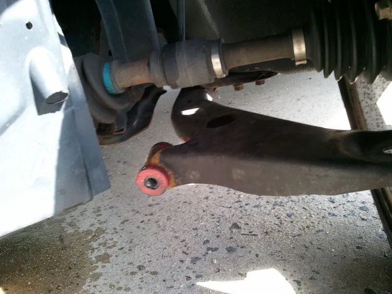

this would explain the pull...
attachment.php
attachment.php
attachment.php
attachment.php

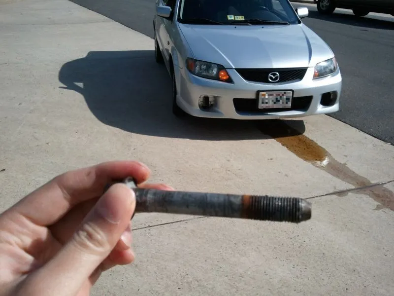

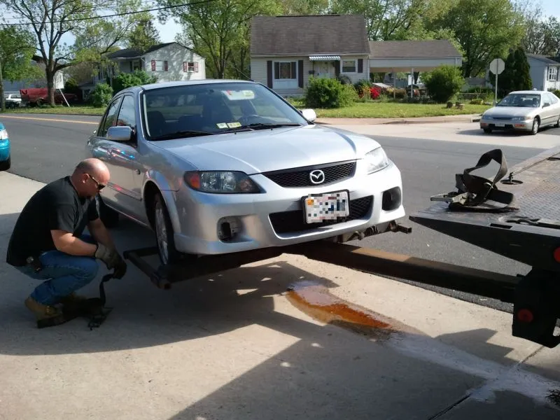

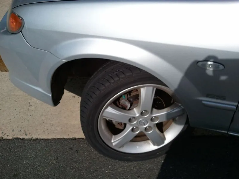

dont know which fluid that is. i assumed it was brake fluid but the resevoir is full and the pedal returns. my next guess is transmission fluid. couldnt move any more, no steering or forward/reverse gears.
my mom and dad were in the car when it happened. pretty loud noise from the wheel well and my mom totally freaked. my dad found this bolt a few meters behind the car. you can see the tire tracks on the street from when this occured and i managed to direct it towards the closest intersection and as far off the road as possible.
oh and the best part? i went to the shop later in the night to get my radio/misc stuff out of the car. the car was locked and alarm was activated. when i arrived at my car all the loose change in my cupholders were gone. i had taken out of the center console while working on it, and put the console back with only a couple screws and left the others in the cup holder to finish working on later. the screws and caps are gone too! the tow truck driver must've grabbed a handful of whatever was in my cup holders and stuffed it in his pocket.

likely it is trans fluid and the axle was pulled from the transmission when the control arm cam disconnected. I know its not up everyones alley but this is the s*** I couldnt stand any longer and the reason i started to do ALL my own work with me and a friend if needed. Shops just because they have a name and maybe some "certifications" doesnt mean s*** most of them do shotty work at best with a few good shops scattered. sorry to hear this happened to u and good luck with getting it fixed
yea, i dont have technical knowledge, tools, or time to work on the car as much as i can. basically a few things that can be done with a socket wrench and a screw driver is the extend of my abilities.
i went there in the AM and showed them the bolt, they couldnt figure out why it happened. they also bring it to a 2nd shop for the wheel alignment and said anything out of the ordinary would've showed up then too. waiting to hear back from them. wondering if i should file an insurance claim at this point.
i wouldnt take responsibility for it by filing with your insurance. either them or the 2nd shop are responsible. likely going to be the 1st shop since that bolt had to be removed when putting the bushings in. Looks to me they either didnt thread it in, or the nut was not there and the bolt wiggled out. I highly doubt that either way would have been noticed by someone doing an alignment since they do not need to touch that area to do the alignment and they weren't looking for anything. I would definitely be up the 1st shops ass to repair the car how it sits, plus the cost of the trans fluid a new alignment and hopefully the tie rod/end didnt get ****** up from the added stress when that came out.
i got it back from the shop that did the work. they said they were sorry about the bolt, retorqued the bolt on both sides for good measure, reinstalled the right half shaft. they replaced a broken fender linder (albeit with the WRONG part #), and refilled the transmission fluid. they took responsibility and didnt charge me anything so i guess they tried to make it right. i'm never going back to that shop again though.
