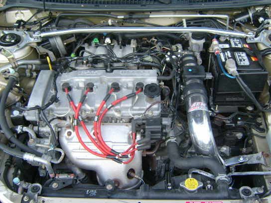

This is it, but Ive added a Optima redtop battery since this pic was taken, and Ive removed my Amp's power wire...since stereo's = more weight in the car.

I went to go look for the coolant line...is it the one that kinda goes in the top then the other line comes out the bottom and goes to the block? Im guessing so...it made sense in my head when I was looking at it, but who knows if thats the correct line or not.

yeh you have one line coming into the throttle body, then another line going from teh throttle body to the block. Remove both from the throttle body, and remove the one that goes from the throttle body to the block completely. Then run the one that ran into the throttle body into the block at the same spot where the pipe you've totally removed was going.
Done and done.

Ok I know which one you are talking about, it comes up from the bottom of the TB then goes back out to some other location that I couldnt see at the moment...****** FSDE motors are nothing but a rats nest of Vaccum lines lol.
