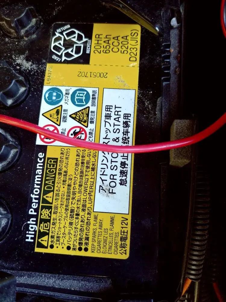

Thank you both for pointing it out to me. Indeed my battery is the "high power" type as shown in the first photo, still with the unknown CCA and AH (not so unknown,see next post) Now to the question of battery replacement in future, I will have to rely on the mercy of the Mazda dealer due to battery registration issue. By the way I think I have the istop without ieloop and there is no ieloop capacitor box on the front left or right corner of engine compartment. I do not see the ieloop performance in my screen. One less electronic thing to worry about and besides Mazda itself thinks now that ieloop did not save that much on energy. Thanks to erwei52 and ceric once more for the correct information.
Just removed the transverse battery hold down bar and lo and behold the battery AH and CCA for my istop cx5 (no ieloop), revealed itself. It is a 65AH 520CCA start stop battery. So how can a battery with CCA of 520 show CCA of 580 after 3 years? Should I thank my CTec mx 5.0 battery charger with reconditioning mode that I use regularly every few months?

Thank you cz5gt for your reply and suggestions. Even if the battery is a JIS standard, it does mention the AH and the A (CCA) on a label on top of that Panasonic battery and it is 65AH and 520A. I did that measurement with the Foxwell analyser two days after recharging it with the cTek mx5.0 charger and topping up with the distilled water, both two days before, so as not to measure surface charge from recent charging. Panasonic must be under quoting it's battery capacity or there is the temp correction which is not there or is in correct. The idea of using the flash light to check the acid level is great and I have done it in other batteries that did not have covers on the sides. Did not know that you could remove the cover partially. Thanks. I was wondering if you had a link to the new battery coding procedure, just for future reference.
Thanks for finding the specs on your factory Panasonic battery for CX-5’s with i-stop. It’s interesting to know D23 is the battery size and post location under JIS (Japanese Industrial Standards), which is similar to our “Group 35” battery size / type in the US.
battery controversy
The 580 CCA rating measured by your Foxwell analyzer which is higher than 520 CCA spec could be just the difference between each battery from factory. One thing for sure is your factory Panasonic battery should be still in good shape.
