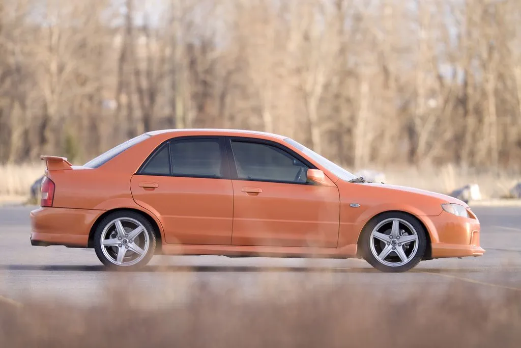

Ok for comparison. Tokico HP/Ion springs. vs Stock/Ion springs
Back is lower by about 1 inch. Pinky gap.
No wheel gap up front.
