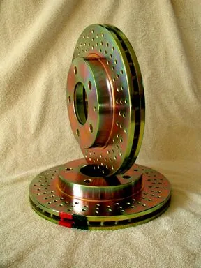

also, does anyone have pictures of cadmium plating? what are it's advantages appart from rust resistant? does it improve braking? does it wear off over time?
later
These are cad plated. The gold comes off the swept area - leaving the standard looking rotor cast iron colour.
If by cadmium plating they mean zinc-cad plating (which is the gold stuff in the attached photo) then yes it comes off the wearing surface. Buggered if I know what it does to initial braking performance as well!

the cadmium plating is there to prevent rusting on the non-wear surfaces of the rotor. it wont do anything for the wear surface of it, and will be gone the first time you hit your brakes. and that part will still rust a little whenever your car sits for a day or two. There is nothing that can be done about this except just to drive your car and hit your brakes. it'll ust wear the rust right off, and the rest of your rotor will look god because its covered with Zink cadmium.

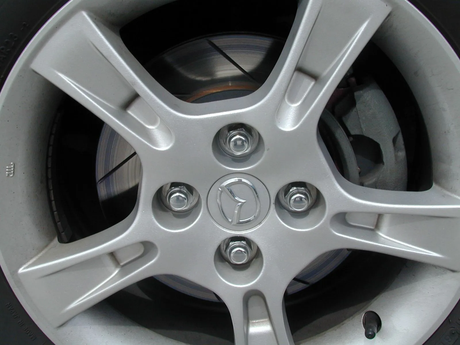

My DBA slotteds came with a grey paint. See attached pic. Sorry about the size.
The bluing on the rotor was weird after bedding the pads - I don't think that I left the old pads on long enough with the rotors. The discolouration is now gone though.
