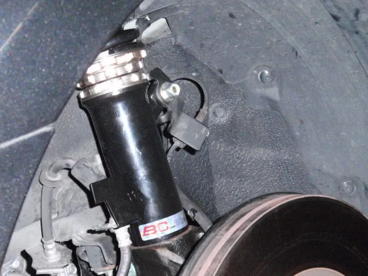

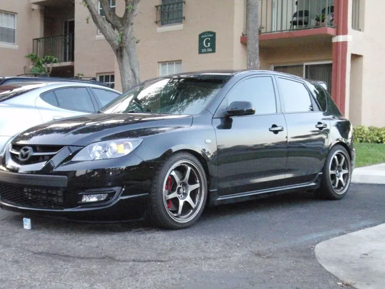

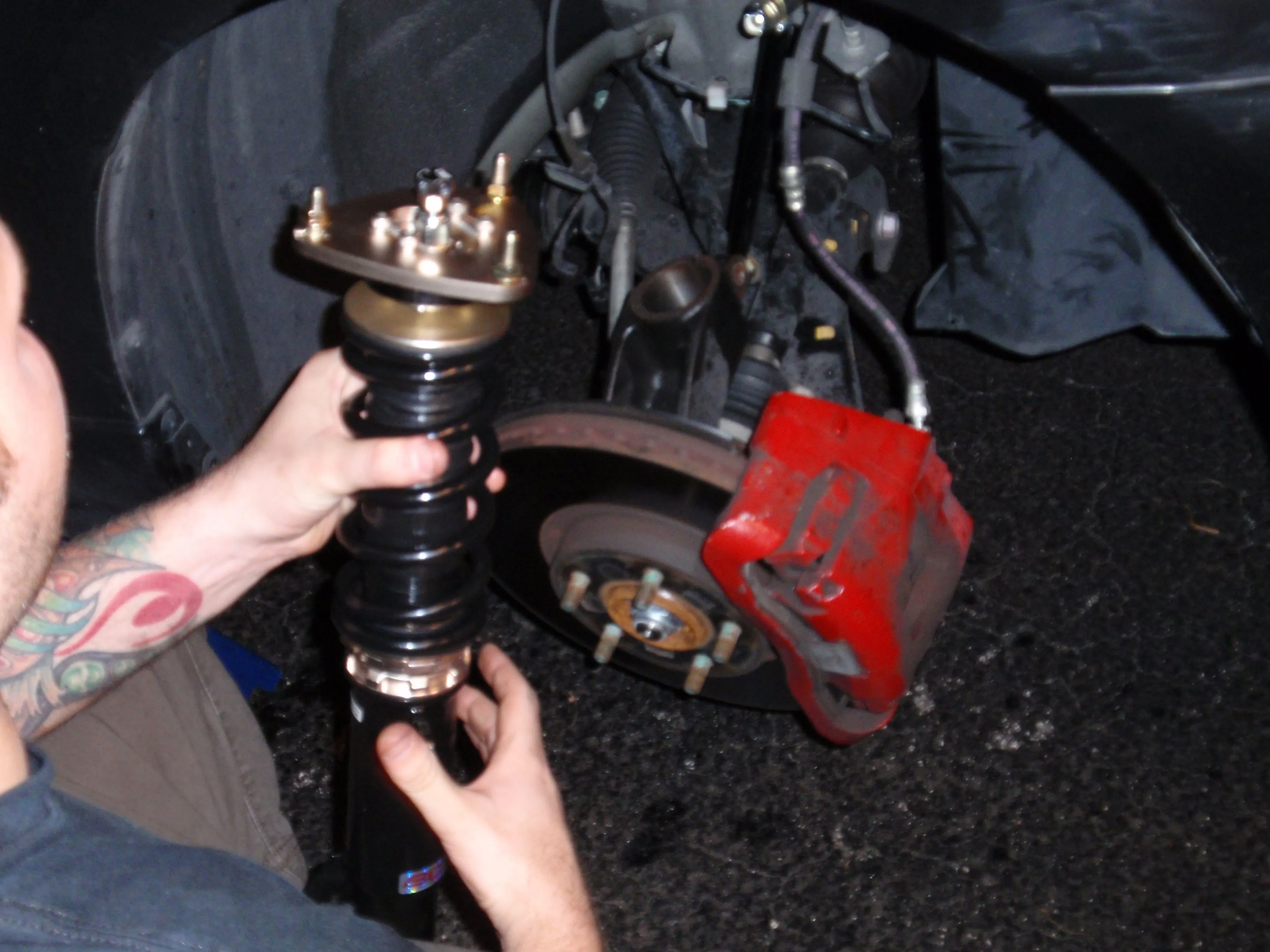

Hello all... So as the title reads, i installed my BC coilovers, AWR endlinks, and Cobb sways this weekend...(drive2)
These things are great! I was hoping for half of what i got. I am running full stiff on sways, 14 from soft in the front and 16 from soft in the back on the coilovers, and the endlinks are set to the factory.

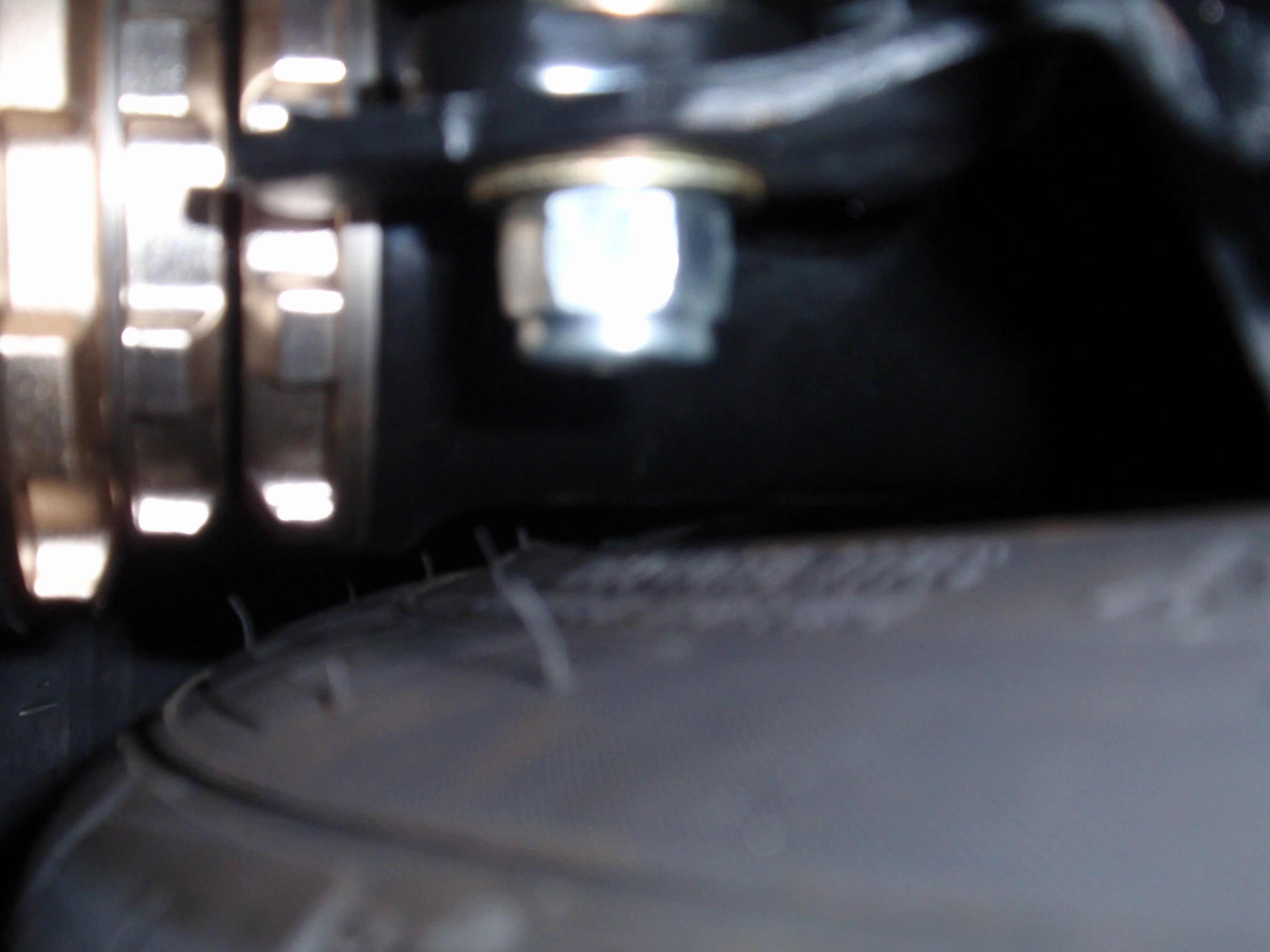

A couple of notes though... People with 18x8.5 48 offset... the bracket that hold the abs sensor out of the way will bite! Secondly, thanks to Josh at Import Images!! Dude, you rock!
Here are a few pics of the install and the results...

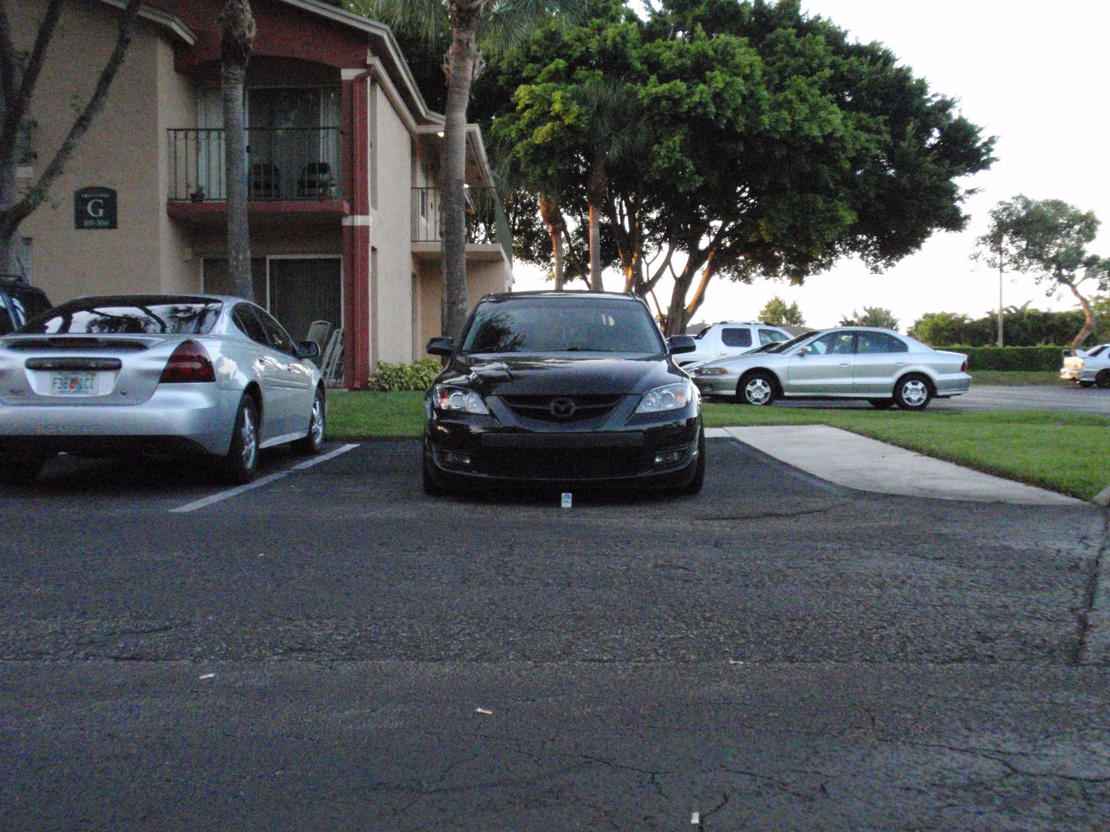

Looks gooood (thumb) Hows the ride?
I really havent driven a lot, but the cornering that i have done is freakin great... The car is so much more neutral than before. The road noise and comfort have gone down a little, but honestly i thought that it would be a lot worse. Maybe at the higher settings it would be, but it wasnt near as drastic as i thought... As a matter of fact it wasnt near as drastic as the Derlin Dogbone that i installed.

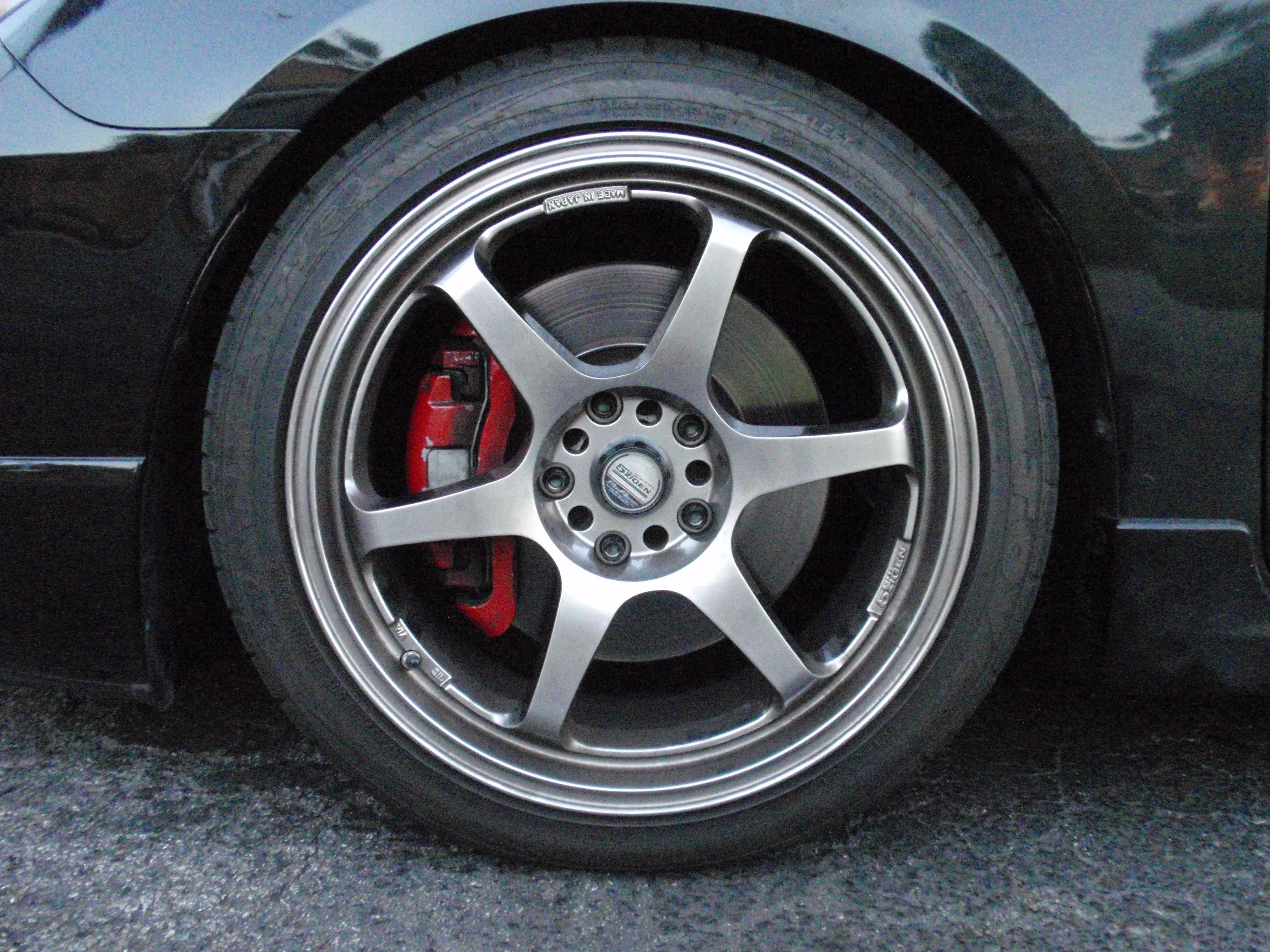

Nice man! What size tires are you running and how much do you have left to lower on the coils?
I'm running 235/40/18 Toyo T1R's on 18x8.5 5zigen ProRacer N+
The fronts are just about as low as they will go. The backs are pretty much as low as they will go.
Honestly though, i wouldnt lower it anymore for my DD. Any lower and i would have real problems in this state...the state of speed bumps everywhere! I come from St. Louis, MO...no speed bumps anywhere...

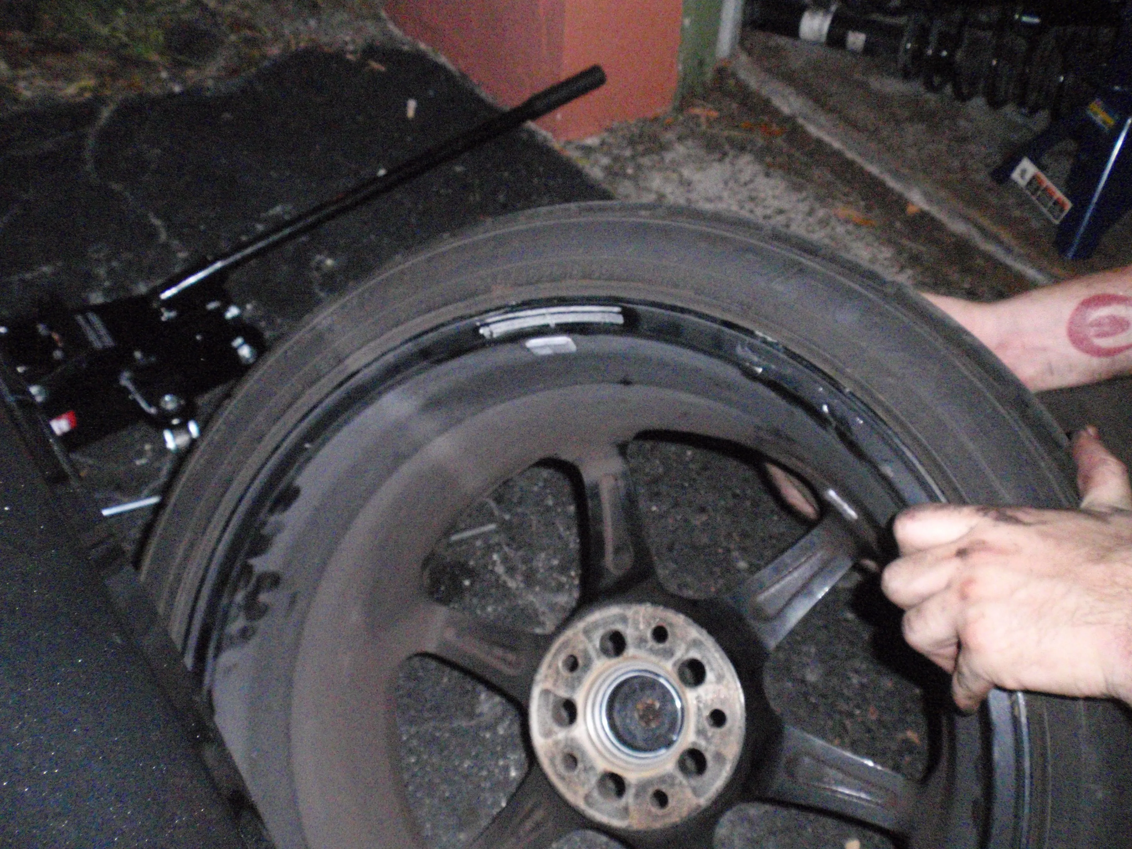

I had already rolled the fenders in anticipation of this install. That process was not hard at all. It just took time, a heat gun, and a roller that i rented from SU...
