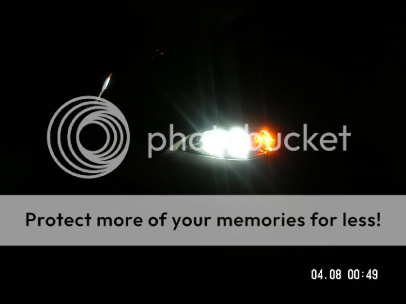

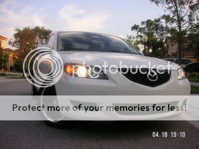

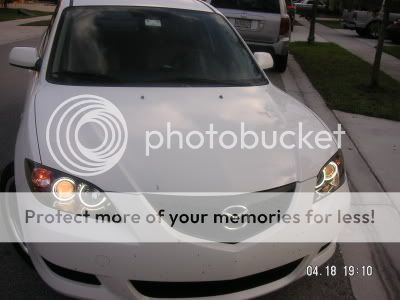

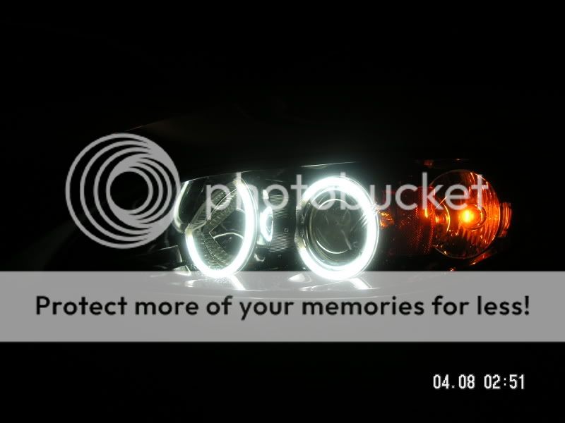

BTW, I have 1 set (all 4) of angel eyes just like the ones I put on my car. Just one, so if anyone is interested let me know. I'm selling them for 120.
If anybody is interested, let me know via PM.
