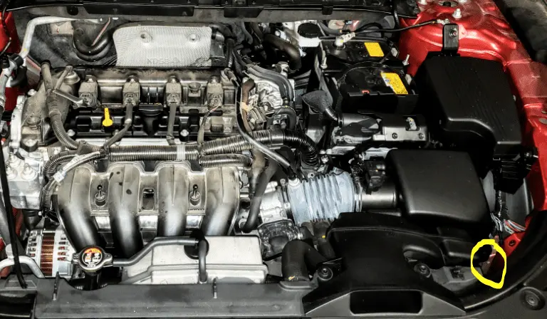

I dug around a bit to locate the ambient temp sensor (in front of the AC condenser to the right of the grill M emblem, looking into the grill). A good spot for the sensor to read ambient air once the car is moving above 15mph or so.

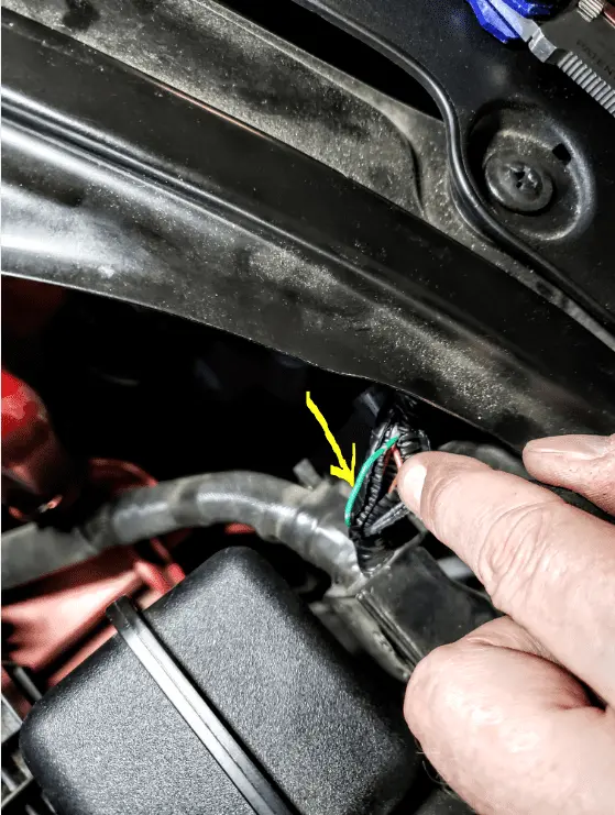

Traced the sensor wires, where they wrap around the air snorkel and into a wire loom . See photos. Used a razor knife to cut through the tape, then parted the loom, and pulled out the green wire. The sensor wires are brown and then green w/ white band. I cut the green wire and soldered in a 500 ohm pot so I could make adjustments.
