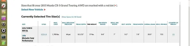

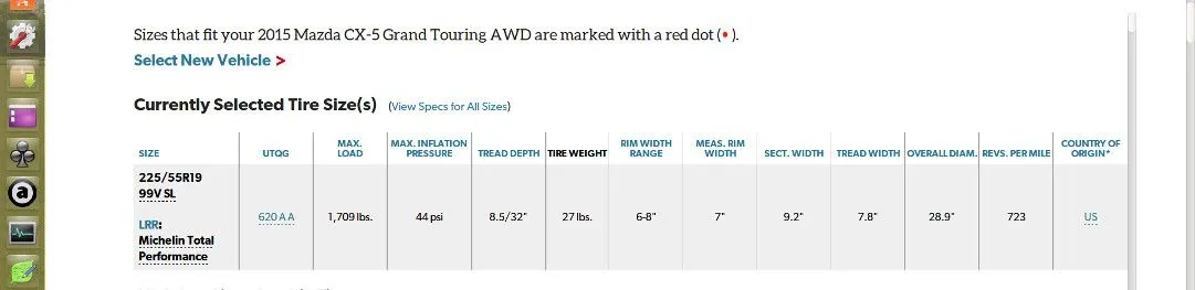

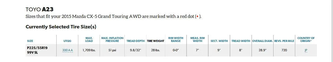

From Tirerack.com:
OEM Toyo A23
Michelin LTX
Same load rating, different pressure.

Another example on Toyo A23 225/55R19 99V tire with maximum load 1,709 lbs (@?) 51 psi maximum pressure used on our CX-5 GT, Mazda recommends 36 psi. In your theory each tire at 36 psi carries at least 1,709 lbs maximum load capacity for a 3,500 lbs CX-5, it definitely will be way over inflated and it simply just doesn't add up with your theory!
