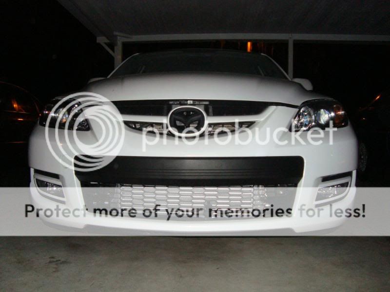

got it done over the weekend. its been raining so it was a real PITA to get this done but i handled it! haha.
now for the temp sensor and the fog light problem a lot have had, the temp sensor wasn't a problem. didn't have to bend it or move it at all. fog light, yes i had that issues also and it was a pain to get the bumper on but it eventually went on on. and first test drive didn't get on it really till right before i got home.

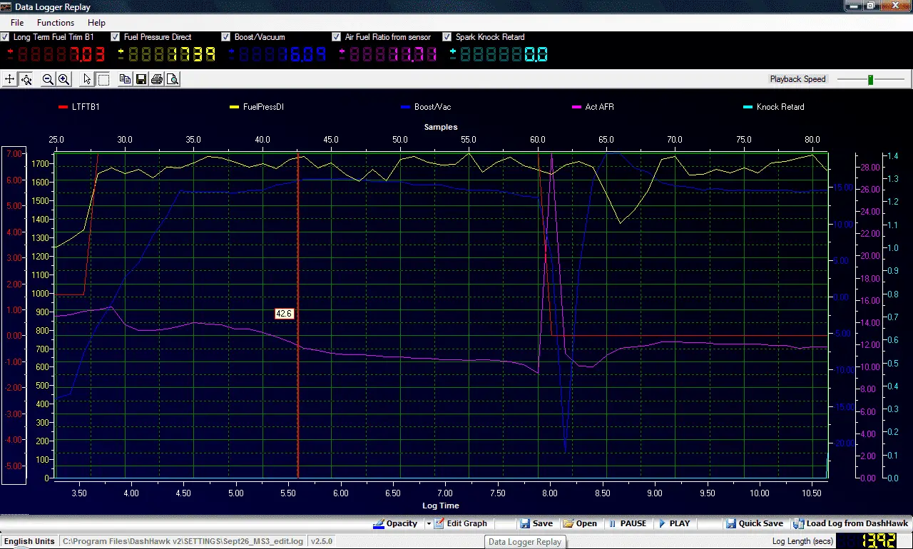

I have worm gear and have done a few WOT runs and even on the highway. No couplers have come off. we did tighten everything down with a socket wrench though (really tight) instead of a screw driver. Heres my first log with the fmic installed. She runs right around 16.xx and peaks at 19.75 3rd gear slow shift to slight 4th.
