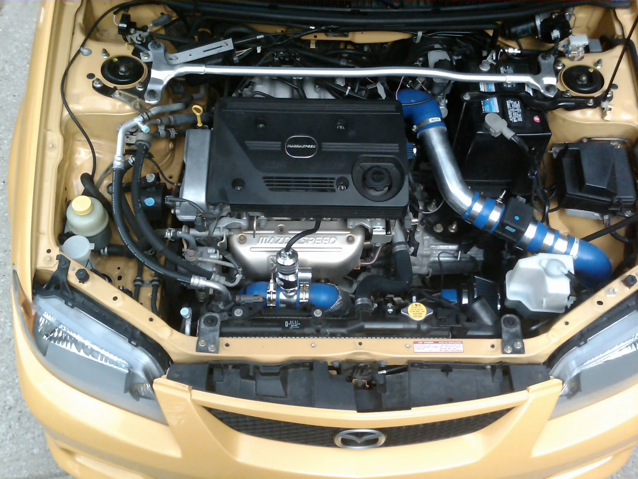

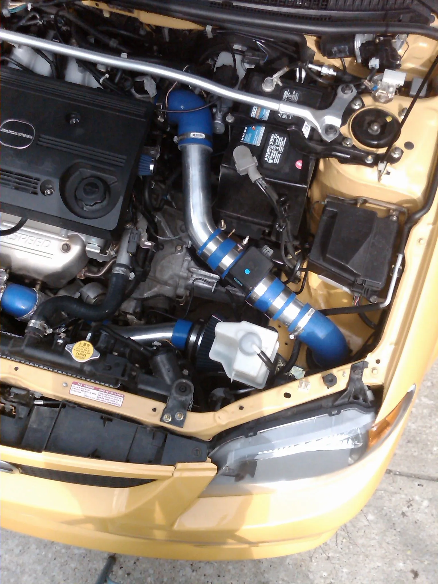

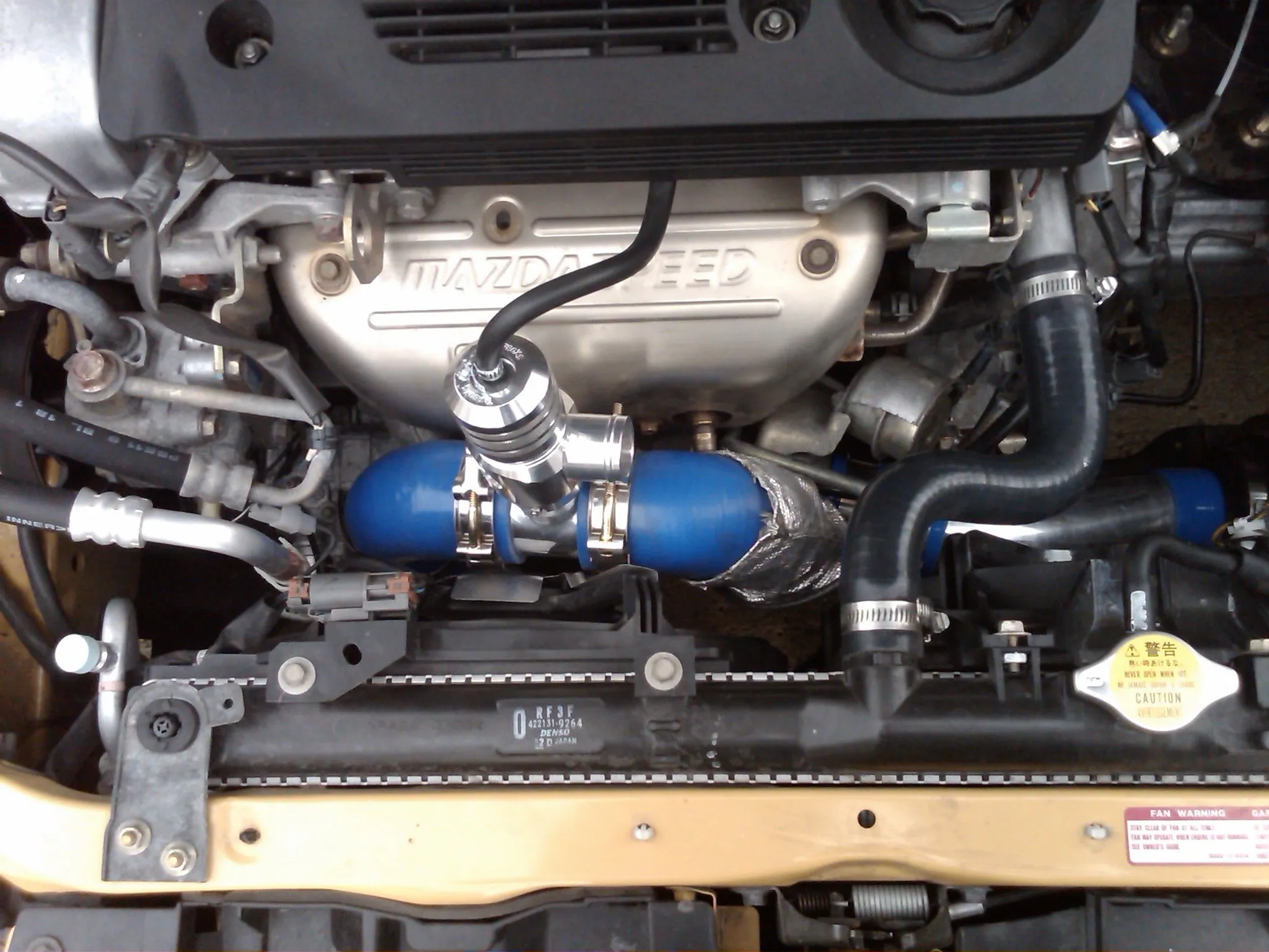

It goes from the turbo, to the bov, then the L pipe goes parallel with the radiator, then a straight coupler connects to the J pipe, then that one connects to the FMIC. Goes under the frame by the wiper fluid reservoir.

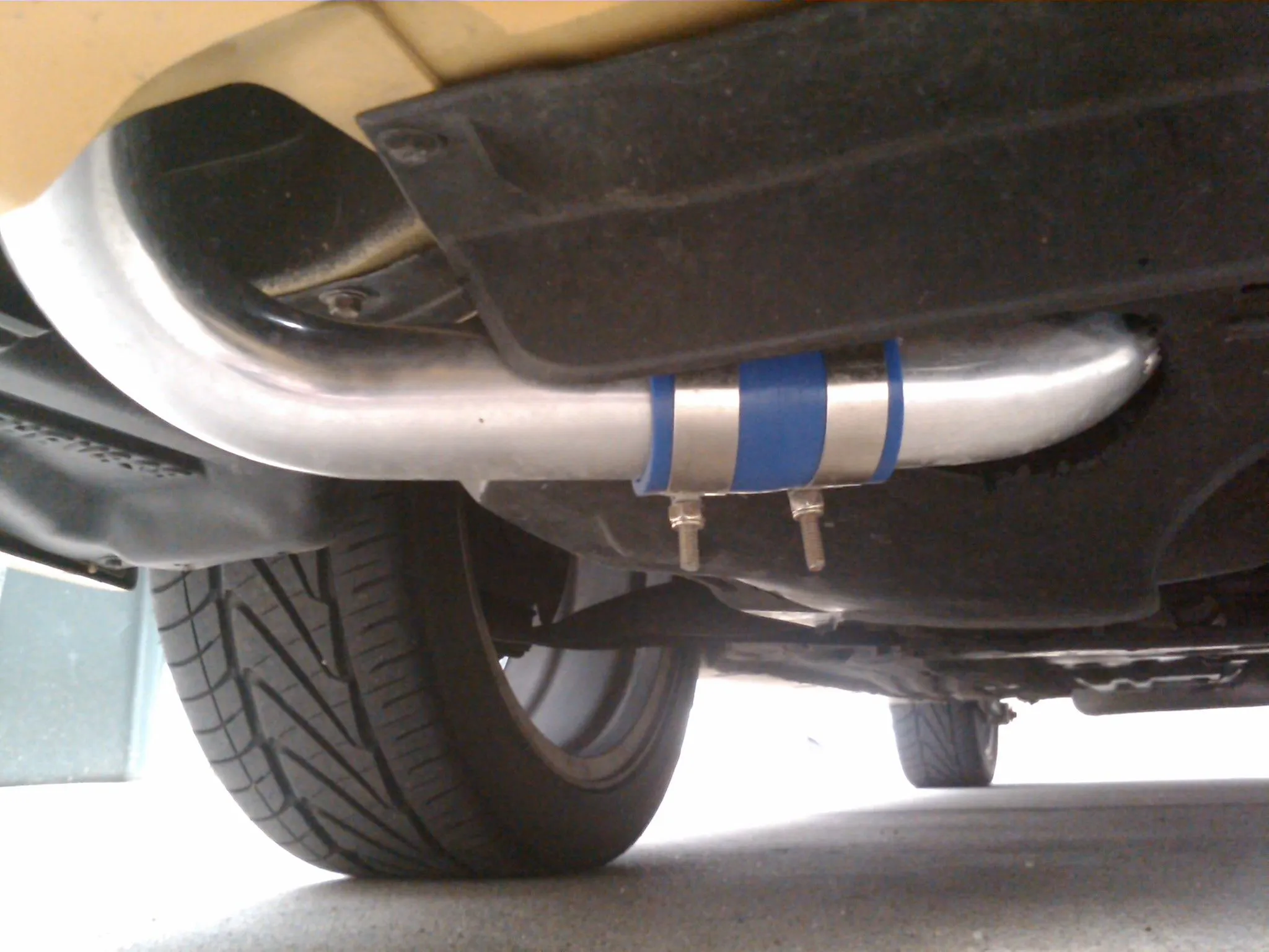

That's what I was wondering. I need to help a local install my old setup and I need to figure out better routing for the hot pipe. I had it just go under the frame before but that was too low to the ground.
