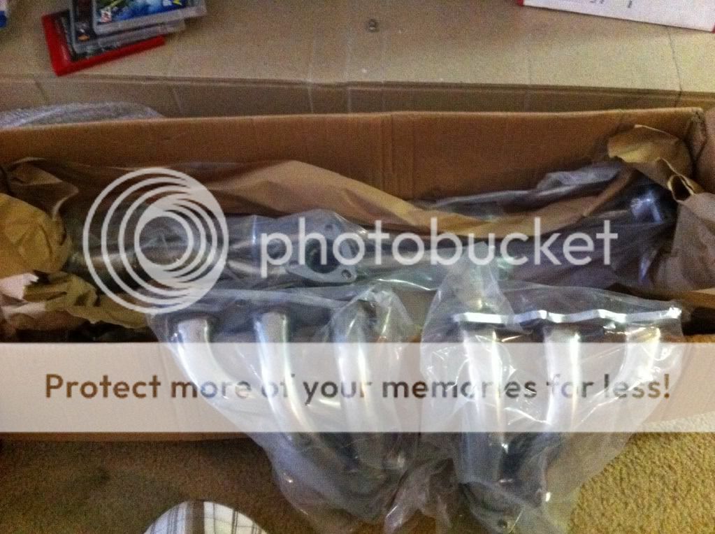

Got home lastnight LATE from Ewing, PA. for work. My wife, my kiddos and my friend made a run to the airport to pick me up - and all week I been hearing from my wife that "You got ANOTHER delivery today....what the f*ck is going on?" LOL! She said there were big ones, small ones, and all shapes in between.
