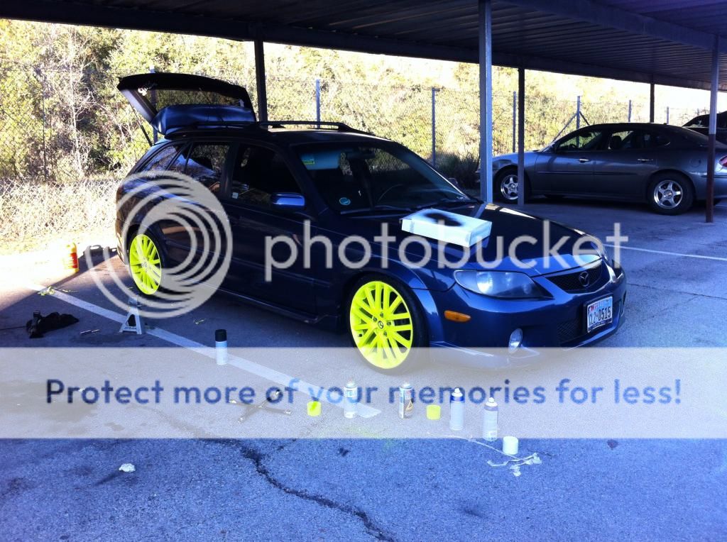

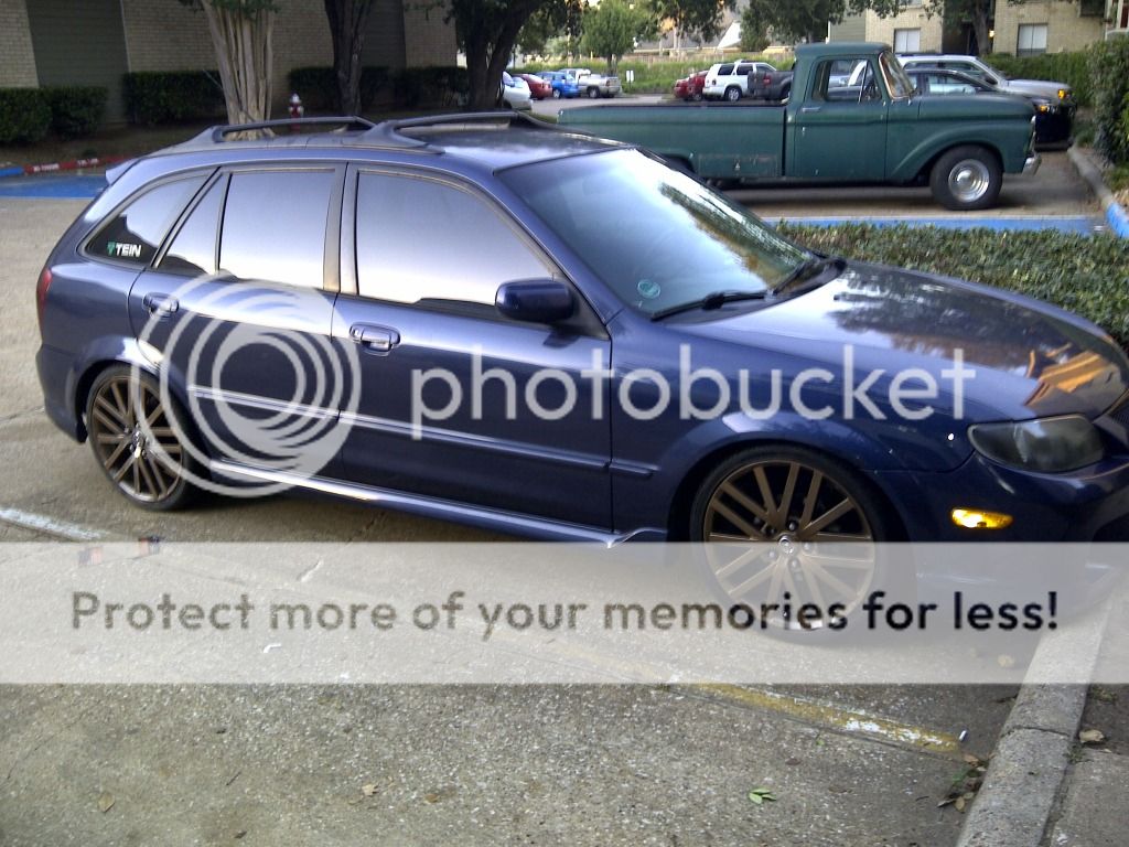

I was asked to clean up the P5 a bit, as they'd be placing it in the mainstream of the show-traffic. I had an idea also.....remember those bronze Mazdaspeed6 wheels I painted? Well - long story short - I will not be painting them with that Wheel Paint anymore, but I will however be using Plasti Dip on them!
Bronze Paint:
Now - a "Highlighter Yellow" plastidip for the show:
My wife walked out and I had just finished up - her exact reaction : "Holy Sh!t those things are bright! How fun!!!!"

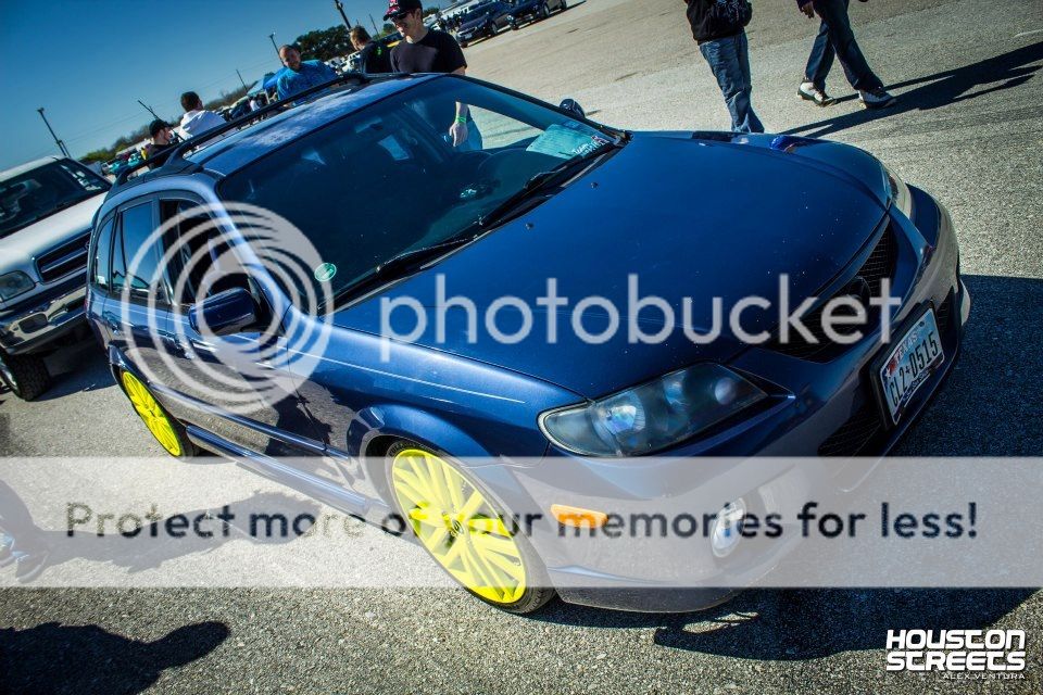

Today was a blast! IFO Houston 2013 was in full-swing.
Didn't do anything big for the carshow, but the crew and myself DID bring home 2 1st place trophys:
Sound Competition - 4 door sedan class (won with 149.7 db!)
Overall Team Participation (entries) - Team SwapaHolix!
Pics and vids of today's fun to come!
The wheels look great that color and congrats on the wins!
Houston Streets has a few pics from IFO and of the club cars. Check these 2 out....lol!
