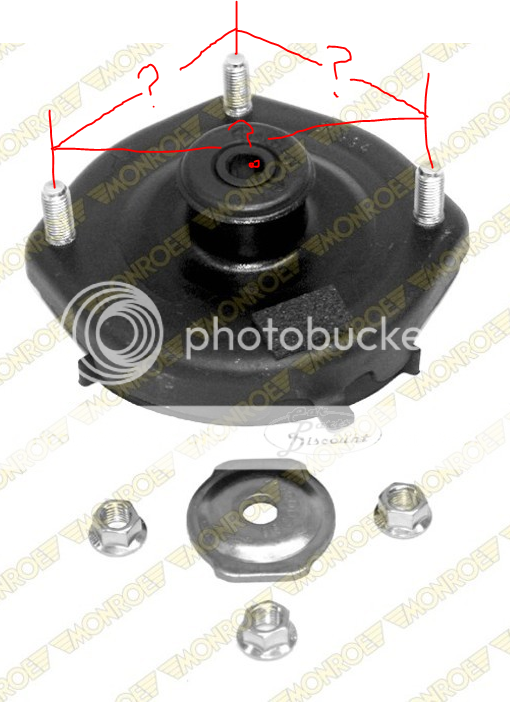

that'd be great bpro! I'm currently doing just as Evan hinted at.....as one time I was trying to come up with a STB that would accommodate the KL intake and still give great rigidity.
I've come up with a design (still hush-hush) that actually Ties into the firewall via a plate mounted behind the AC lines (if you keep the AC that is). It's a triangulated STB of sorts that isn't hinged or have any breaks in it - it's solid as can be with 1.5" DOM tubing, mandrel bends, and support gussets that are made of 3/8" plate......yeah - it'll be strong. I just need to know the mounting dimensions of those rears so I can make my rear STB. It'll be a monster also.....going to the floor via x-bracing and tie into the rear seat mounting positions also.
Can't wait to have all these pieces done....then I can feel good about making something myself......versus paying someone wayyyyyy too much for something that doesn't do much but look purdy....lol.
alright distance center to centers are
both small distances are 3.5", the longer distance is 5" thats center to center and i have pics i will be sending you
