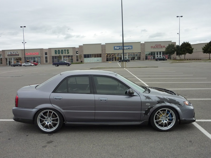

alright - here goes. KL-P5-take2

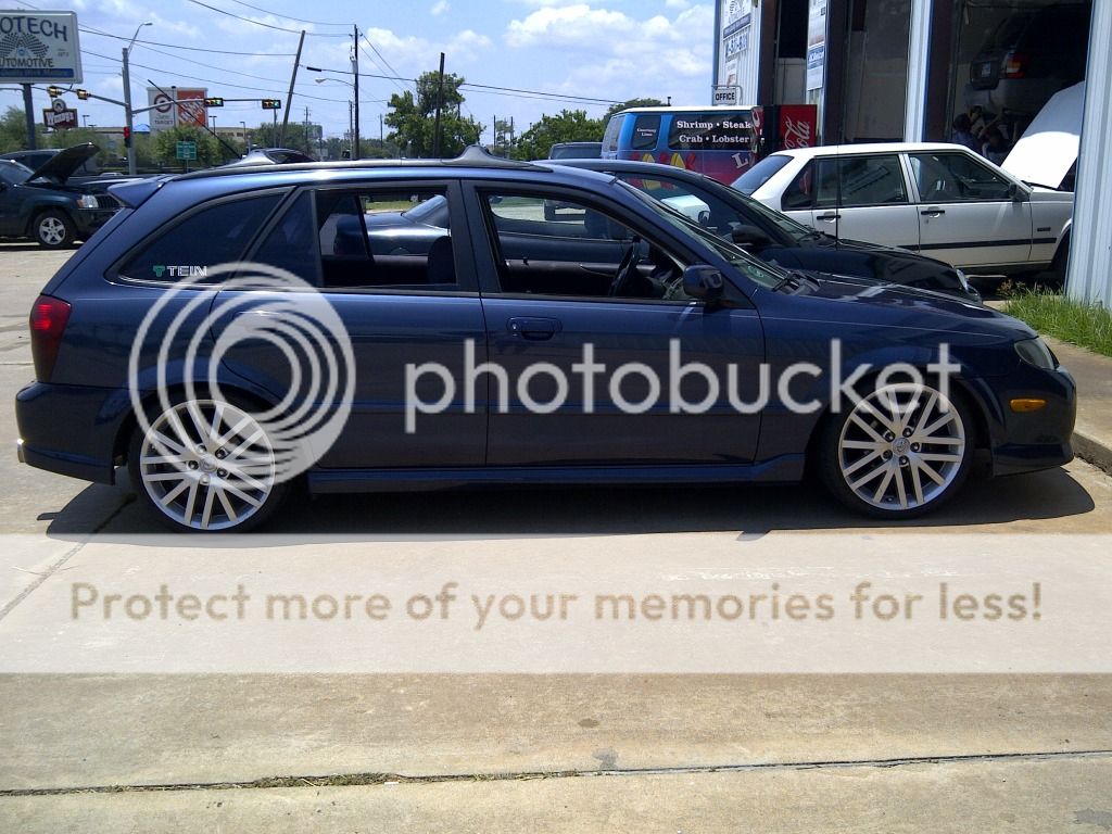

Here's how it looks with 215/35/18's. I think I could've gone with the 40's. Although - it would've been tiiiiiiiight next to the struts on the rears.
^ I WANT THAT HOOD!!! But ihone I would go with the bronze especially with that midnight blue. Don't think the green would go as well with it. I understand standing out, but only in a good way. (wink)
