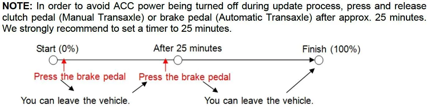

I took the brake tap instruction to mean at least every 25 minutes. Meaning tap more frequently if you like, but never more than xx minutes between taps. Since my car was in a stuffy hot garage, I got out after the update started and watched TV. I didn't need a timer, just whenever I had TV commercial I'd go back back to monitor the progress and do the brake tap. BTW, IIRC, the progress bar screen said to tap every 20 minutes - or - open and close the driver's door. So I ended up doing both.
Yeah, someone else here suggested tapping the brake RIGHT at the beginning when the progress bar is at 1%. That made sense. Tap it there, and then set a timer for 20 minutes. I'll do 15 like I originally set myself up to do, but then second guessed.
I'm lucky it didn't cause any major issues. Thank goodness!

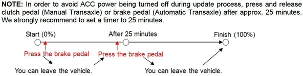

It's in the pdf (MAZDA FIRMWARE UPDATE PROCEDURE WORLDWIDE) page 7:
By golly it is.. LOL.
I even remmeber seeing that diagram.
What a tool I am - I did everything else right, checked off step by step what I was doing, checked the USB stick for corruption, checked the Hash of the update file, did it all right, and missed that one bloody step lol.
Thanks!
