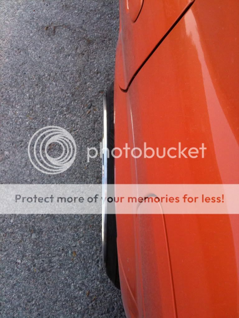

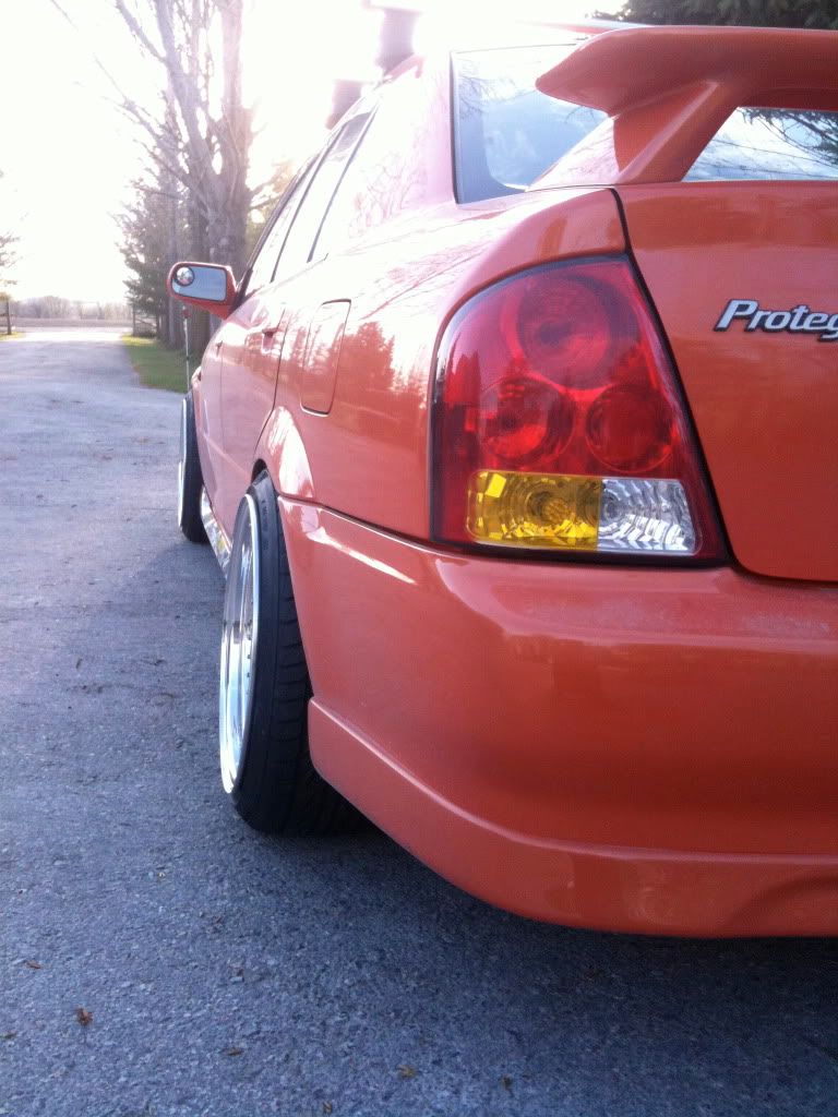

Chris, i did have a 15mm spacer on the front of mine which comes out to about 1/2. The wheel is a 17x8 +37, does that help?

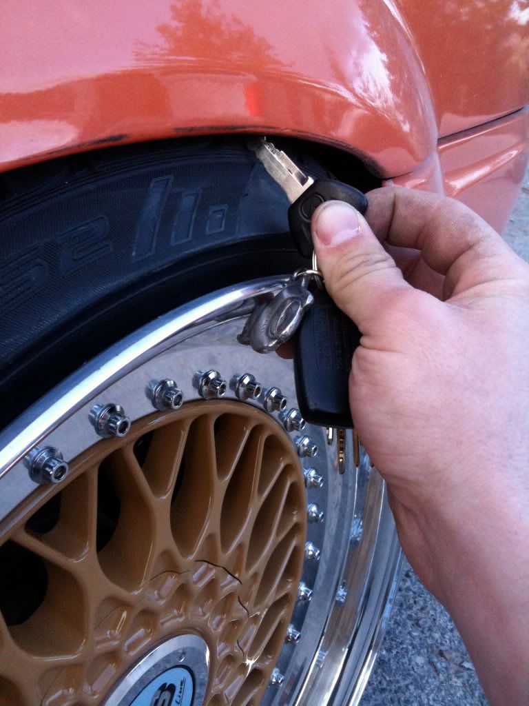

Very nice Chris! Did they say how much to fix the curbage?

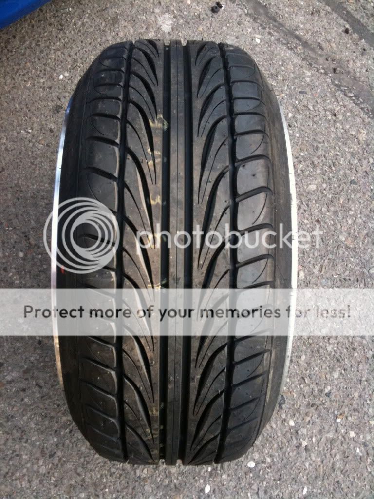

$100/wheel for full refinish, and they are going to sell me these for the same price as the narrower set ($950 cash + $400 to refinish = $1350)
So you were at 17x8 +22 effective?
So the 8.5 +37 would push the face out 26mm (just over an inch) compared to my current volks, and have 1/2" less clearance inside.
Going to do a test fit with both sizes on one side of the car next week.
Yes on being effective with 17x8 +22. I actually had a little more room to play with.

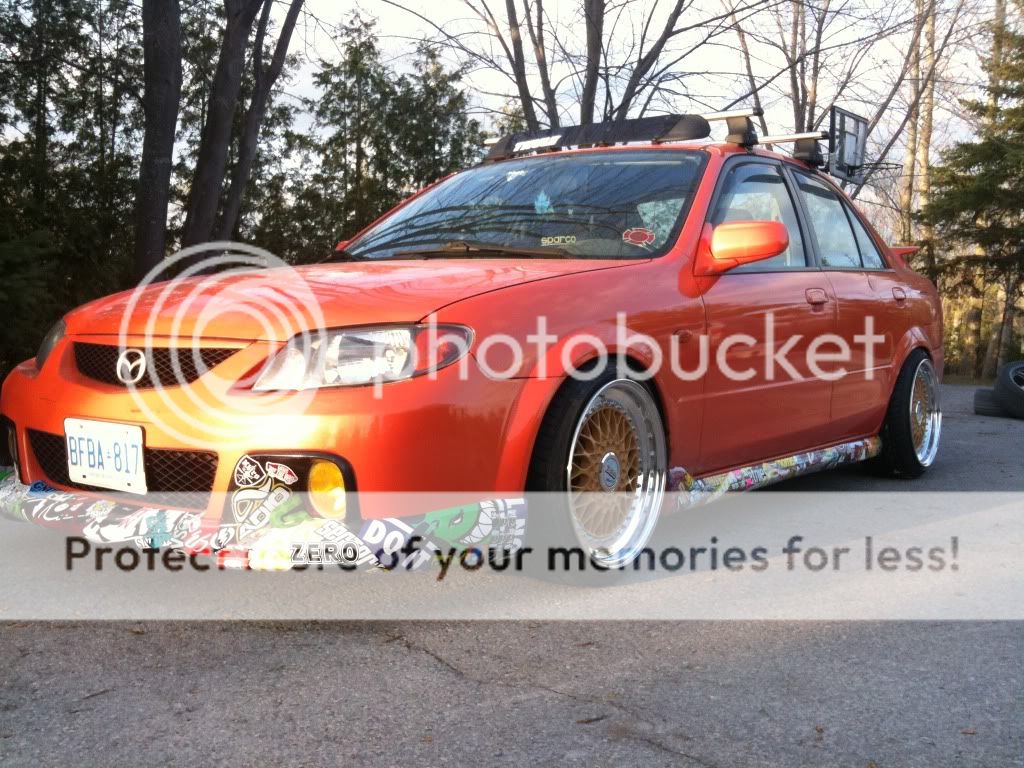

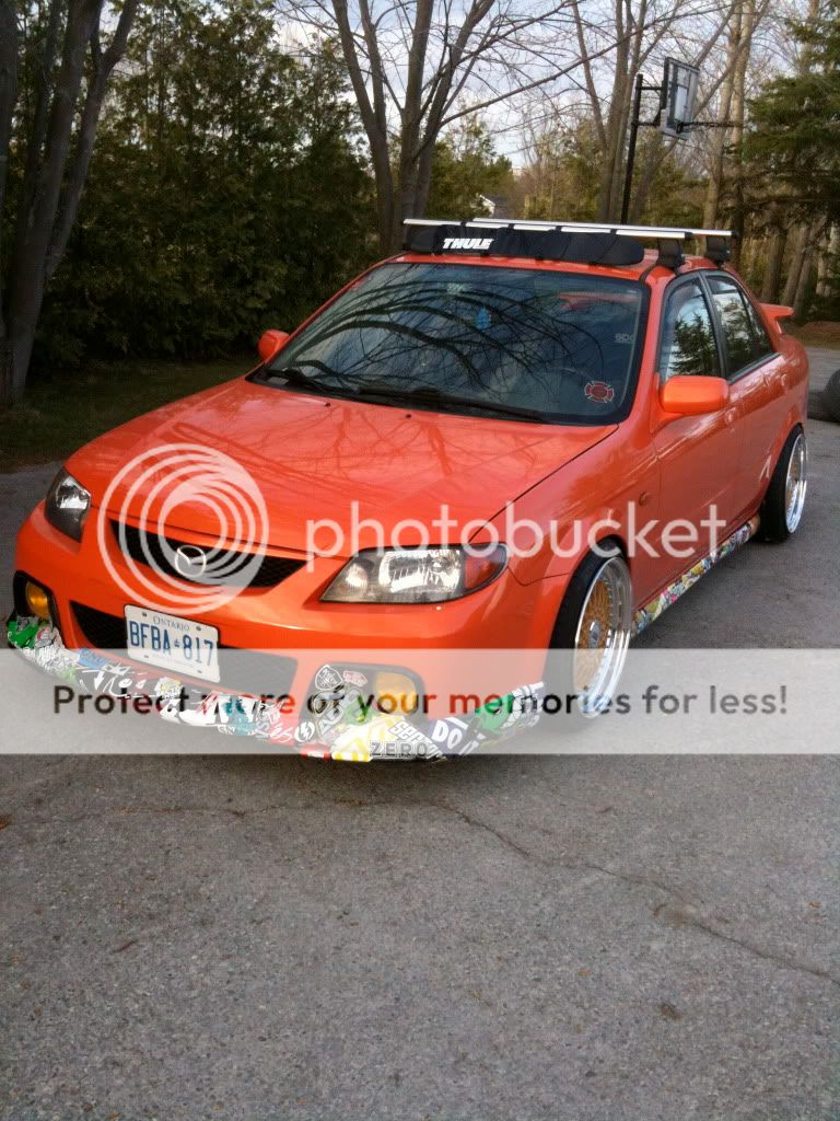

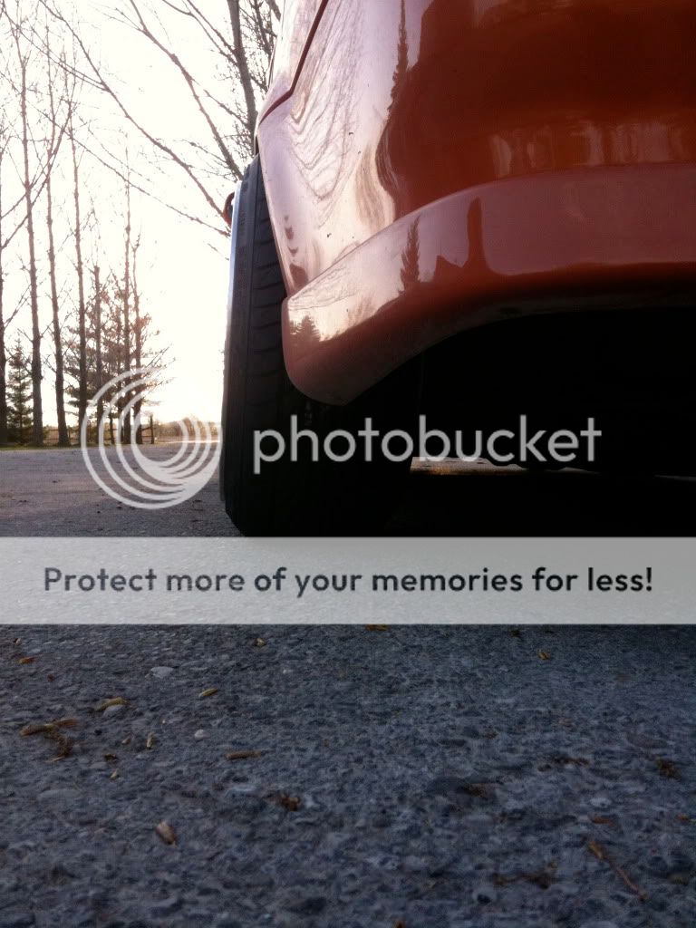

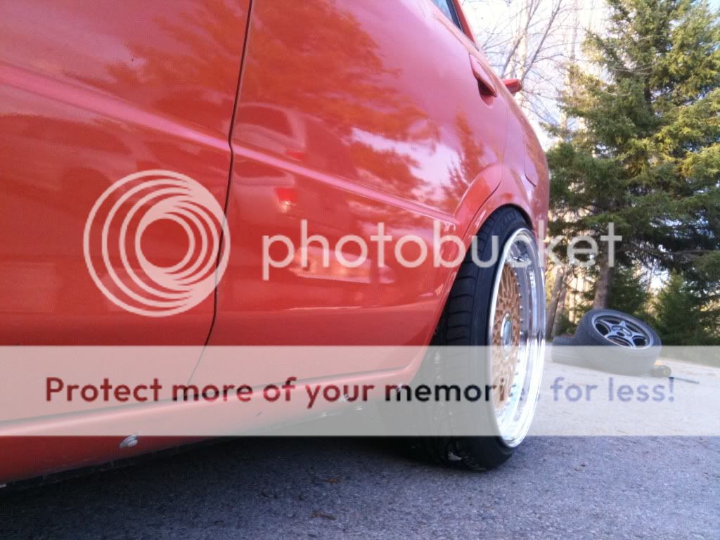

BBS RS 17x9 +28 w/ a 205/40/17 Falken 452 :)
doesnt get much better then this
front are at 0 camber and rears are at -2.5 which is perfect!
and without the side skirts really shows the stance
enjoy
