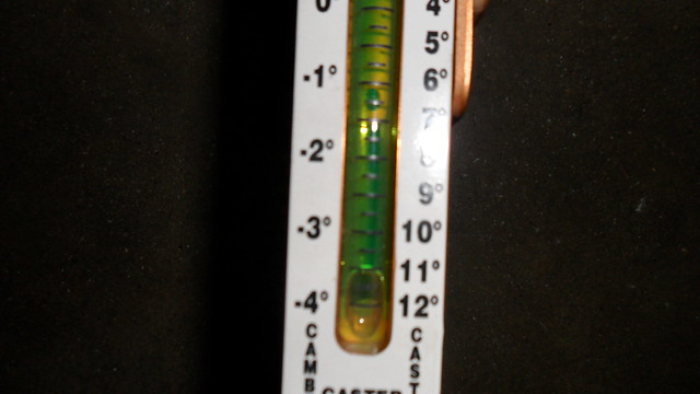

Got my front spacers on yesterday. Sitting at 17x8 +27 now. Pretty much perfect with -2 degrees of camber. Need to get pics.
oh snap, you actually use that home alignment tool? is it any good?
I was looking at buying it becuse my toe is WAY off, and my car pulls to the left pretty hard. obviously I cant get on an alignment rack so thats out of the question lol
yea, its ok. I mean its not perfect, but gets me close to where I want to be. Fastrax claims they are pretty accurate. the way I see it, if I see -2.5* camber, while it may not be truely -2.5, if I camber both sides according to this gauge, then at least it even on both sides. lol
toe is easy to adjust on these cars imo. like shane said, a string works. I use a wood board on each sides of the front tires. I will measure underneth the car just infront of and inback of the front tire. then using a sharpie, I will mark it using the board as guide. Then adjust from there.
Example: I had 68xx inches in front of the tire. then I had 67xx in back of the front tire. (toe out) So, I adjusted the tie rods...loosen one half turn (180*) on each side. Then remeasured and now I have 68 in even.
Car drives nice and straight and no pulling at all.

Longacre toe plates make it even easier.
If you can Id run a hair of toe out. Makes steering quicker and more precise. About 1/4 of an inch should be enough and you won't notice the tire ware to much.

thanks for the info guys, fixed the pulling issue.
I had a question though, how do you know which wheel is out? when you measure one could be at 0 and the other be way off, but theres no way of telling.
Any idea?
Any idea?
center the wheel, and check the front wheel to the back wheel with a string. if the gaps are different at the front or back of either wheel, you can get an idea of what is pointed where.
