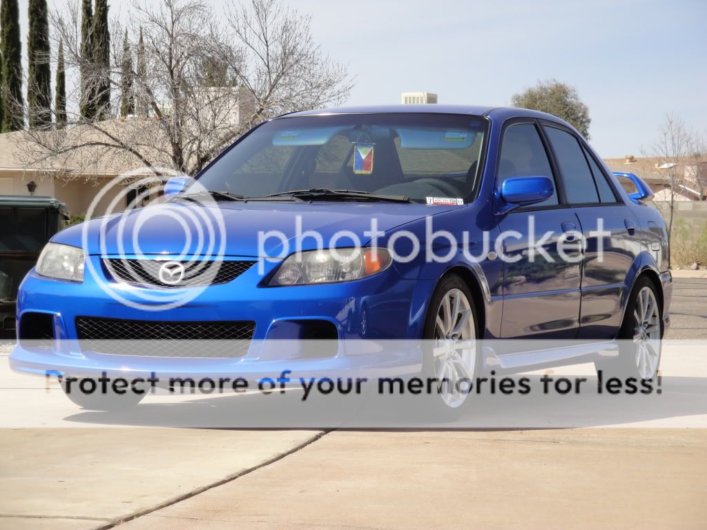

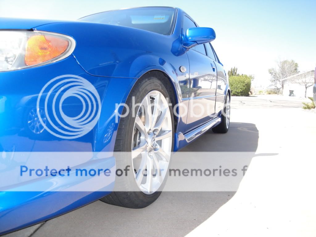

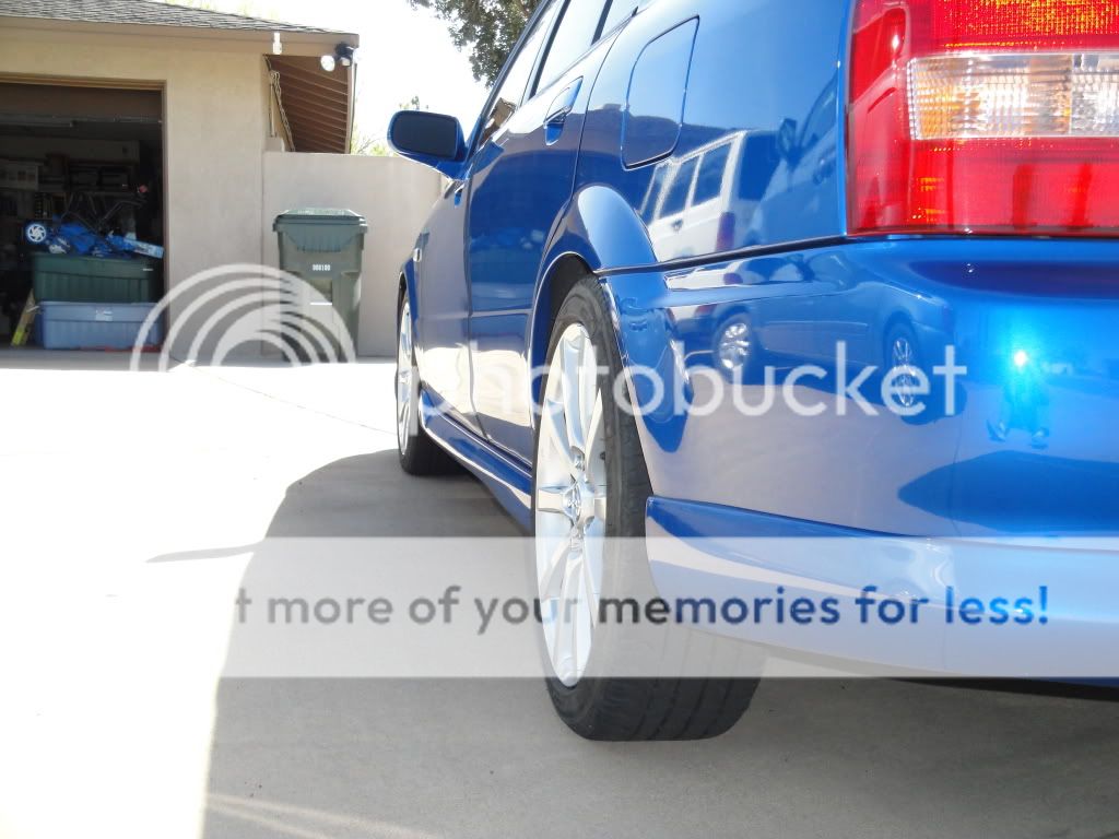

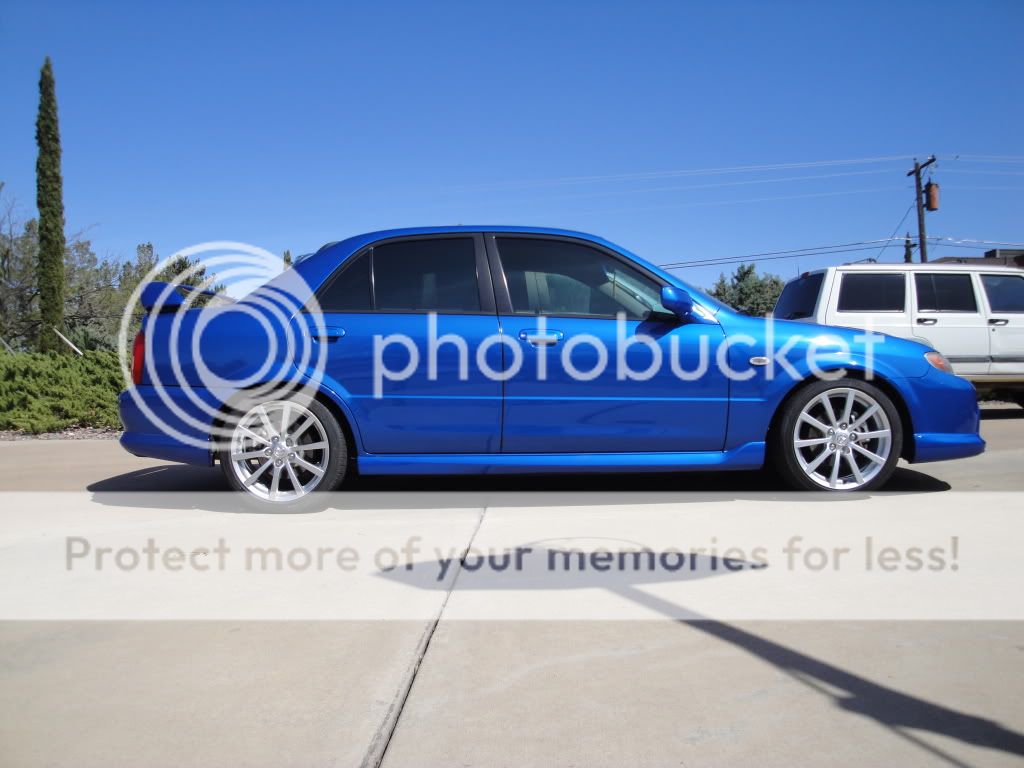

end result folks...
Technically these would not be considered 'after-market' would they? (uhm)
Thanks for the vote and for all your information over the last couple of weeks Laser Blue. Your earlier postings influenced me to get moving...(rei)
... and your pics have motivated me to get moving on mine. I'm gonna try to get mine on this week, so we can be twins!

No, they're 17's, but something about the design makes them look bigger than the Enkeis I had on before.
the mx-5 rims emphasis on the spokes compared to your signature where the emphasis is on the spokes ending at the outer ring, showing more of the side wall of your tire. The new wheels look great

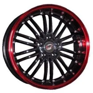

Am i crazy for liking these???
whats up guys i want to go different from racing harts and know i want black rims with a red or chrome lip i saw these what you all think. please dont be bashful lol oh yeah my msp is black
