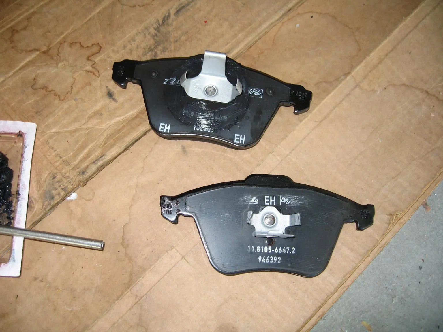

I read somewere that we share the same front brakes as the Volvo S60. I am very positive about this. I will dig up were I read this and post again...
Because of the relationship between ford/volvo/ mazda.
More pad info - Hawk R4-S avaliable for MS3
I have a new best friend that works at Porterfield Brakes (Thanks for all your help Wendy) which is a big distributor of Hawk R4-S pads. She did a little digging and found that our pads may look like the Volvo S40/V50 T5 (AP 915) but they have a different thinkness - not something I would use. As for the Audi connection - Yes - same as the 06+ S4 V8 editions (which have a different part number AP 915.1).

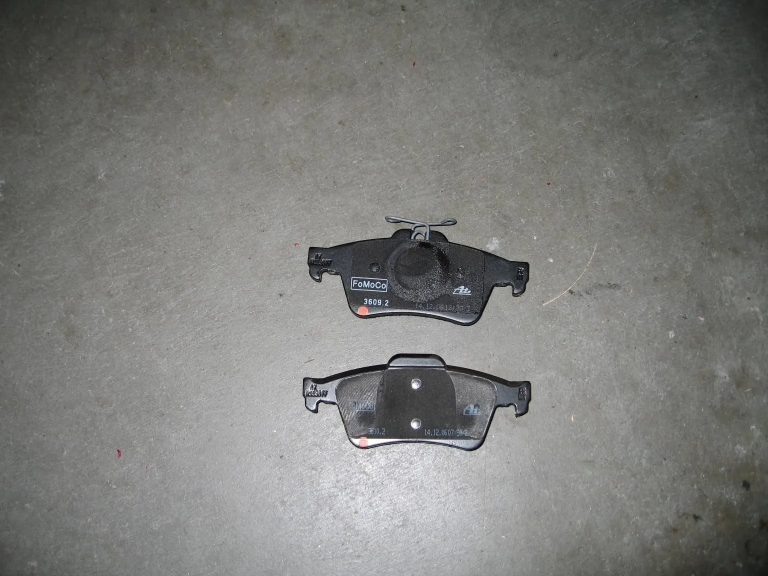

This information is for the front pads - the rear pads are the same as the regular 3.

What do you need a photo for? Pads are pads. :)
Weird thing. My car sat for a day and now all of a sudden the pedal is much stiffer. Makes no sense, but I'll take it!
Quite simply to be on they are the maid.
Because I ordered of AutoExe and they do not go….
You put that of AUDI?
