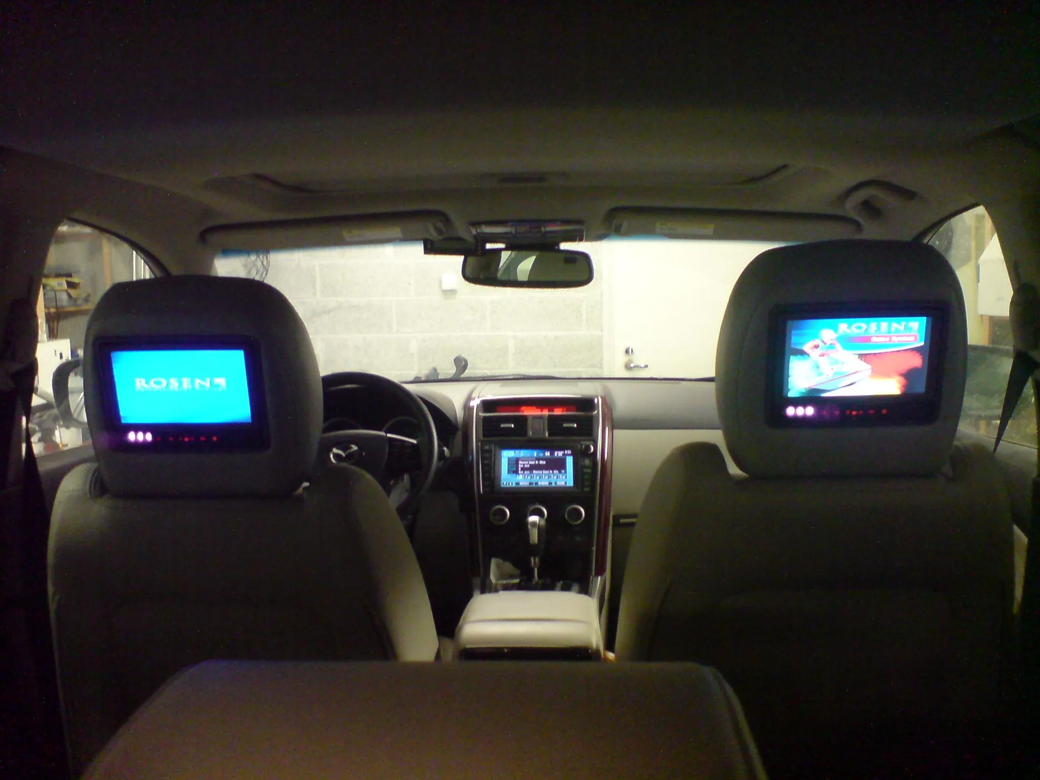

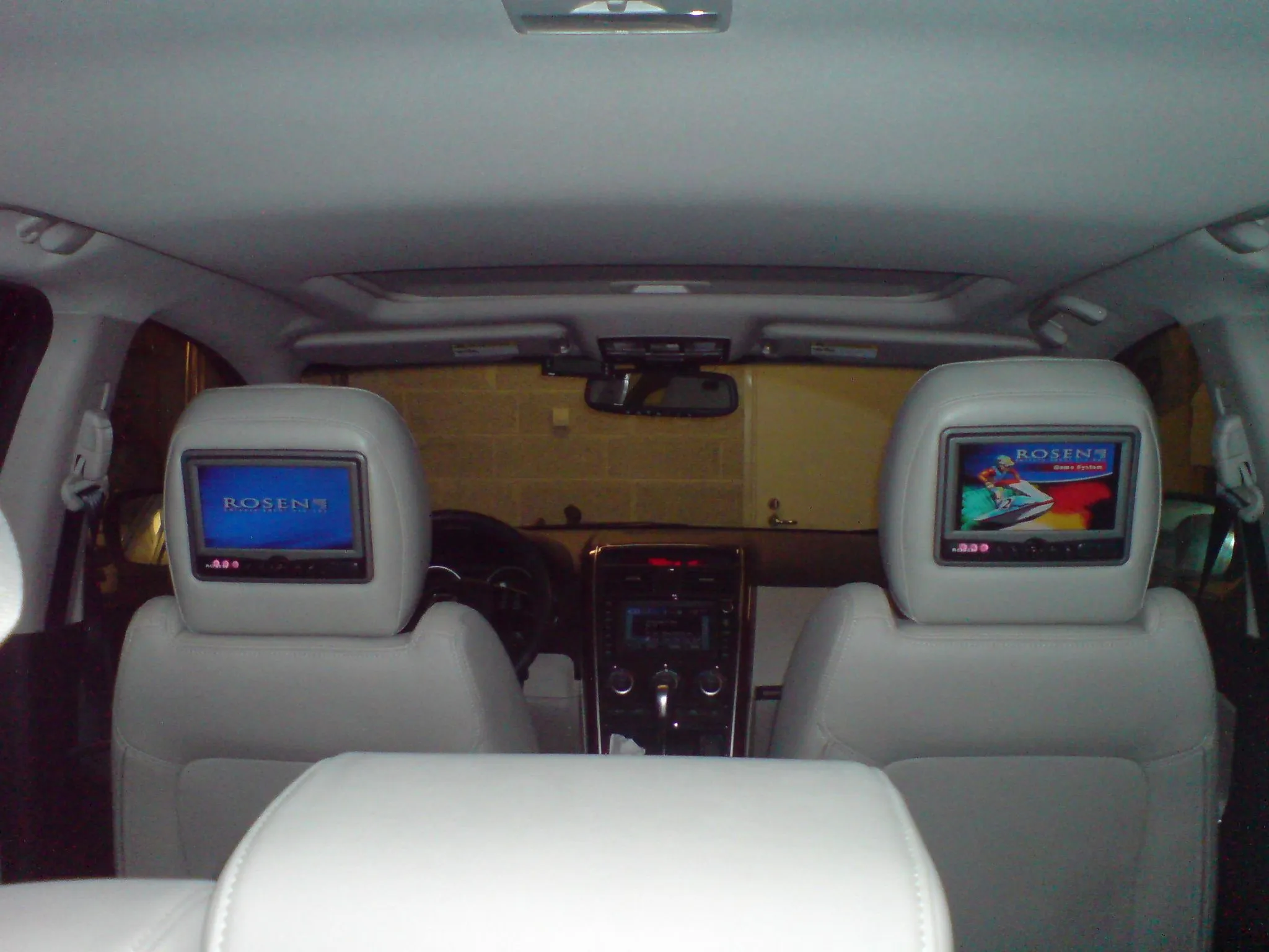

Have you checked out the Rosen Entertainment Systems?
http://www.rosenentertainment.com/
List price is $2000, but they're available for less.
Correct link would be
AV 7000 Headrest Monitors
I have them and i love the option of two separate DVD players and integrated game consoles (headbang)

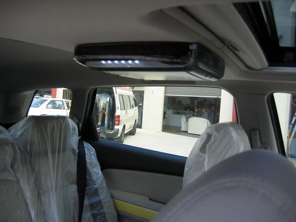

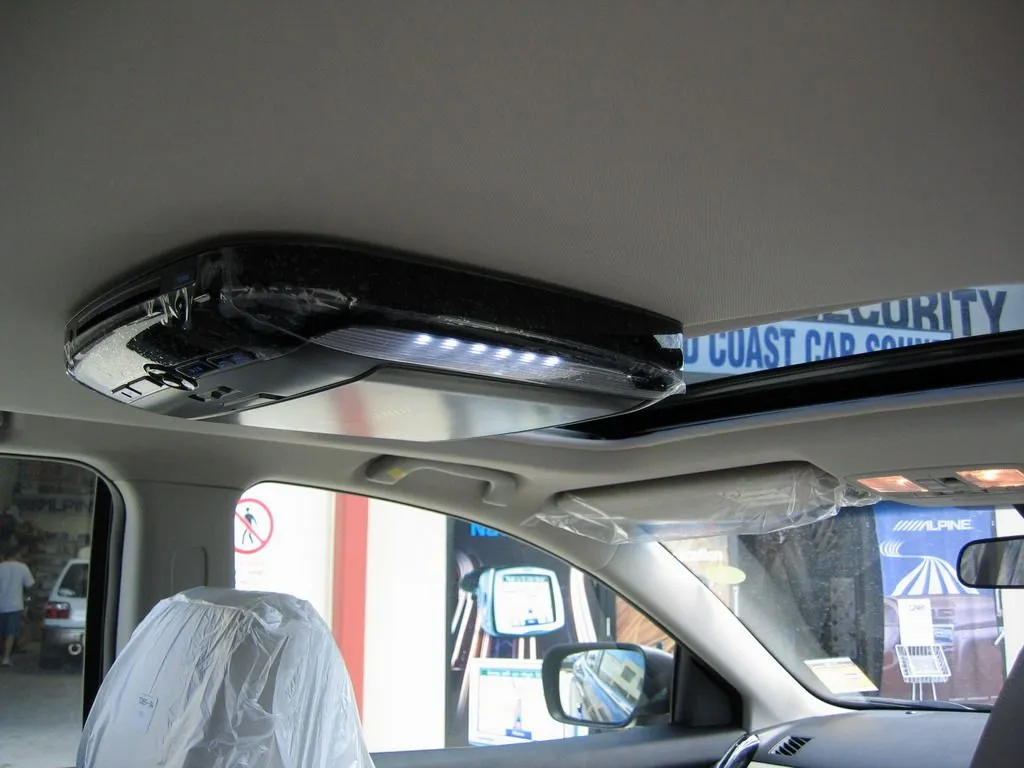

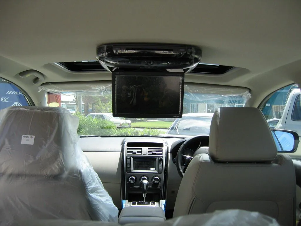

Hi there, Have some info that might help. I have a moon roof and just put in a overhead Alpine dvd player, Works great !! the kids love it and it's one of the best looking units i've seen. It has a huge 10.2 inch LCD screen. lovely LED lights and can be tund in to play on your cars speakers. Sounds sweet on the bose :-) Check out the link and my pics.
http://www.alpine.com.au/products/product.asp?modelID=275
OZ Spec Sparlking black Luxury CX9. Xenon upgrade to head lights, K&N Air filter.
Nice,
Can you describe how the hooked up to the roof/headliner with the moonroof sliding through?
Looks weird with right drive
But at least the volume button on the NAV is now closer to the driver, where it should be (as opposed to left drive, where you basically have to throw out your back trying to reach that button!)
