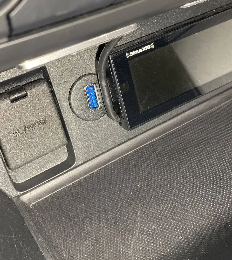

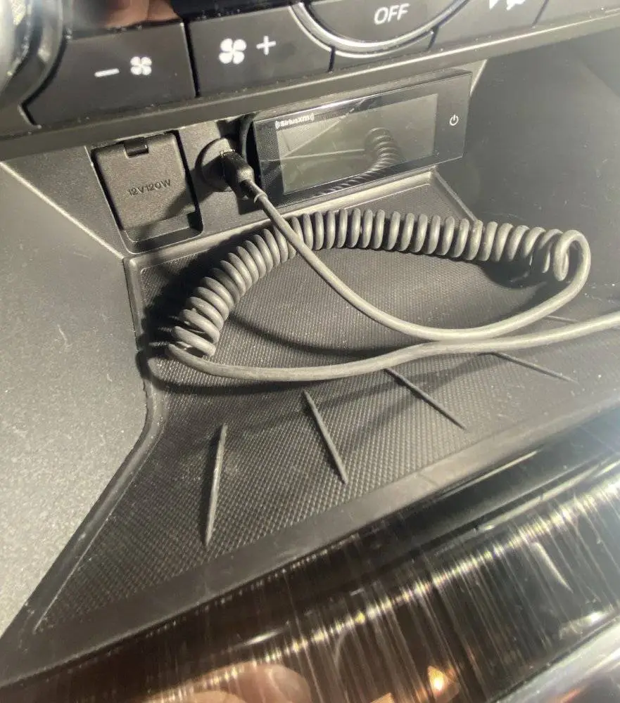

I used a USB port extension cable to install mine. I removed all of the console panels/covers to make it easier to see where I was playing the cable. I drilled a hole in the front tray area next to the accessory socket. I also drilled a hole inside the storage area of the center console to access the Carplay specific USB port. I installed the input/female end of the USB port first. After that, I routed the cable through the center console area under the shift lever, commander knob, etc. all the way to center console storage compartment. I used a little black tape to secure the cable inside the storage compartment so it doesn't get in the way or pulled on. Pretty simple, but it eliminates the need for a long cable that gets in the way.
Damn bro ! Thank you so much for your replied ! That's exactly what I wanted to do ! (except that I didn't think about your cable extension ! It looks well made congrats !
