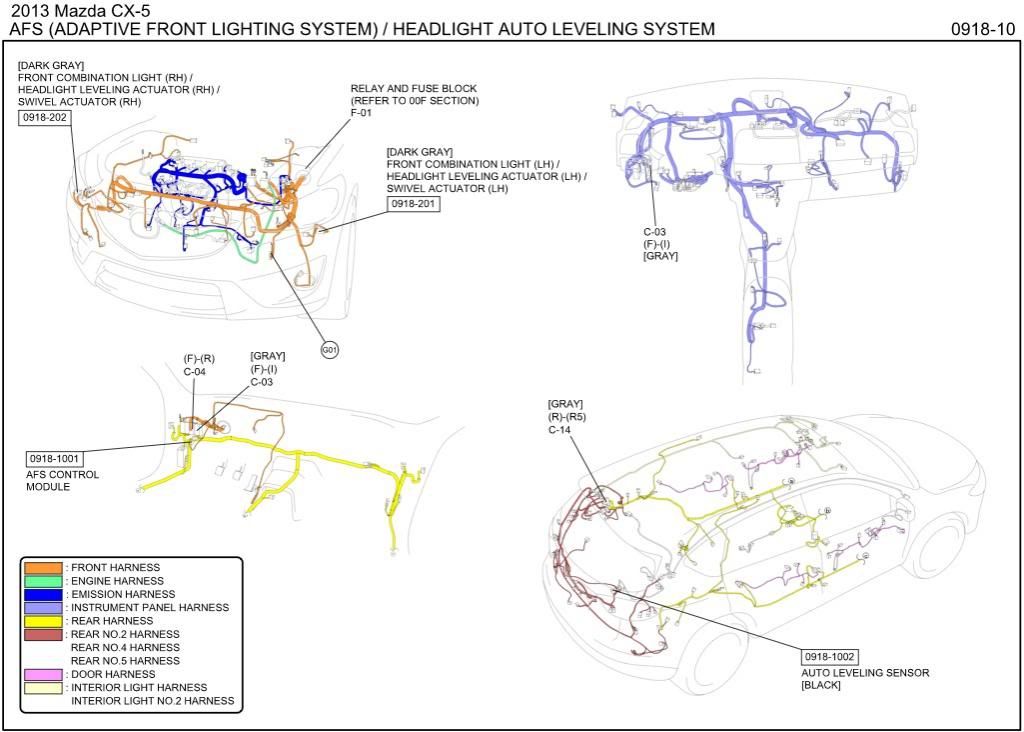

I. here is over-all AFS system description : below show's harness; also indicates AFS Control module just near to Driver Upper/LH footwell (with Grey connector casing)?; HeadLight Swivel and actuator (of course at the headlights ; Auto-Levelling sensor at the rear hatch.

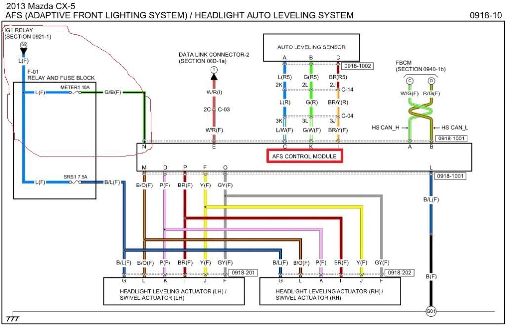

II. AFS / HL Auto Levelling Block Diagram.
show AFS Control Module gets feedback fm. Sensors; then directs actions to LEVELLING & SWIVEL Actuators on the HeadLamps; also show's Fuse/Relay connected to it. with my Suspect Cause #(1) Installer messed up and Electrically Shorted something when he was probing which / where to connect the LED DR Scuff lights....and possibly damaged Fuse/Relay.....
connector numbers and description:
Looks like AFS Ctrl Module : just a big Grey lump, wrapped with Grey Plastic box All showing Connectors

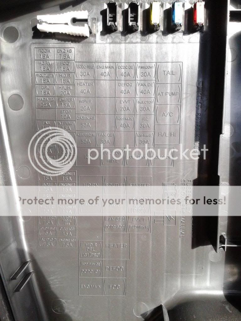

Here is the Engine Bay FuseBox, but couldn't trace which is the one connected to AFS?
{ANYONE HELP Identify w/c one???}

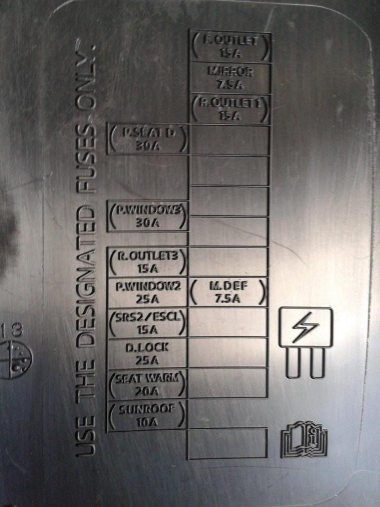

Driver Footwell: Fuse Box (AFS NOT IN HERE!)
According to the diagram you posted, there are two fuses to check, both in engine bay. SRS1 (7.5 amp) and Meter1 (10 amp)
