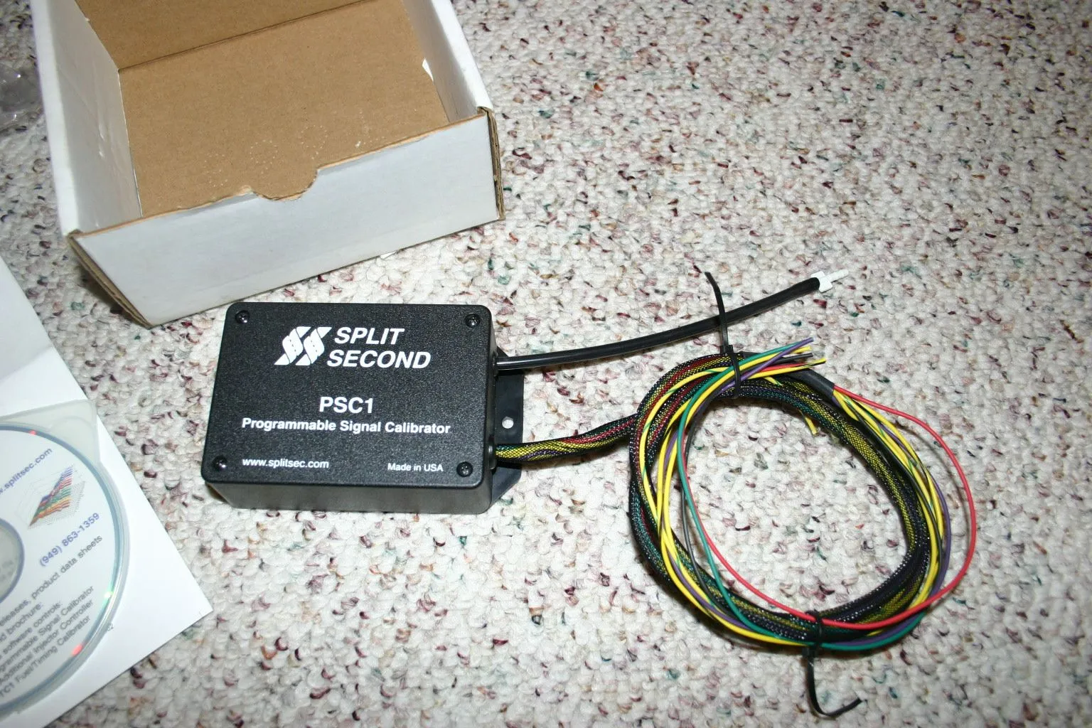

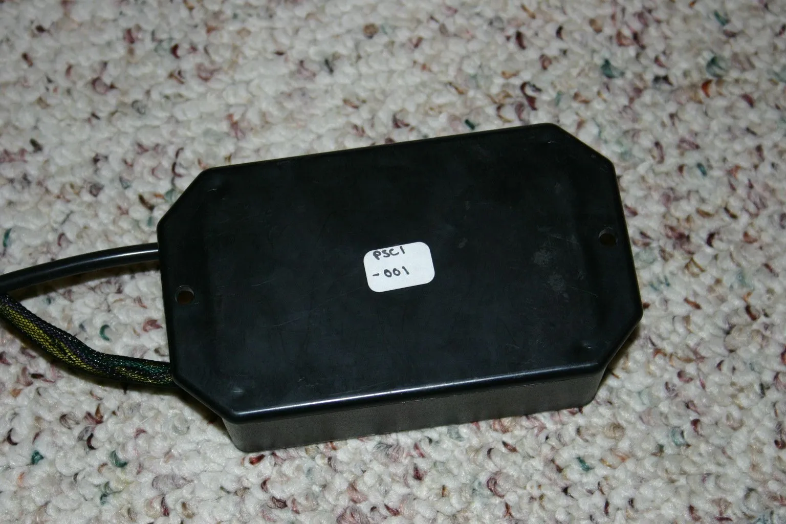

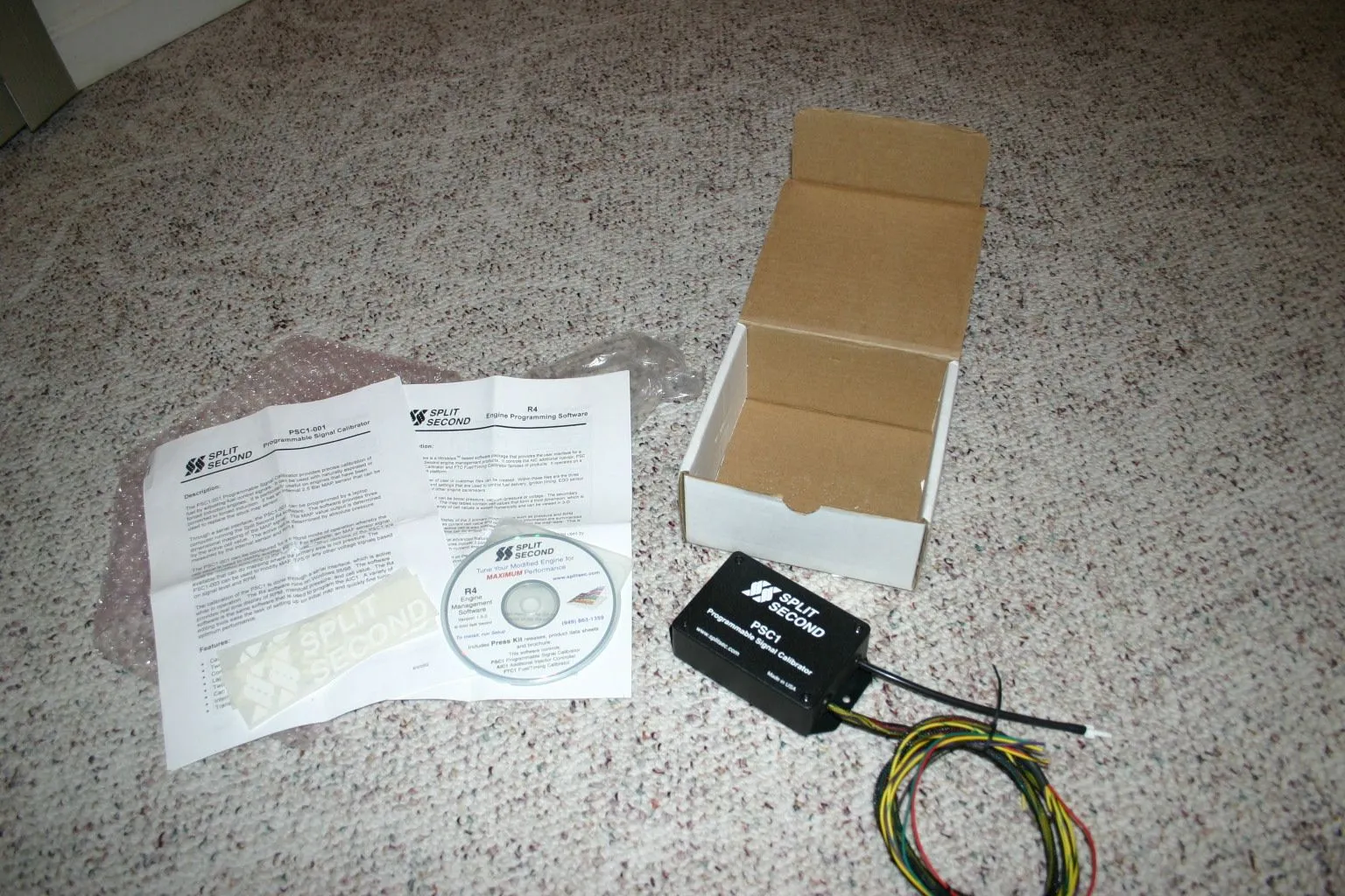

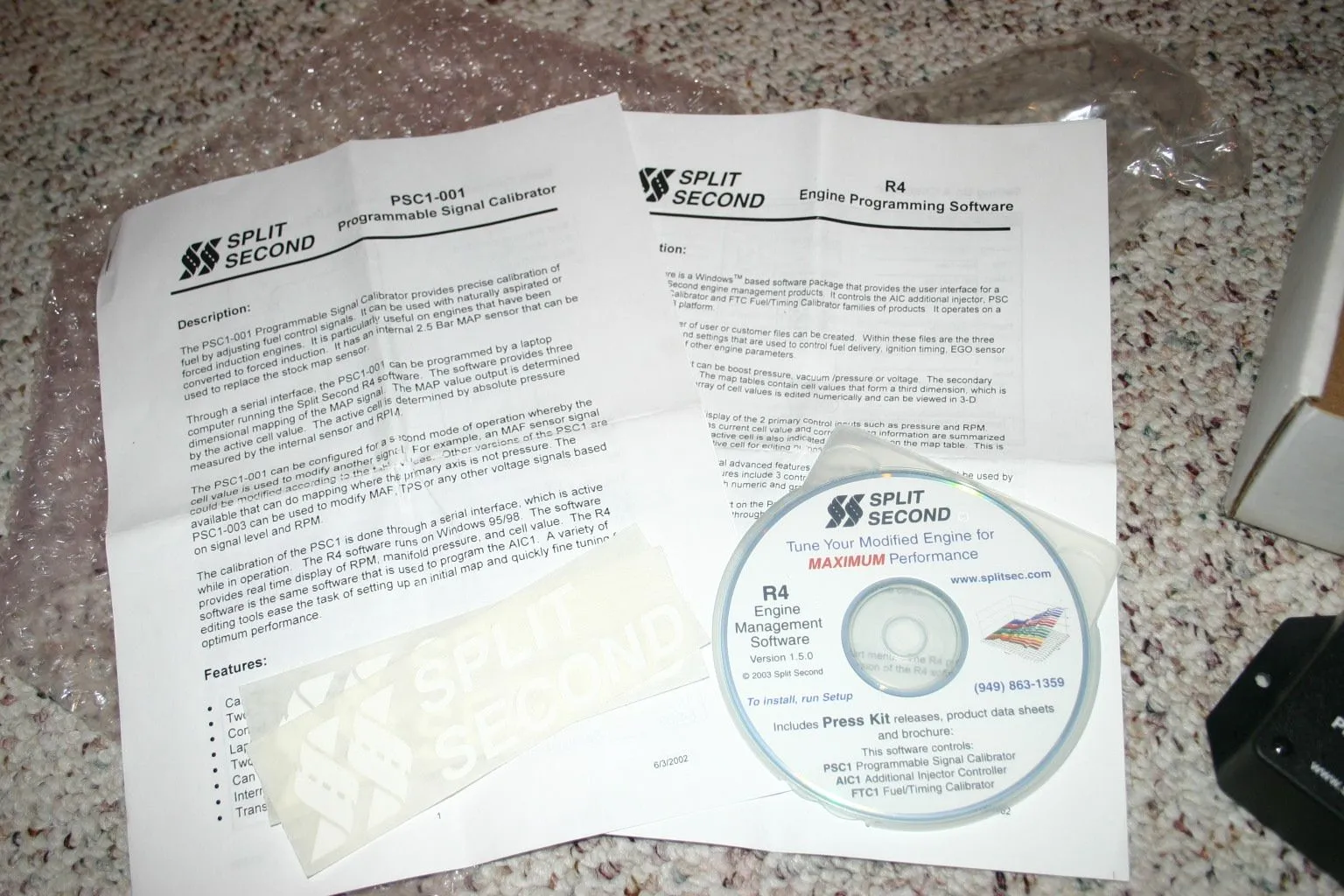

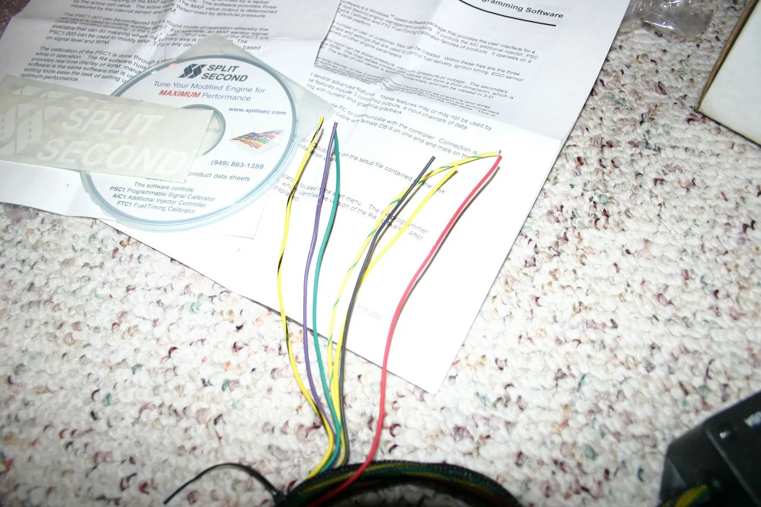

Here are the pics of the unit I bought. John, could you verify if the unit is programmed/sold by Airflowlogistics?
Thanks,
Dave

nope that is NOT one of our units...wire colors are completely wrong, msp install sheet isn't included, and the box does not have "Airflow Logistics" stamped on it.
It looks I got one the original DSM AFC units....sux that people are trying to scam us here,or just sell the wrong part, with counterfeit ones for the MSP.
