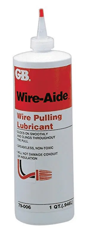

I added one to my 2013 when I upgraded the stereo. And yeah, has to run a wire. It wasn't very hard at all though. Worst part was fishing the wire through the rubber boot. Wire "goo" made it a lot easier.
