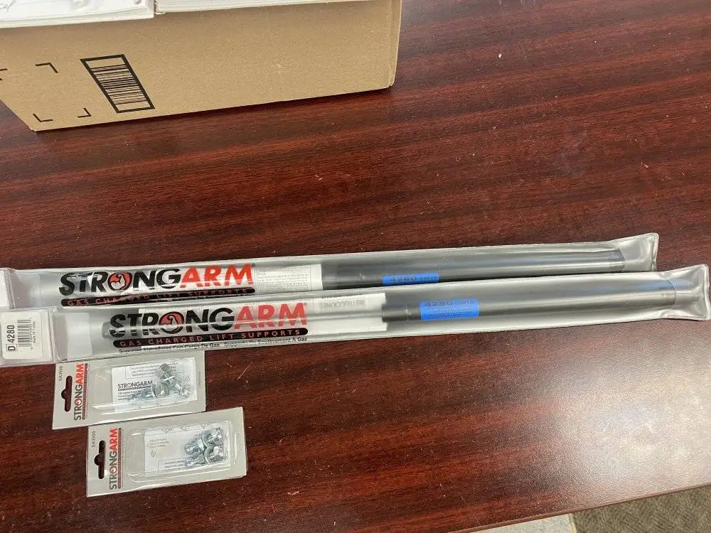

Will do. I have the parts, and just need to make 2 brackets.....

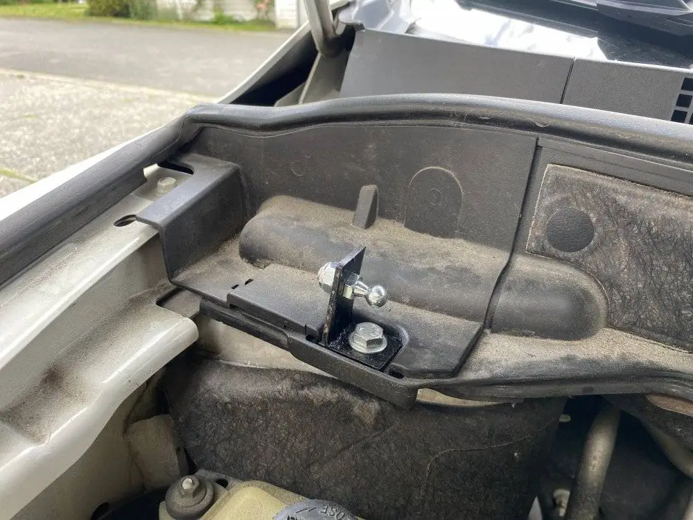

Got it all done last weekend, but upon the first test cycle, it failed. By just threading the ball mount into the push-pin hole in the hood, well, they don't stay put. Too much pressure for a weak attachment point. I have a few ideas but need to find time (and cooler weather) to see if any will work.
Got her done for now. Had to remove one strut as I couldn't close the hood. Will try and find some struts with half the pressure.
